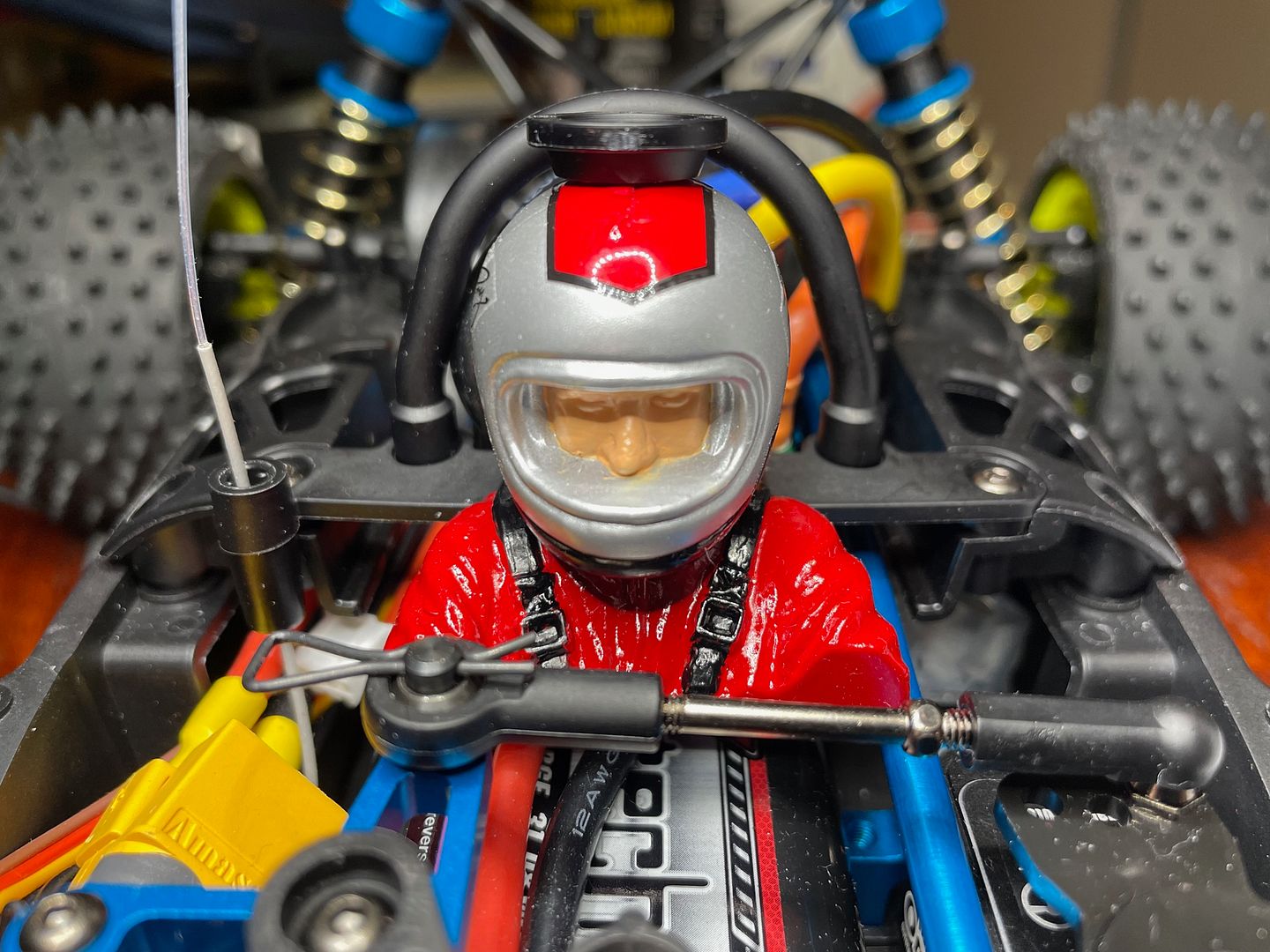

I’ve left the DualLock in but the receiver is now sitting face up. It just fit!
1 hour ago, BloodClod said:.One thing I noted is how severely limited the stock steering setup is with all the steering limiters on the front hubs. I took all the spacers off and currently am running just a screw in there as a limiter. I'm inclined to even remove the screw but I think that would potentially cause problems with the driveshaft popping out.
Yeah I’ve done the same.
Finished my electric install today. Routed the ESC to receiver wire down and round the steering servo mount, across the bottom of the chassis to the receiver and stuck it down with some tape like you do for the steering receiver.
Popped in a battery and found that the wires just get in the way if they are at the front, so routed them to the back. Will be shortening the ESC battery wire soon.
I also used 3M Dual Lock for the receiver but it’s too thick and the steering catches on the top. I might switch the receiver round to clear it or swap the 3M Dual Lock for tape.
Oh and the steering servo still moves even with the hop up mounts. Those 3D printer ones sound the way to go.
