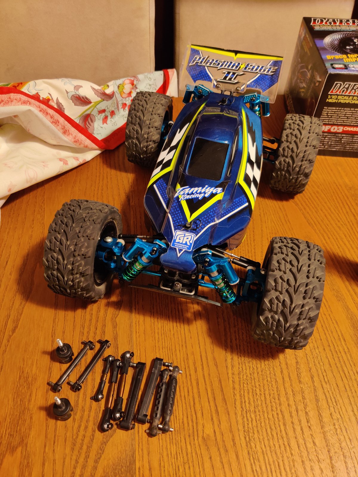

So far my feeling towards these pieces are only positive, I have 4 GF01s and tons of extra accessories. One is built to spec with oil shocks and a sport tuned motor, out of the box there’s a lot of wobble on each of the wheels, lack of toe-in adjustment, self tapping screws work their way out now and again.
The other which is my daily runner is the one with the ‘bling’, Yeah Racing components, shimmed the wobble out of the wheels, free movement of swing arms. Regular fast jumps, a few tumbles, head on collisions with soil banks thinking there was enough of an angle to jump. No bent parts, I’m not worried about things getting scratched, just using it.

Opened the GF01 chassis trying to minimise things taken apart, cleaned all the gears and diffs, added greases and putty that I’ve learnt from being on here;
• Front diff – AW grease & Shimano reel grease.
• Rear – AW grease & TRF diff putty.
• Coated all gears in Ceramic HG and removed rubber shields to the gear bearings.
Thanks for the tips on restricting diff moment, you know who you are.
1
An update on the shocks, so after a bit of a wait the 70mm Yeah Racing shocks came through, tinkered with them finding that they extended too far in the rear and the dogbones would fall out, placed some spacers inside restricting the length. I’m finding this setup nice as they are soft with a lot of movement, having the full movement there has made a difference. Got some Tamiya seals on their way and going to order some nice o-rings too!
