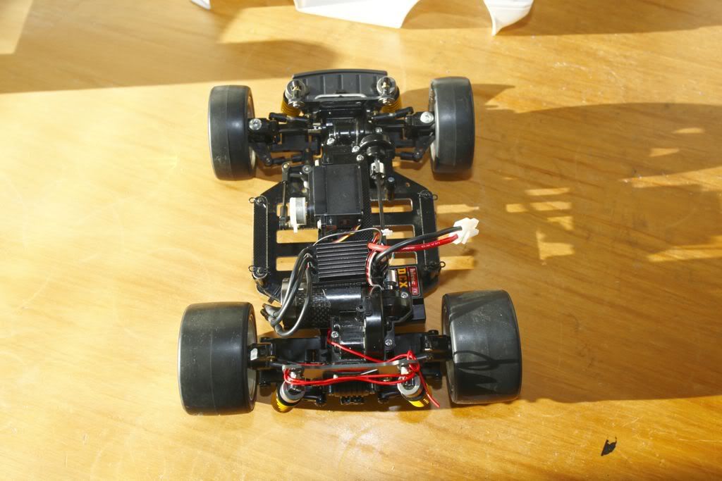

I'm thinking of buying a TA06 Ferrari 599XXX. I'd like to build a high speed car out of it.
What does one need to get a car to go north of 60MPH....besides money?
I've got the radio cover already....I know a brush-less Lipo setup is the way to go. with a 3s battery.
Thoughts welcomed...This will be my first true on road car...
always had Tamiya (except for the Traxxas Wildcat) I'm sticking with a Tamiya car....
I've been planning a similar project, I'd highly suggest getting a TA06 Pro Chassis, and then buy the Ferrari Body, the TRF damper along are worth the extra cost of the TA06 Pro & you get a lot more with the TA06 Pro.
At RCmart a TA06 Ferrari 599XXX (58506) is $219.90 , a TRF Damper Set (42102) is $52.90 for a total of $271.80
Where as a TA06 Pro Chassis (58492) $235.90 and a Ferrari 599XXX Body Set (51474) $31.90 only comes to $267.80
The stock chassis tub has fair amount of flex at the front, that can mess with the belt tension, the cheap fix is the Carbon reinforced chassis tub (54316), but if you want to go all out a save weight at the same time, get the Exotek TA06 Carbon Chassis Conversion (EXO1167).

The Robins Racing pinions I ordered came the other day, so I've changed the gearing from the stock Hummer ration of 11.27:1 to 7.31:1 with a 23T pinion & 69T Spur. The RR Steel pinions are great, but only Americians would use an Imperial sized grub screw on a Metric Pinion.
Took it out for it first run last night, it was fast but total uncontrollable, it would spinout as soon as you tried to turn at speed or dared to break. Did so many pirouette it threw the battery out of the chassis, we couldn't find the battery tie down or the body pins that we holding it in place. (Battery is currently zip tied in.)
I fitted a ball diff to the rear to try and control the wheel spin. (I've got another on order for the front) Took the negative camber out of the back wheels to try and plant the rear more. Also change the routing of the radio gear wiring, as I had a lot range and interference issue with it last night.
Ran it again today way more controllable, but still twitchy as badword, but the wheel base is so short there that's always going to be an issue. I think with some more pratice and a few more chassis tweaks, I'll be about to get it under control without make it boring to run.
Anyway my mate to a quick video me running it with his cellphone (thus the quality isn't that great), but you get the idea. (I think I was doing better that the learner driver in the back ground)

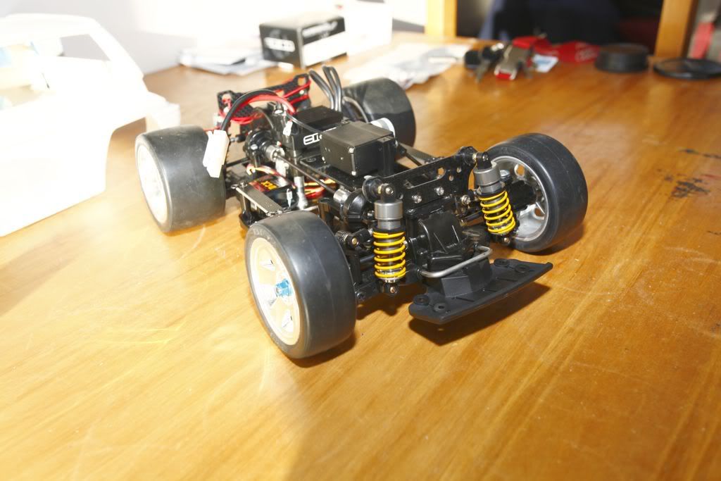

After almost 2 years of sitting on a shelf collecting dust this project is back on and near completion finally.
So since I last update this thread, the chassis, has gained:
GPM front & rear carbon fiber damper stays.
Team Orion 19t experience 2 Brushless Combo.
TA04 39mm universal shafts all round, with TB EVO IV 46mm swing shafts up front.
TA04 TRF Dampers.
Hitec Servo & Radio Gear.
Ford Escort RS Cosworth bumper
The carbon fiber damper stays beyond looking cool, gave me more mounting options for the dampers letting adjust the ride hight more & solved the problem of the front damper mount being cracked.
The TRF Dampers, solver my ride high issues, the chassis is now a half inch closer to the ground that it was, which also resulted in the universal shafts being perfectly horizontal at rest.
The drive train with the universals is now super smooth and quite.
Lowering the ride high had another side effect of allow me to fix my steering arm geometry, the steering arms now run parallel to the front lower arms, all but eliminating bump steer.
Anyway here so picture of it as at today: (sorry about the quality, setting sun doesn't make for the best lighting angle.)
I plan to mount the body with ABC Hobbies stealth body mounts, I'm just waiting on a set of Porsche Cayenne Body post to arrive to fit them too.
I plan to change the gearing ratio with TA02 Skyline gear set, but I still waiting the robinson racing pinions I ordered.
I can't wait to get it out for a full run, the turning circle is insanely small, should do some great doughnuts.

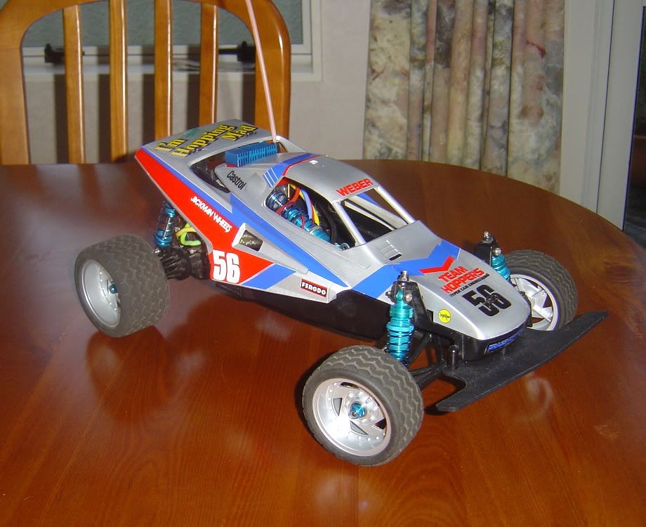

My Grasshopper II sports vintage Proline Strikers mounted on 2" Imex RC10 wheels, rear wheels are fitted with modified adaptors form an HPI 6120 Rear Adapter Set.

Having seen this I plan to mod my Grass Hopper II in a similar way, with a little luck I bet able to retain the stock FX-10 lower shock mounting position.

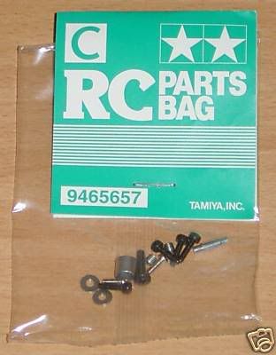

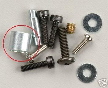

Luck is with me, I found my super hornet instruction manual.
ok so the spacer is part number BL8 from the superhornet kit rod bag, the measurement is 5x5.5mm
problem is, the bag is discontinued from tamiya... there has got to be another bag I can buy from them that has this part in it, since this is a common gearbox
if your spacer measures the same Ill pick it up, but I dont have a grasshopper manual here
The Super Hornet has the same gearbox as a Lunchbox, you'll find the part your after in a Re-release Lunchbox Screw Bag C, Tamiya Part Number: 9465657

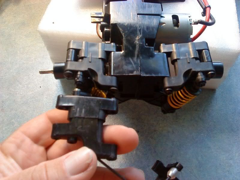

It was done a few weeks ago with DF-03 gearboxes grafted to the Hornet tub front and rear.
It's not actual that complex, you can see from the pictures he's retained DF-03 battery compartment, it's basically a complete DF-03 chassis but the side pods have been removed for the chassis tub.
It look like he then cut the front off and gutted the center of a hornet chassis tub (possible split in down the middle too), and basically slide it over the top of the modified DF-03 chassis.
Moved the servo forward and mounted it on top of the battery compartment and squeeze the rest of the electronics into the remaining space.
The body has just had the nose section cut off and trimmed to fit over the DF-03 front Diff and attached in place, the rest of the body has been trimmed clear the front shock tower and had holes added for the DF-03 front body mounts, but otherwise is basically stock.
It a very cool looking mod and would be relatively simple to replicate, that's not to take anything away from Grahoo achievement, it probably took a fair be of time to work out how it would all fit together, and I'm sure getting the rear of the hornet chassis tub to fit around the DF-03 rear transmission was a lot more work than one might first expect.
