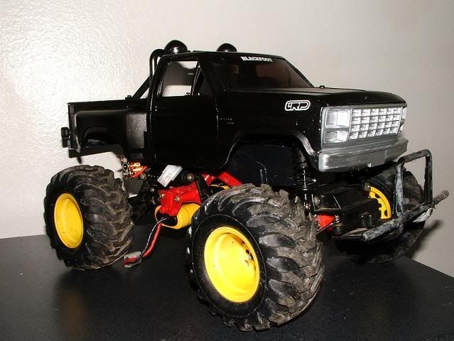

  14. Well it's been over a year since I first posted picture of this project and in that time of replaced more than half the parts on it and learned a badword of a lot in the process. So here are some picture of my Mudblaster today, and a few details for those of you that are interested.
    My latest mod was to convert the steering assembly to that of a King Blackfoot, thus eliminating the asymmetric stock steering setup, I had to make custom 60mm steering rods to suit the new setup.
    I've done a lot of work on the chassis to try and eliminate the weaknesses it has in it's stock form.
    The Mods so fare are:
    CHASSIS:
    - JG heavy duty front bumper.
    - King Blackfoot SD8 rubber bushings.
    - CRP bushed front arms.
    - CRP heavy duty uprights.
    - Trinity aluminum oil filled front shocks.
    - Lowered front body mount.
    - Full length front skid plate.
    - Parma aluminum side nerf bars.
    - King Blackfoot servo saver assembly.
    - King Blackfoot servo cover.
    - Modified King Blackfoot MSC mount.
    - Trinity aluminum oil filled rear shocks.
    - CRP battery door Clip.
    - Lowered rear body mounts.
    - Frog aluminum swing arm supports.
    - Parma aluminum swing arm central support.
    - CRP adjustable motor mount.
    - Re-release Frog 19t Pinon.
    - Frog 49t spur gear.
    - Frog brass counter gear.
    - Fully ball raced.
    - Re-release drive cups w/ Oldfrogshot screw mod.
    - 2005 Frog Universal Axles.
    - CRP differential bearing supports.
    - Parma rear sway bar.
    - Motor Heatsink.
    - Monster Beetle gold wheel rims.
    - Unknown brand low profile diamond treaded tires.

    Here's a picture of the custom 7 Cell 8.4v 3700mah NiHm hump battery.
    The body is a Re-issue set with an orginal vintage roll bar. I also have a NIB Parma Lexan Mudblaster body.

    I'm basically happy with it now. I'd love to find out who made/makes the tires and get a spear set. And I really need to learn to paint a lot better before I try and paint the hard body.

  15. We'll this is a project that's been a long time in the works, due to missing parts, broken radio gear, a broken shoulder and a few other things, but I'm finally seeing the light at the end of the tunnel and hopefully this time it's not an oncoming car :)
    But anyway onto the details, basically it's a re-release Lunchbox body mounted on a PTI Goliath chassis, with a few minor mods, powered by a Kyosho Magnetic Mayhem Motor.
    I've worked out a mounting plate for the body, that allows me to mount the body un-modified onto the chassis without having to modify it either. I'm just waiting on some aluminum tube & bolts to finish mounting the body properly. The tube will be cut to make four spacers, and the bolts will pass though the body mounting plate, down the center of the spacers and bolt directly into existing holes in the chassis.
    Here are some picture of my progress, and a reason why there should be a law against some people using spray paint.
