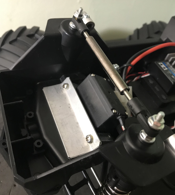

I wonder if you can cut up a 2mm aluminum plate and fix that... (I like ghetto fixes)
Servo saver should help a lot. I think of it as putting a rubber pad between servo and the chassis. Obviously, it's not that. It's a spring between the tie rods and the servo itself.  But the end result should be similar; the force from the ground is absorbed by the C-springs.
And I would definitely check what @Dakratfink said; see if the servo tries to go too far.  15kg is strong enough to break stuff.
Yes, exactly what I have in mind when I read the initial post... And while at it, shocks brace as well to join the shock towers and reinforce the chassis.
I use a 3 kg plastic servo in my lunchbox, and it's actually largely enough for it with the standard servo saver, with probably less risk for the chassis. A metal plate to reinforce the chassis and servo attachement is a must with a high torque servo saver and a bigger torque servo...

The company I bought this second pumpkin from are still selling with 15kg servos as standard which from what you're all saving does seem crazy especially if you've had good service from a 3/4kg servo.  I love the metal plate upgrade, looks a great solution!  I have a new chassis on its way.
