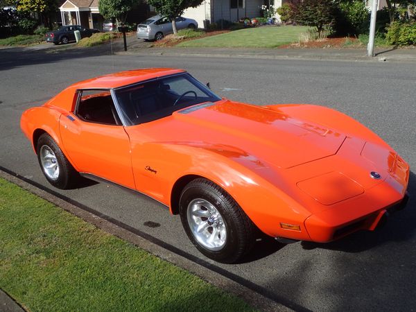

markbt73 5316 Posted November 19, 2021 Test-fitting the engine before paint... (And yes, I'll trim down the body posts, don't worry.) Going driver-less for now, with clear windows, until I figure out what to do. It'll still look pretty cool even like that. Color is an easy choice; in my mind, there is only one color for a mid-70s Vette... 7 Share this post Link to post Share on other sites
