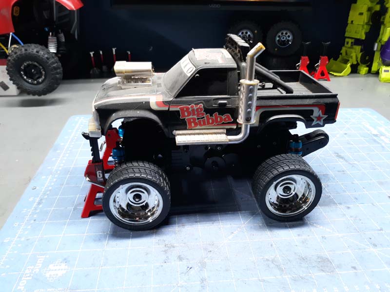

Initially, I was going to go with this old Nikko Big Bubba body... fit the WB perfectly and just looked great! I carved a bit out of the bed and got it down right where I wanted it - however, I forgot about the battery mount, and when I remembered it would have meant cutting out the entire back of the body. I didn't want to do that, so it was back to the drawing board.

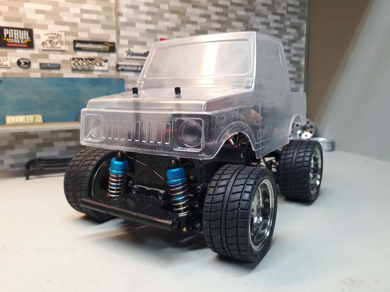

Dug around some more and found this Jimny body. I had picked it up for a 1/2 baked MF01 idea and never used it. Since it came on this chassis, it was a simple matter of adding some body mounts and dropping it on.
I don't like it high in the sky though, might have looked ok with the larger tires but it looked silly with the little ones. I dropped it down a bit though I got severe rubbing up front. Ultimately, I sacrificed the molded in bumpers to get the ride height I wanted.

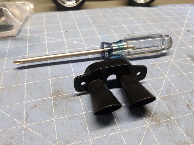

Turning to the chassis, I found almost everything I needed except for the battery door mounts. They are here in the mess somewhere, but I gave up after 30 minutes of sifting through parts. I did find a set of mounts that work perfectly- I believe they are from the Comical series? I picked up some parts trees to get the suspension arms and I must have gotten these too. This is exactly why I never throw anything away! :) I found the exhaust pipes too....I think I can put these to good use.
A bit of cutting, some glue, and a long set of screws and the pipes have been wedded to the old style battery door cover. On a side note, I don't have a JIS screwdriver, but for 30 years I've been using a Craftsman PH2 screwdriver - it's the best one I've found for Tamiya screws.

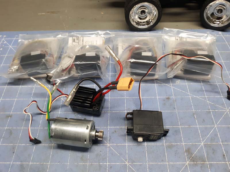

Electronics time! Not every vehicle I dig out with get full electronics...I just don't have enough to go around. I would like to run this one though, so it gets the full suite. I have a few Tamiya ESC's stored up from various kits though for this one I'll use an old 1040 esc and a new Mabuchi silver can. Steering is handled by a Futaba S148 servo entering its 3rd decade of service. Can I just say for a moment that I picked up a bunch of these S148 servos in the late 80's/early 90's and I don't think I've broken a single one. I don't bash my vehicles hard per-se, but I certainly drive them (especially when I was younger) and the fact that these servos are still going strong is frankly amazing.
and this is as far as I got... Comical Jimny? :) I love it!

Would the Nikko body fit better on the Monster Beetle chassis with those long arms and big tires?
Love seeing Big Bubbas resurrected :D
I suppose it would! Both chassis have the same WB, though the 4wd version has super wide body mounts out back for some reason... Hmmm.
