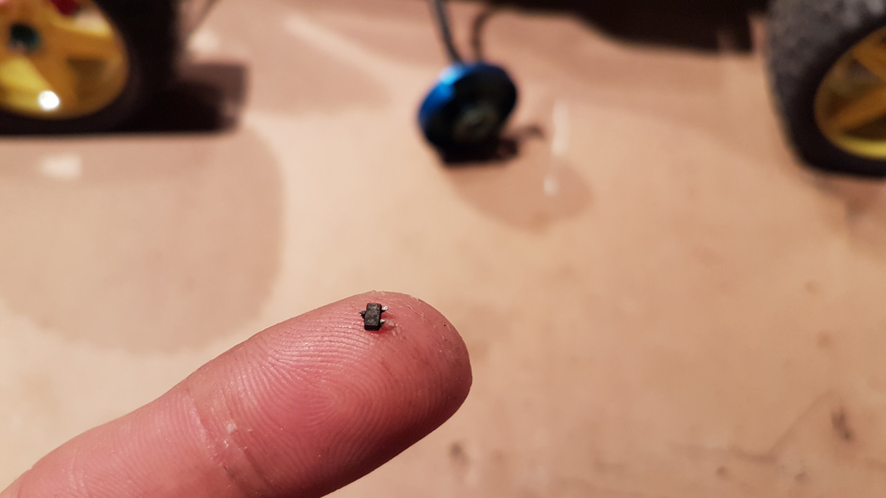

I had a feeling the issue could be in the motor. Took a deep breath and started taking apart a BL can for the first time. Soon after getting an idea of what was what, I found out that a miniscule resistor had fallen apart.
In the following pic you can see that the upper round board has two resistors, and one is missing
Here it is... this also was a first, as I've never soldered anything this small
Happy that I've succeeded, but most of all happy I've found the cause of the problem!!
Thanks a lot mate for the help anyway
Now it's fixed 🤪
