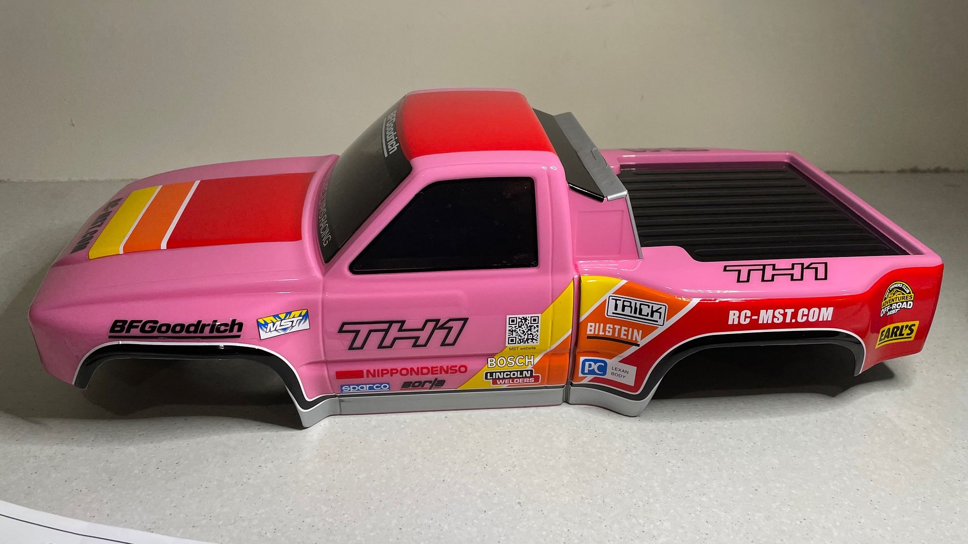

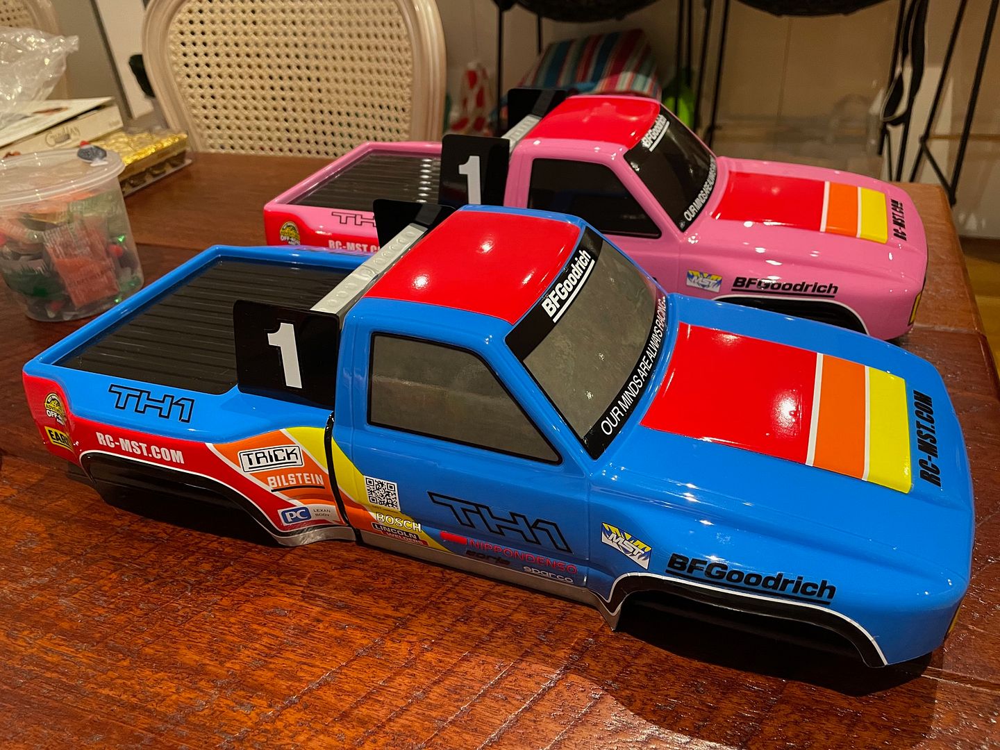

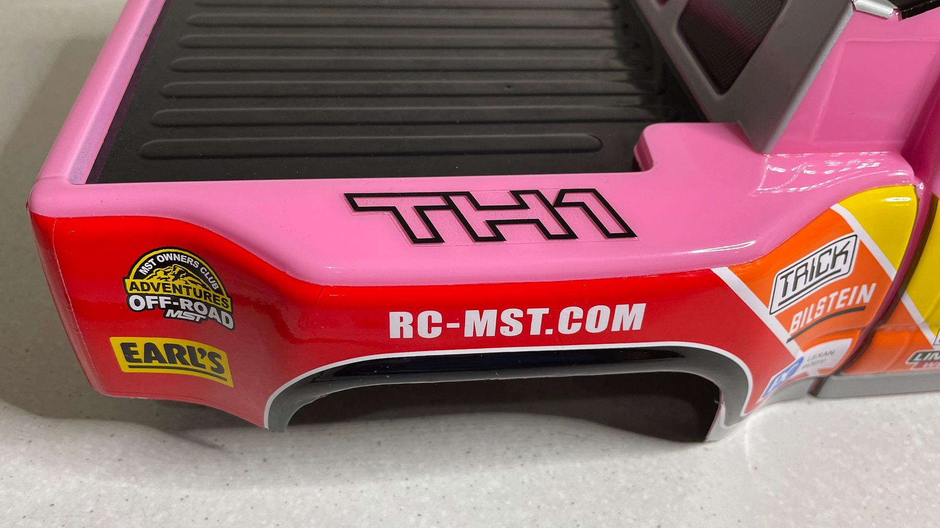

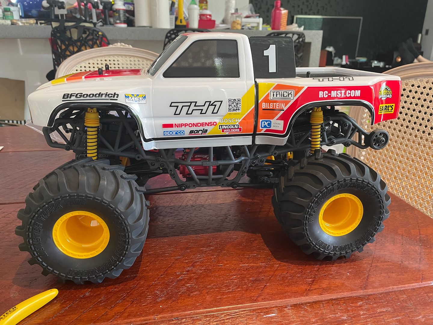

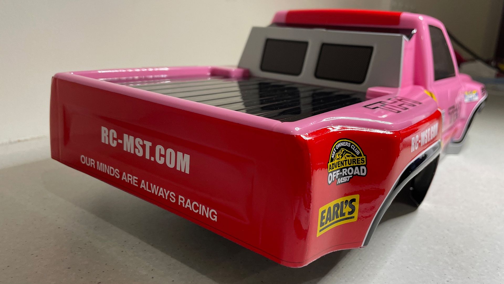

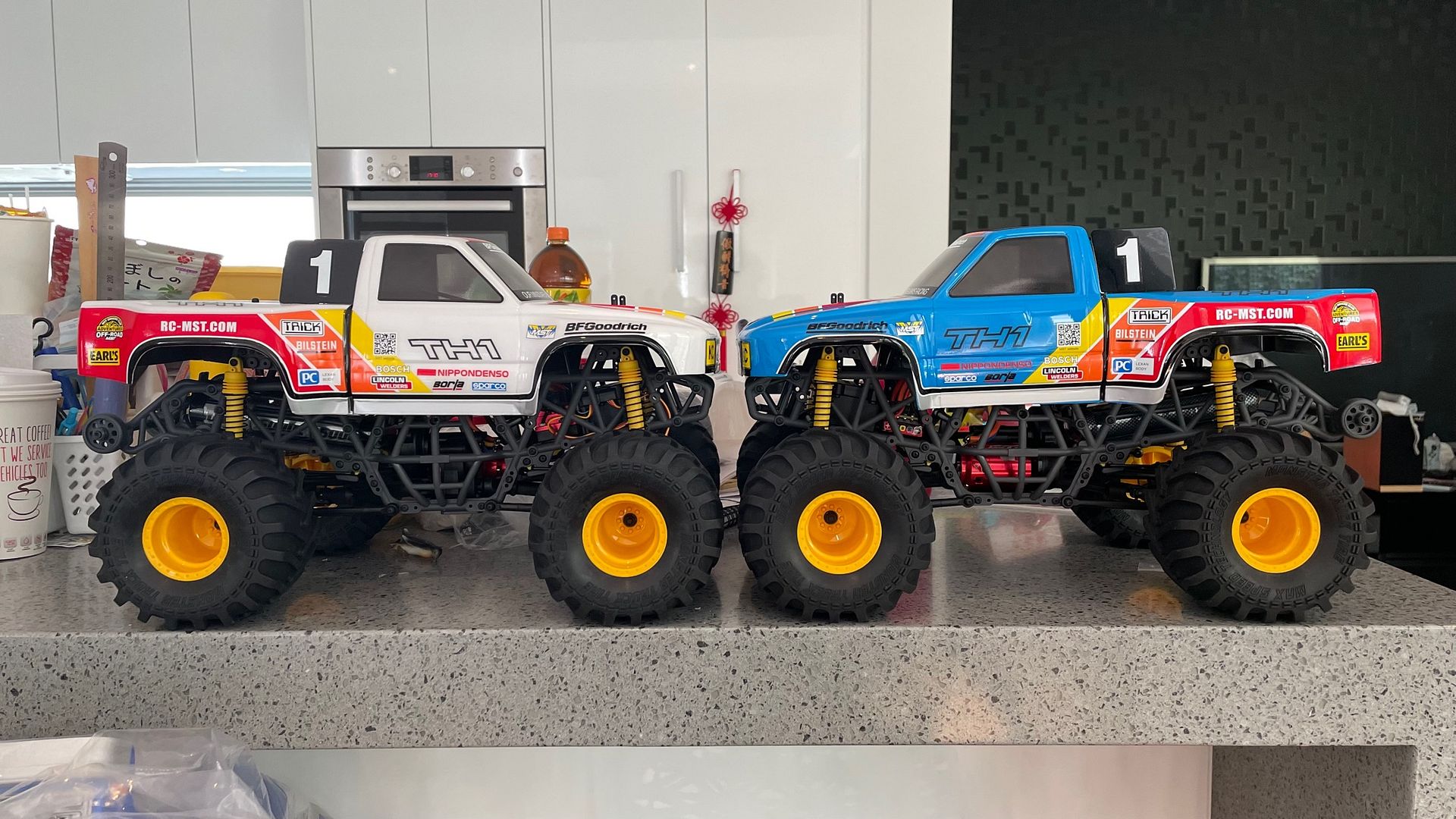

joeling 1649 Posted January 13, 2022 Apparently, this kit has been discontinued. Over the course of the last month, acquired 5 in succession. Since it is school holidays in this part of the world, I saw this as a good opportunity for a group build with my 2 daughters. Ended up, some of their friends also joined. Took the whole day from 9am to 9pm but by the end it, we have 3 working trucks. Prior to the build, I painted the pink & blue with the intention to keep the factory finished white for myself. In the end, my girls took the blue & white while daddy is left with the pink. The large stickers are not easy. I failed in my previous attempt but decided to try the wet application method. I would say I managed to level up on the sticker application department as a result. 4 Share this post Link to post Share on other sites

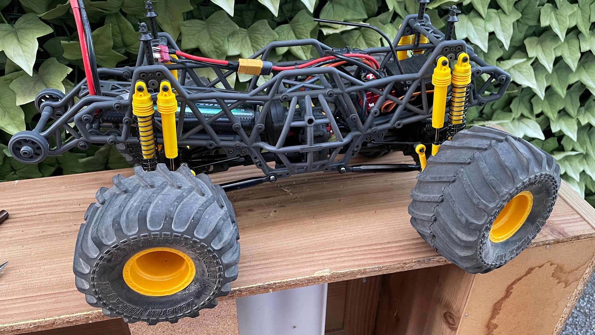

joeling 1649 Posted January 13, 2022 4 hours ago, Killajb said: Both look very nice!!! How do they run (and have you tried the single vs dual shock on each corner to compare)? The kit came very inadequate qty of shock fluid. So, I had only enough to barely make 4 shocks. With Lipo battery, suspension seemed plush. Steering response only so so even though I have installed racing servo (Power HD B5) on one of them and JX 32kg/high speed servo on the other. Searched the whole of Australia but could only find 20wt shock fluid. So with 4 of 10wt & 4 of 20wt shocks - steering more responsive but more bouncy not as plush. I think ideally, if all 8 shocks were on 10wt oil, that may be ideal. For some reason, the kit TH1 model came with unglued tires, the chevy like blue body that came prepainted did come with white pre glued wheels. Also the 2WD RTR model did come with pre glued tires. I glued mine. Share this post Link to post Share on other sites

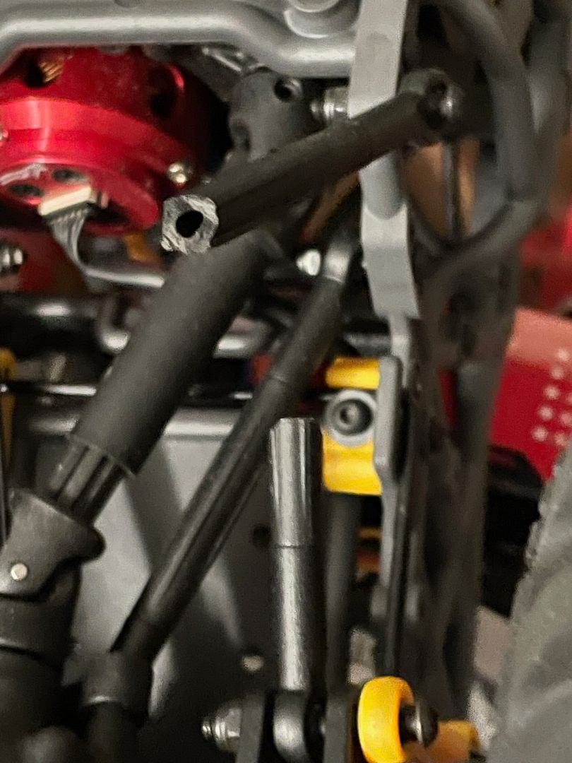

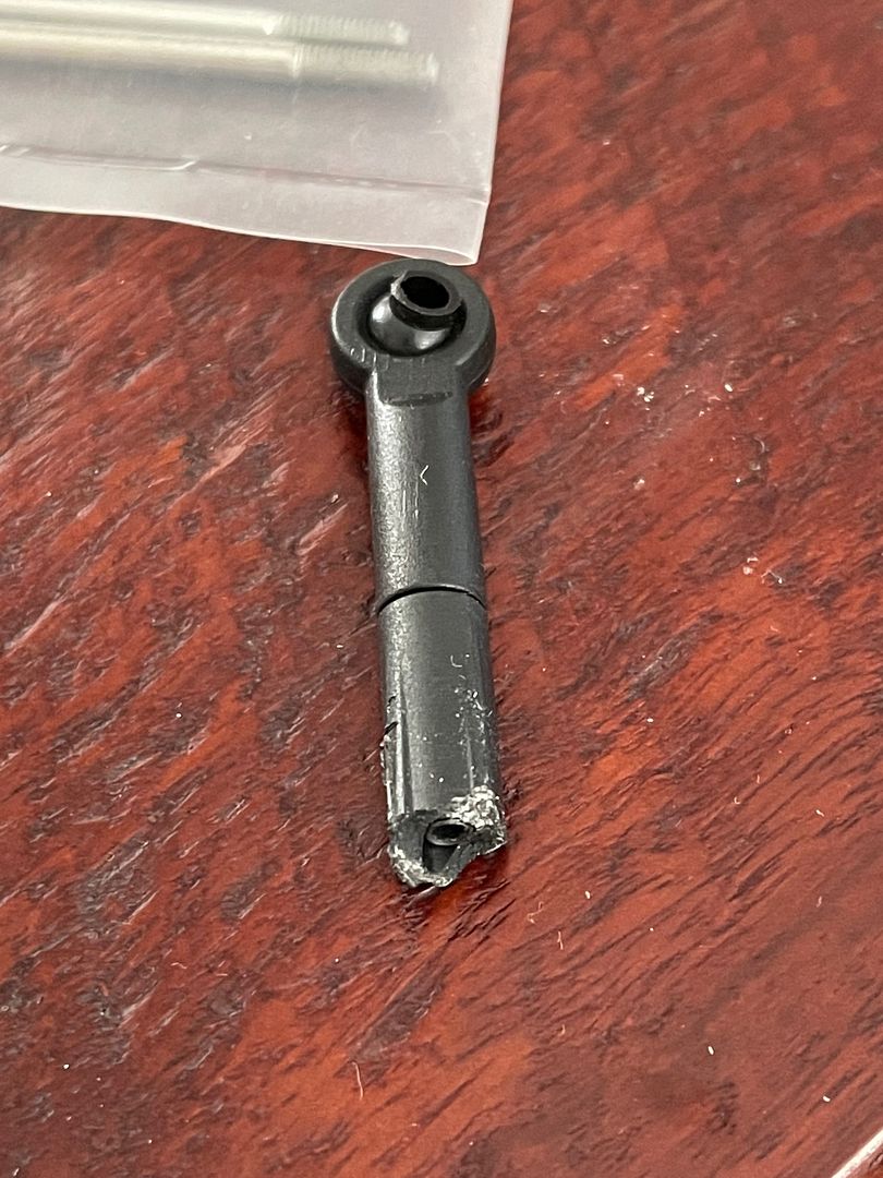

joeling 1649 Posted January 13, 2022 I am running 13.5T Track Star with 25AV pinion with some boost & turbo on the (cannot remember name) esc. Pretty zippy. Other trucks with same motor but with Trackstar 80A Turbo esc missing programming were not so fast. Need to get the program box to program more ommph I used Tamiya Antiwear grease for the diff to simulate a bit of resistance. The plastic 4 links that came with the kit is probably the weakest link My daughter's broke after the first outing 1 Share this post Link to post Share on other sites

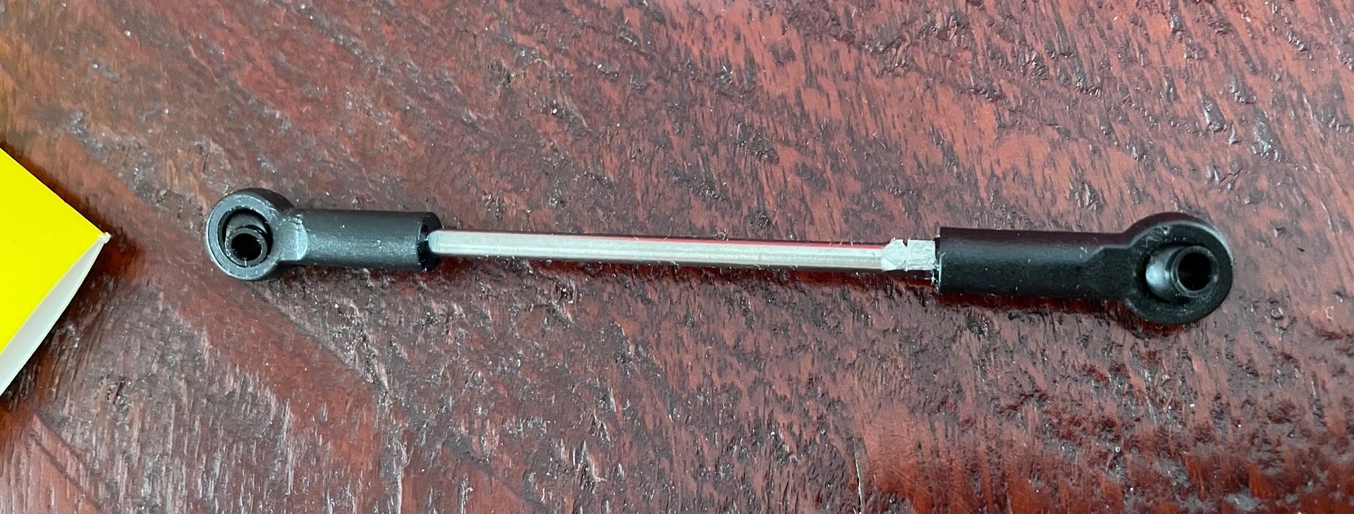

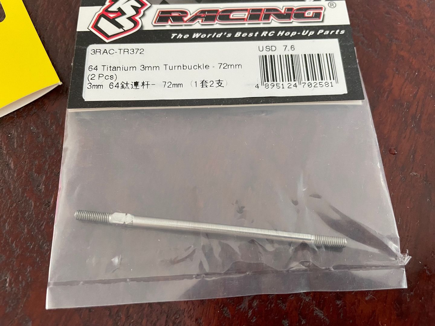

joeling 1649 Posted January 15, 2022 Need to do a run tomorrow, decided to an emergency repair on the broken member while waiting for aluminum links. In hindsight, any 50mm link tube would have worked. Overpaid for the upgrade . center to center appears to be 90mm. Decided to use the spare turnbuckle intended for the modification of the steering to the right side for the TD04 for this purpose : broken bit part to effect the repair Generous amount of locktite. All done waiting to be installed 1 Share this post Link to post Share on other sites
joeling 1649 Posted January 15, 2022 Installed Like a titanium hip replacement on one side 3 Share this post Link to post Share on other sites

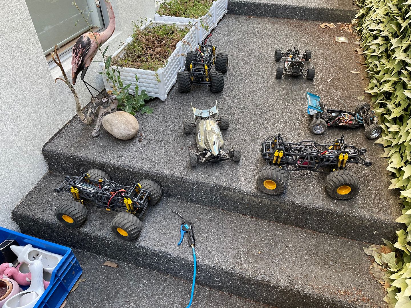

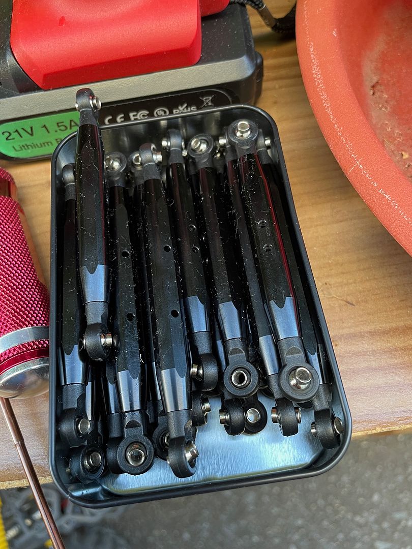

joeling 1649 Posted January 21, 2022 cleaning day Alloy upgrade In progress ll dome All done 3 Share this post Link to post Share on other sites
