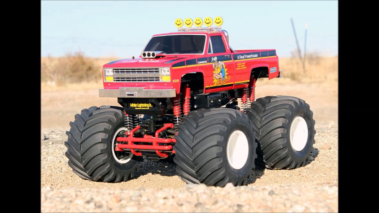

I only have a tight Space at my Frontyard (i do not have a Backyard). So i think my Setup is ok. Sadly it isn`t "legal" for retro Class because of the 7 cell pack and the 25T Motors. Would the anti Sway Bar that i use be legal? it is just a u shaped Wire that prevents rolling because i run a super duper soft oilshock setup and the Body would just wiggle from Side to side without that.
But i See, i have to build more Ramps :D and build a Monstertruck course.....
Also i do not know what to do with my other very unused Clod from the 80s.....   it is quite "not runned", but covered in Dust and Spiderwebs....
I Bought the Super Clodbuster to save the old one. I`m happy with my super Clod (exept the Speed), but there is an urge to get another more modern Truck since i did not catch a local "get" of an Argios for 110 Bucks.....
I didn`got it, now i want it sooo bad.
I´m a big child.....

Love the body, one of my favorites.
I just ordered a Ford Body that reminded me of the Monstertrucks of my childhood. It was a Bigfoot, i think it had stripes on it.
Can you tell me if my Clod reassambles a "real world Monstertruck"? What Bigfoot # would that be? (i didn`t put the Stripes on the hood and the roof, becaus i think they do not look very good - sorry Team Bigfoot :D )
