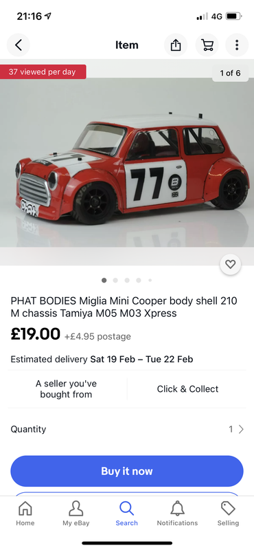

Phat Bodies make a couple of classic Mini options if you want to go SWB with an M05.

Just pulled the trigger on Yaris+ bearings+Super mini CVA's for £114 from fusion. The M07 looked cool but it worked out as almost exactly the same as the M05 without motor, wheels, tyres and a body. Added advantage of the M05 is I could build a Mini if I can find the right body.
