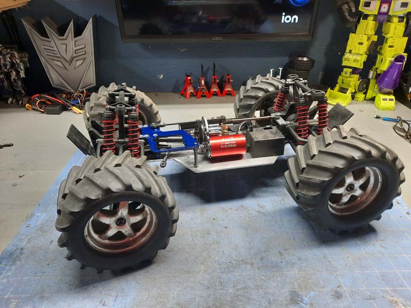

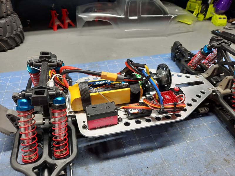

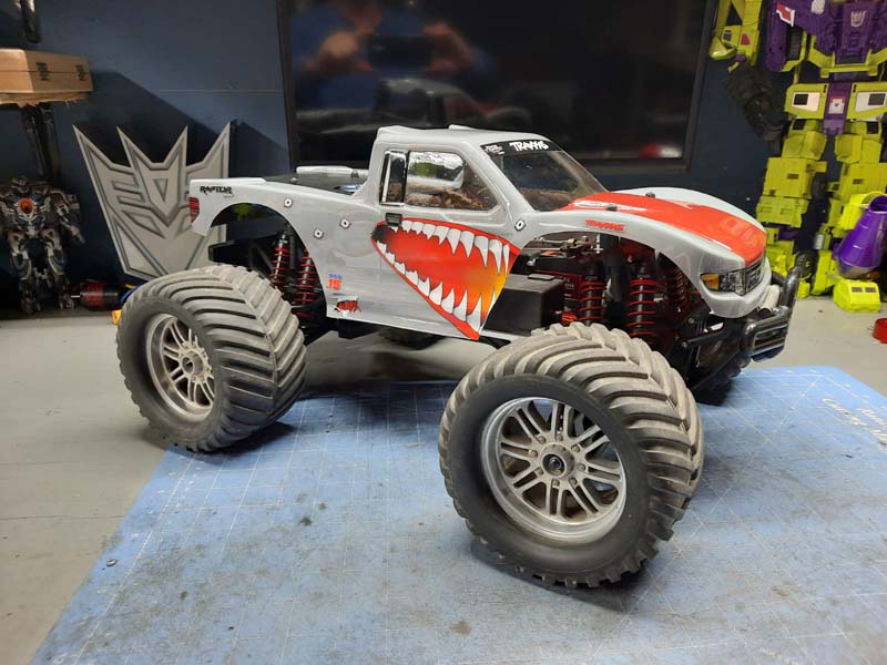

Well, that escalated quickly... Since I wrote that, I've picked up 3 T-maxx's... all for $140 or less each.
One nitro - restored with a few hop ups I've had laying around for nearly 20 years:
One I've converted to a crawler/trail truck. Does a lot better than you might think, and gets a ton of attention out on the trail.
...and a third one I've converted to an LCG electric basher.  Body still TBD.
