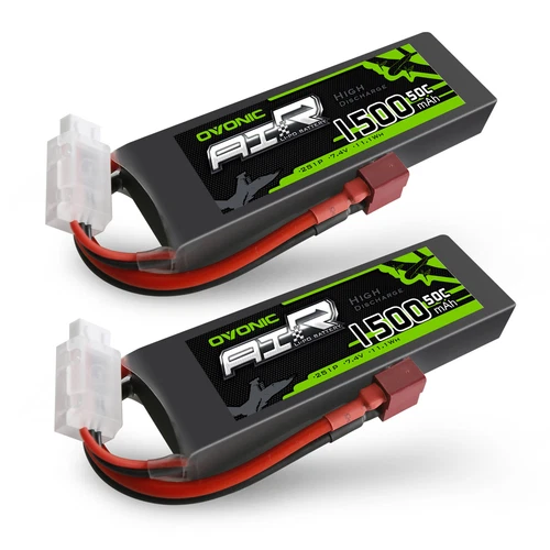

Hi guys, I really enjoyed reading this thread. So well done!
Anyway its an old thread but I just wanted to say that I found a Lipo that fits with Deans connectors, there's hardly any info on batteries that fit this series.
The battery I found is on Ebay Australia Item 186281761404
2x OVONIC 7.4V 50C 2S 1500mAh Lipo Battery with T for RC Car Truck rock crawler
2x OVONIC 7.4V 50C 2S 1500mAh Lipo Battery with T for RC Car Truck rock crawler - Picture 1 of 5
