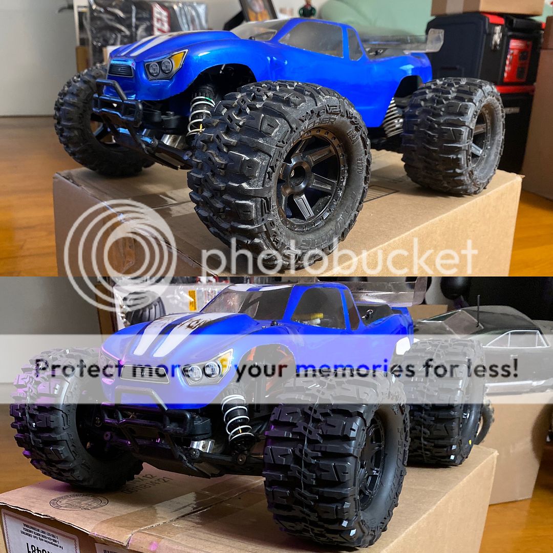

What I did with mine is use the XXL RPM arms in the front with their Slash/Stampede 4x4 rear arms and bearing carriers in the back then rear offset 2.8” Prolines all around as well as put in a SAVOX low profile 125oz/in metal gear servo, which allowed me to put the Rx on top of the servo and it has a now vintage New Era aluminum front bulkhead. I’m also using a the offset pivot balls for the Revo on the tie rods to level those out, which seems to have eliminated much of the bump steer that these things have.
Here’s the tie rod assembly I have on it to better explain the pivot balls, also kinda shows the long arm set up with the front offset Proline wheels all around.
160DF7AA_151F_4C13_84BE_018410FD915C_IMG
then here’s the servo and Rx arrangement
505CD6CE_A300_4848_85C5_9B5962E9D262_CF1
Finally, here’s the width of it with the front offset Proline Trenchers on Desperado wheels vs their pre mounted belted Trenchers on their wheels with the replaceable hex section, using the rear offset parts all around.
7BFF99B4_7758_4C37_AF34_DB3DE25B5BAF_AC9
