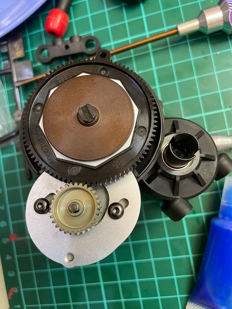

Just started the first build. A couple of things :
1) If one is installing the slipper, the biggest pinion that will fit with the stock Spur is 48P 29T. 30T is too tight. Maybe some filing will enable 30T to fit.
2) The esc plate allows for good sized esc but the shroud covering the esc if low profile. Likely it is made for Tamiya esc specifically. I cannot fit the Skyrc 50A esc if a fan is mounted. One likley position to place the esc is the back of the battery tray. If one uses a shorty Lipo, then this is possible. However, the esc would need to have a remote switch. My other choice, the Skyrc 120A, has the switch on the body of the esc. Access is too difficult. For now, the only other way I can think of is to dispense with the esc shroud and use a piece of polycarbonate (I have 0.5mm sheets) to fashion a shroud that will accommodate the esc. I have not tried this yet. Hopefully, there is not interference with the roll bar pillars.

Looks like you swapped the slipper plates...

Thanks for the catch. Sometimes the brain & hand co-ordination is a little out :huh:

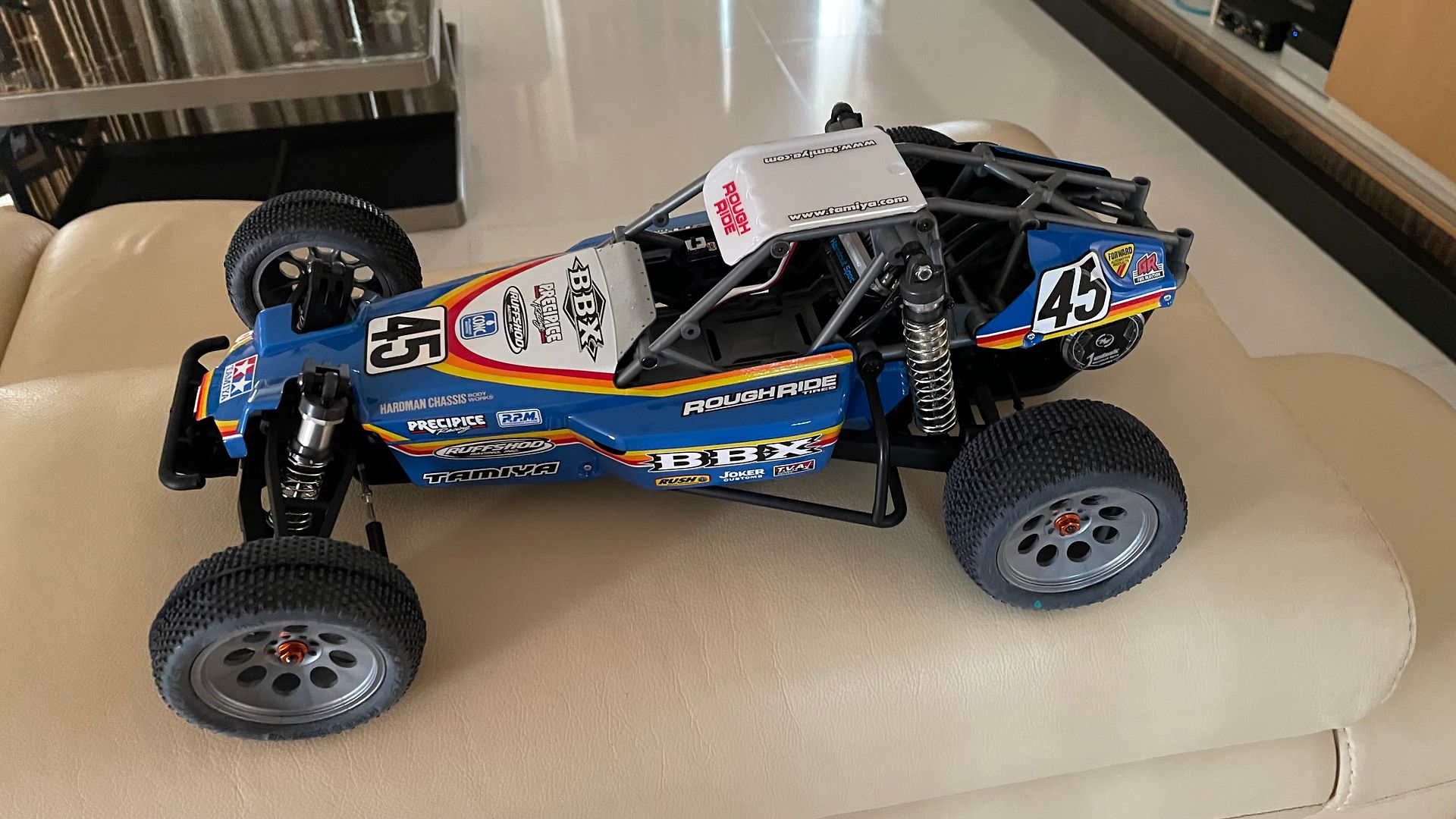

PS30 Brilliant blue seems to looks much better than PS4 blue
This is a handsome kit except for the wheels & tires. The silver JC Optima wheels matches the roll cage nicely.

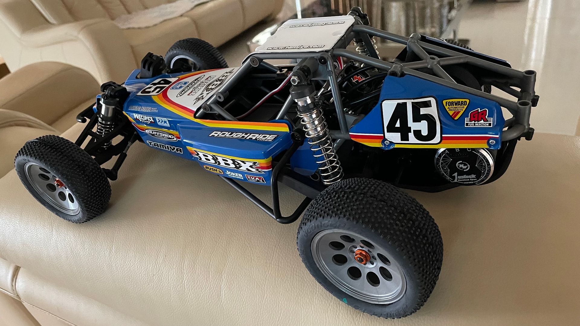

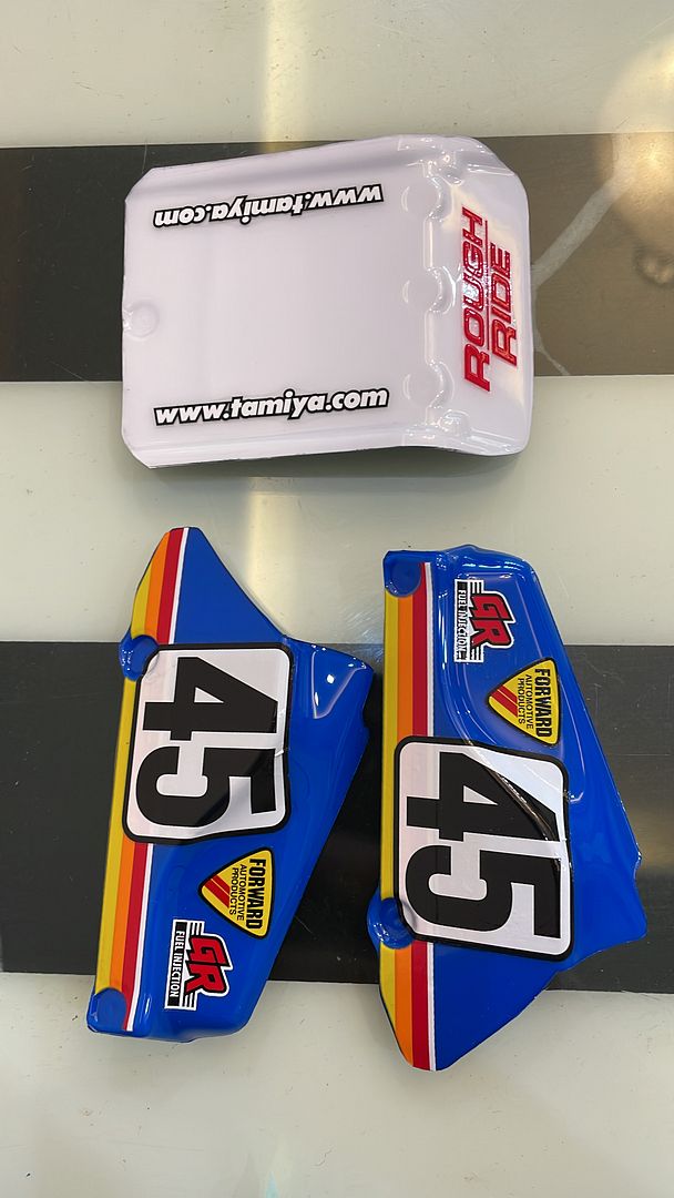

Stickers therapy
Not quite done but it is a handsome buggy. The JC silver Optima wheels complements the roll cage color well.
PS30 Brilliant Blue is a better color choice than box art as many on social media has shown.
  • Like 12

looks fantastic!i agree the wheels look better than the stock

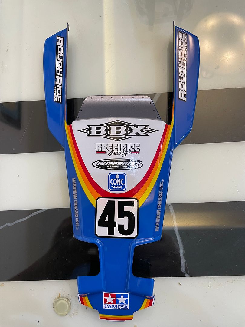

Deviation from boxart. Trying to emulate this color scheme

I agree completely with your color and wheel/tire choices.  Well done sir.
I very much like the stock BBX wheels and tires as well.  It's good that Tamiya has made it so easy to swap them.  There are a lot of smart design features with this new car.
