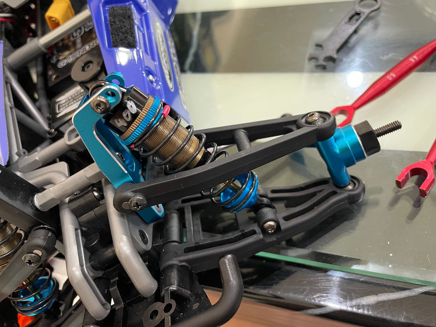

Can now confirm that the aftermarket sway bar kit reduces the tendency to roll over on high traction surfaces.  Using the sway bar kit in addition to adjusting the rear upper links to give more negative camber helps even further.  I made the rear upper link shorter by removing the plastic spacer and replacing with spacers from  OP-539 Aluminum Spacer Set to reduce the length by 2.5mm on each side.   I'd love to add photos but apparently I have reached my photo limit.
