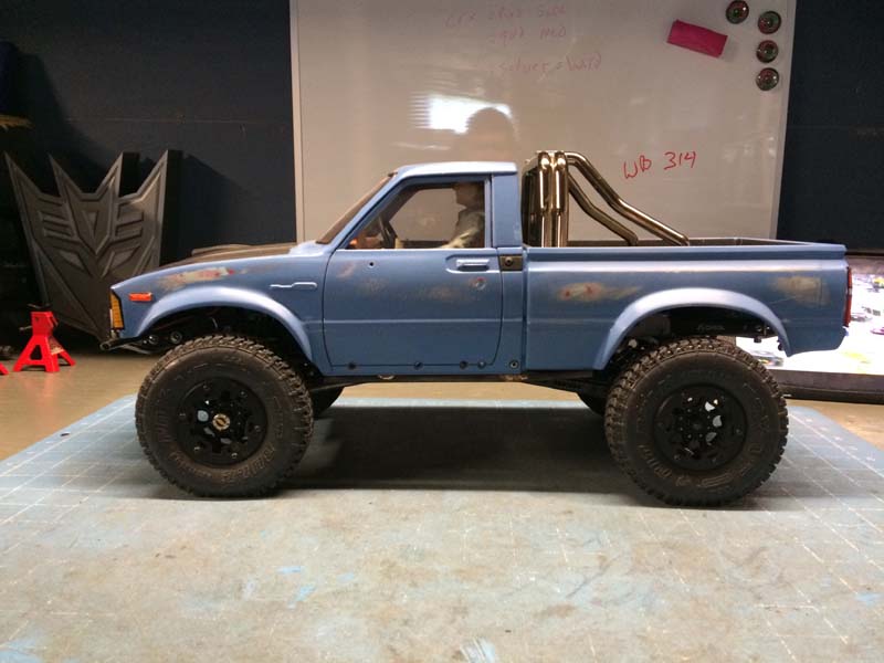

I tried the sharpie but I wasn’t steady enough. Had good luck with super narrow pinstriping tape that they use for airplanes and scale models.  I like the way the Porsche came out, the Camaro used a slighter wider tape and I wasn’t thrilled with it.
One suggestion I'll make is, depending on the subject, use at least 2 different widths of tape. Varying the thickness of panel lines will add some visual interest. (Example: Bumper parting lines slightly smaller than door gaps)
Also, be subtle. These are small scale objects.

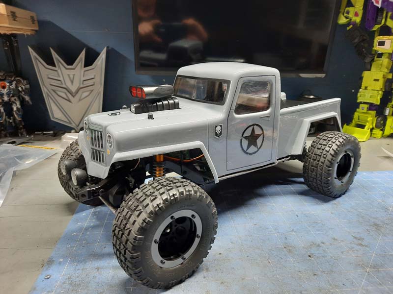

Thanks!  Yep, camel yellow and no backing,  This is camel yellow as well.  Wing is using TS.
