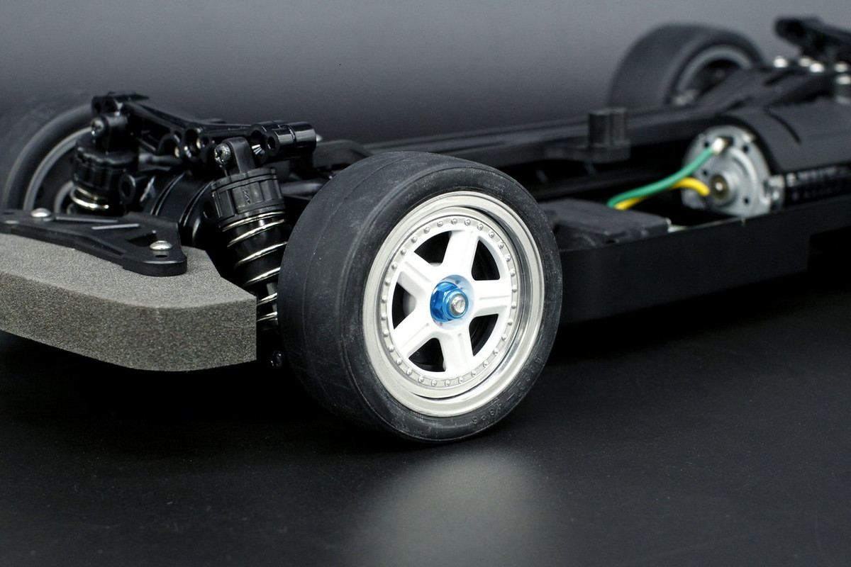

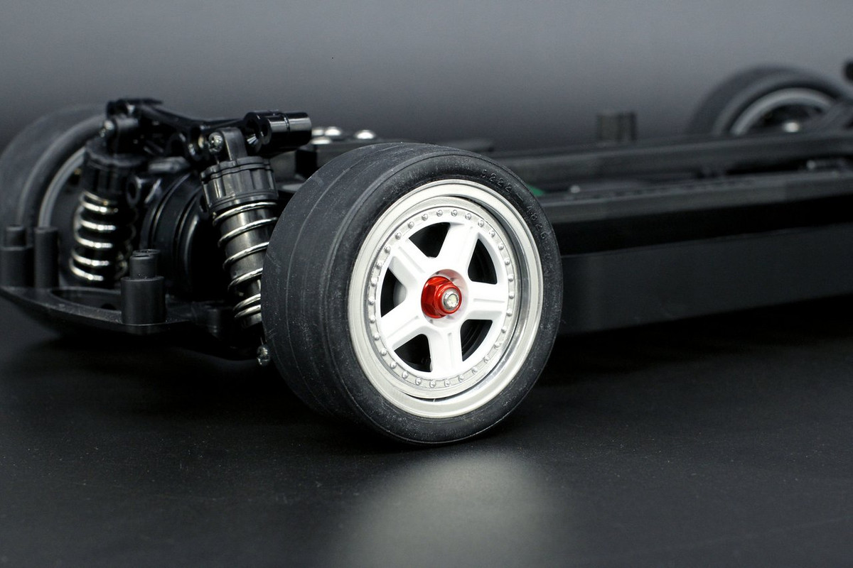

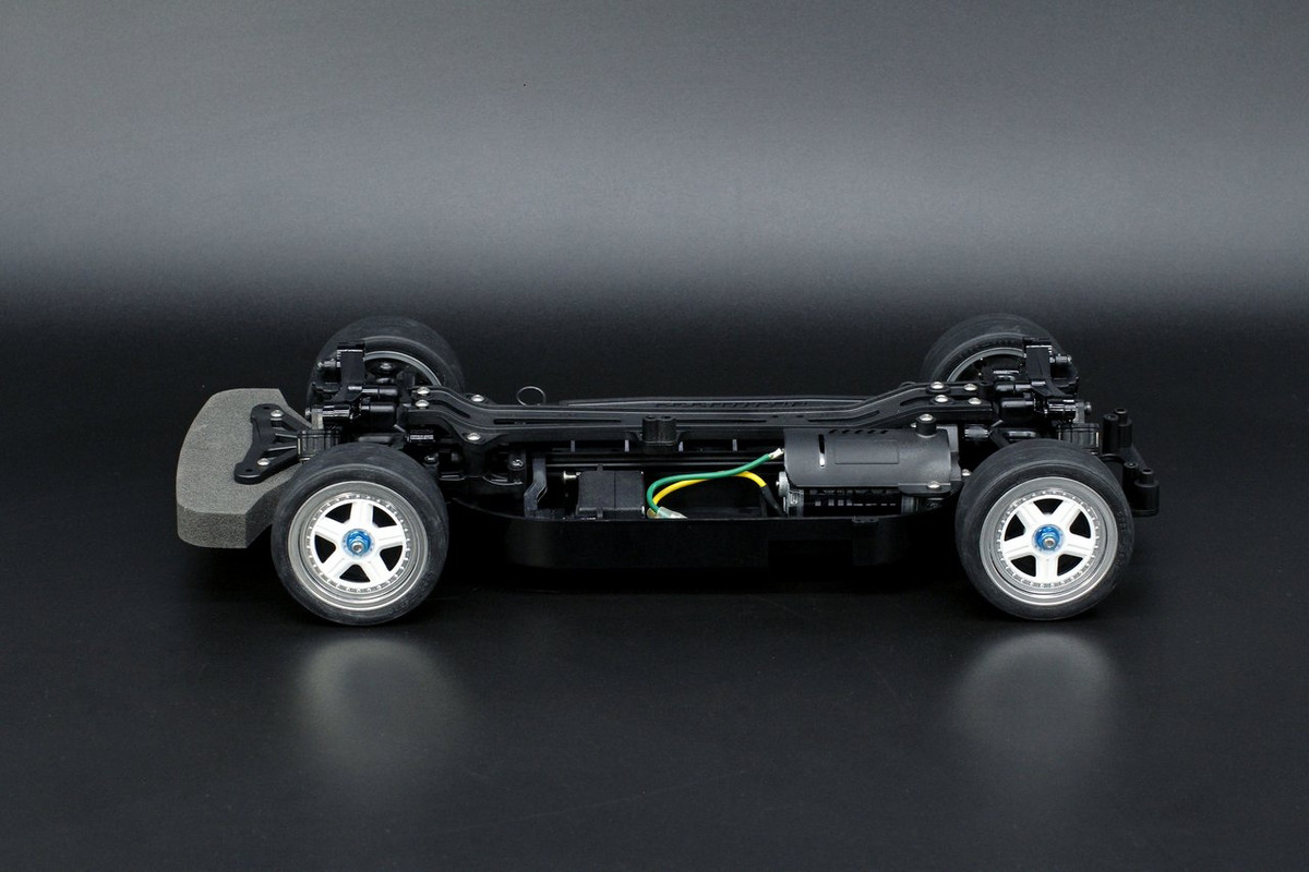

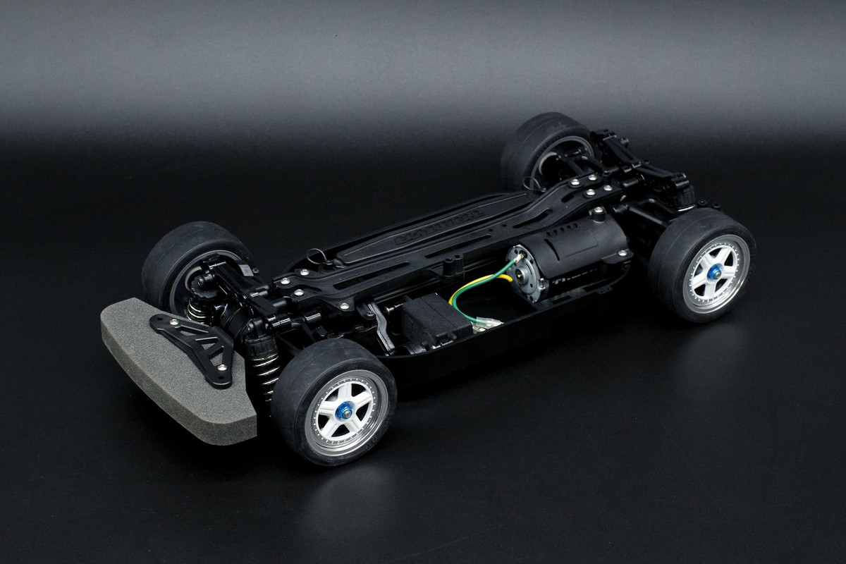

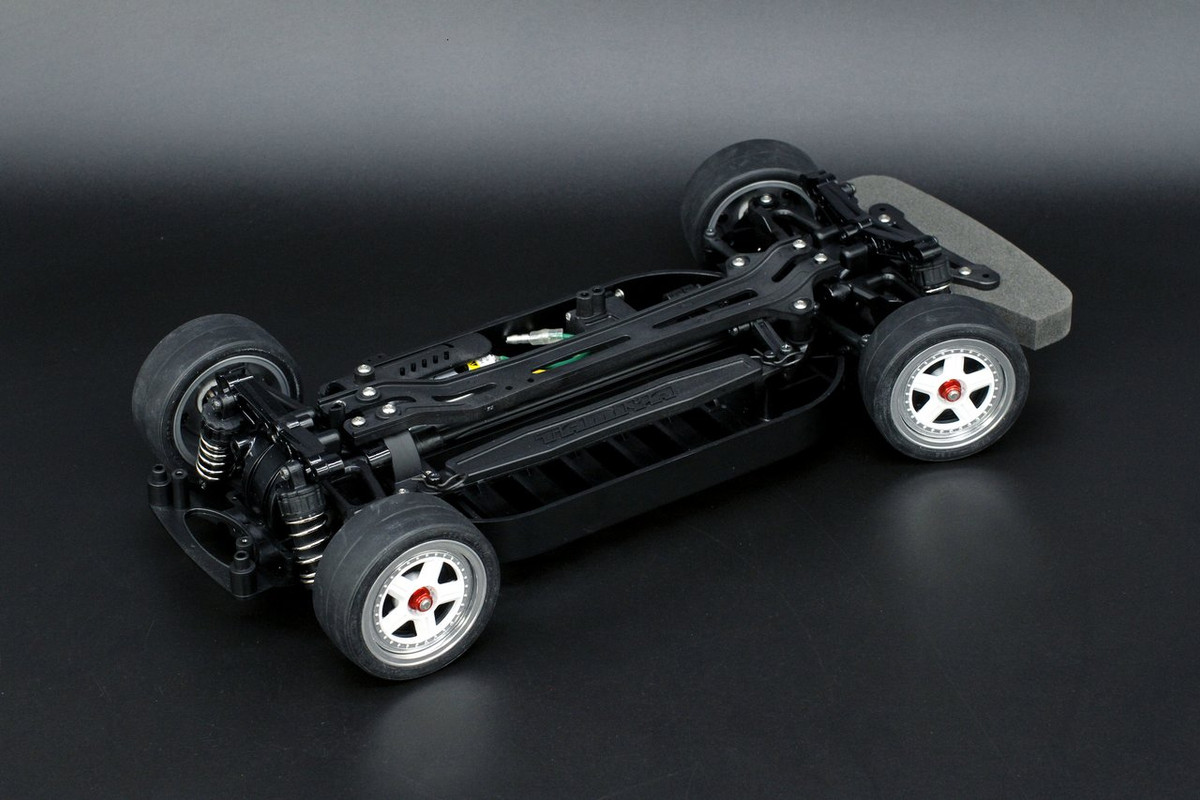

Around christmas I decided to already  build the chassis. I remember the TT01 as being a quick, simple but fun build and this one was the same. I swapped out all the screws for stainless M3 hardware. I build it using the stock plastic bushings but might replace them with bearings eventually. I added some aluminium hexes because I happened to have them laying nearby :lol:
The standard wheels really do not cut it for realism. I have used Molotov chrome paint to paint the rims and the edge of the faces to mimic the real 3 piece look, and painted the centers white to avoid them yellowing over time. The center of the wheel behind the faces is painted in a flat black. Blue/red wheelnuts added too, but I found the real car uses a grey nut instead of blue so I might swap them later on.

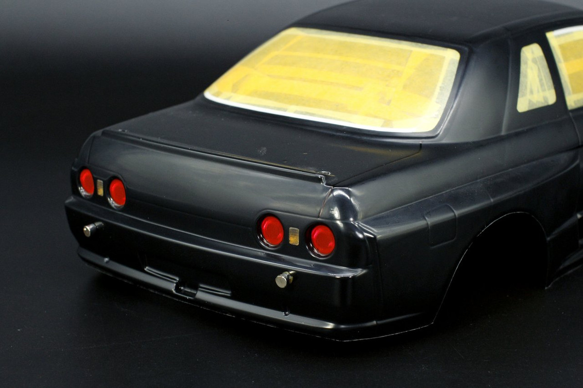

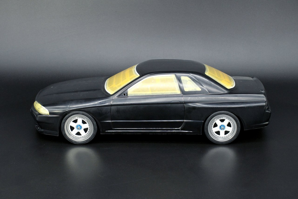

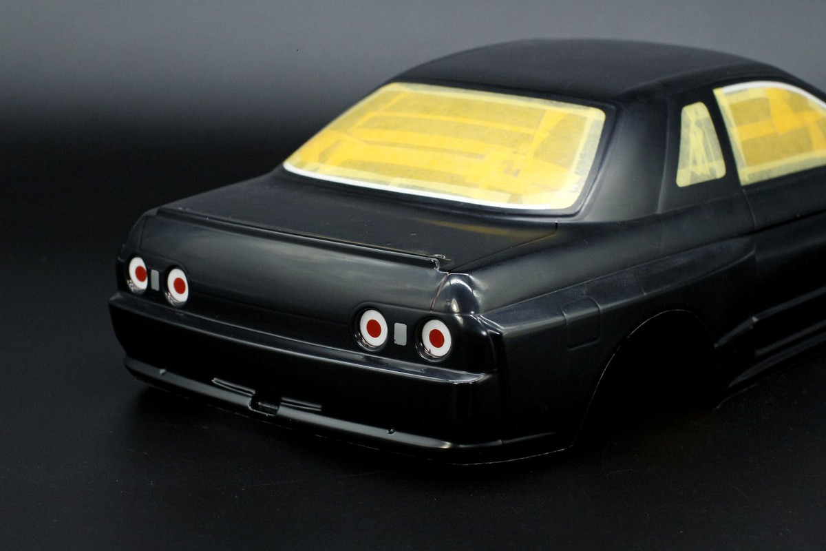

Now onto the body. The big benefit of this livery is that the entire body is just black. Super easy to paint! Can do the windowtrims and body colour all in one go, so I only had to mask the inner part of the windows + all the lights.

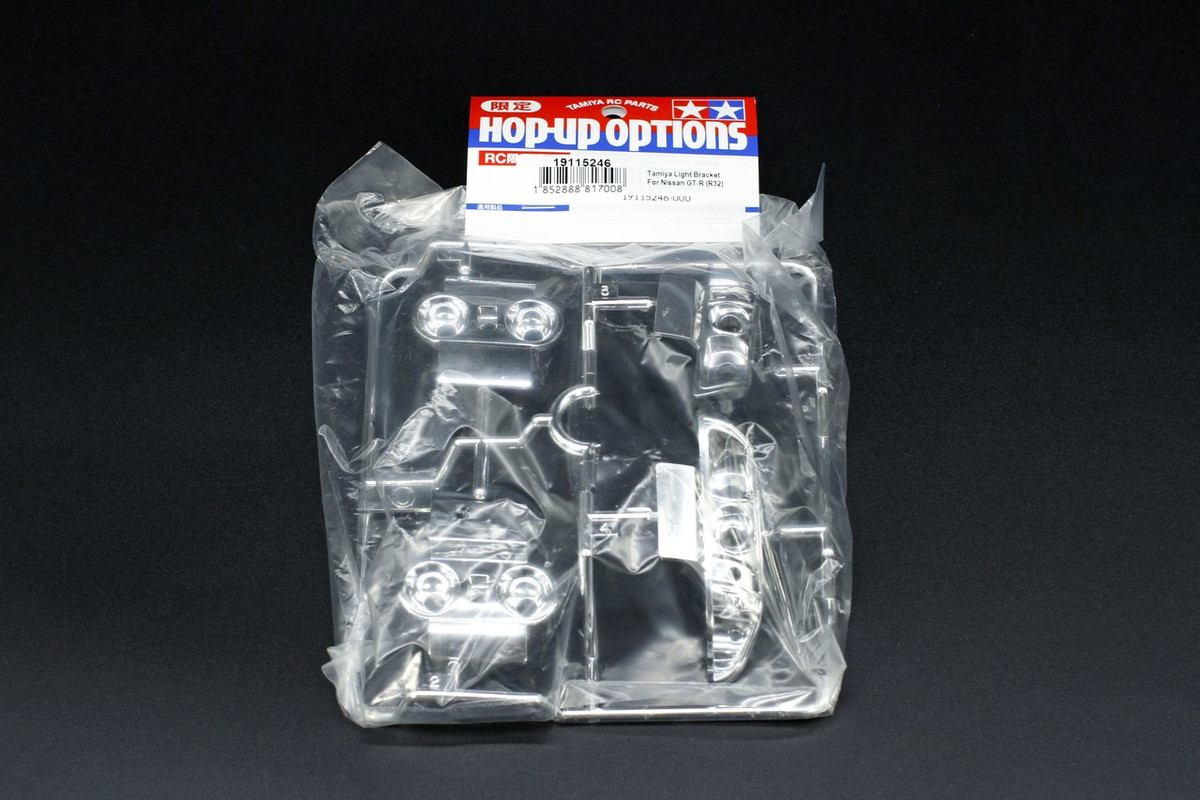

The HKS version unfortunately does not come with the lightbuckets from the street version, so I ordered those separately. Because I will have the lightbuckets, the lights needed masking too. With the street version the little indicator light inbetween the two circular tail lights is just a sticker, but I decided to mask this as well. I measured the decals and cut some masking stickers on my plotter to make sure I have perfect circles. I will later probably do some extra masking to get some detail in the tail light lenses that I can't easily do by using 3D lens decals from WrapUp Next or Pandora. The front will be easier hopefully.
Quick spray with the airbrush with black (and a backing clearcoat) and the paintjob is almost done.

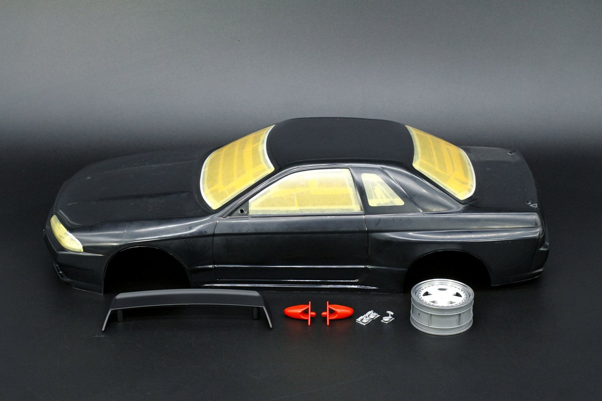

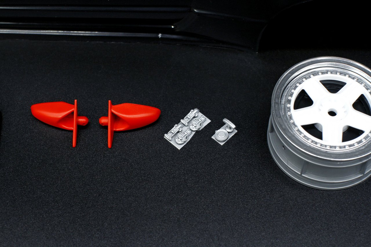

As I mentioned before, my goal is to make the body look as realistic and correct to the real car as possible. Luckilly there is tons of reference material available. Based on the dimensions of the decals and a lot of the reference pictures I was able to 3D design the bonnet pins, boot latches, emercency switch and extinguisher pull, airjacks, tow hooks and fuel fillers. All of them I printed at work in resin for the highest detail and it being easy to paint.
Here's a picture of some of the printed parts after painting them silver. I will add a black wash to the silver bits to give it a bit more depth.

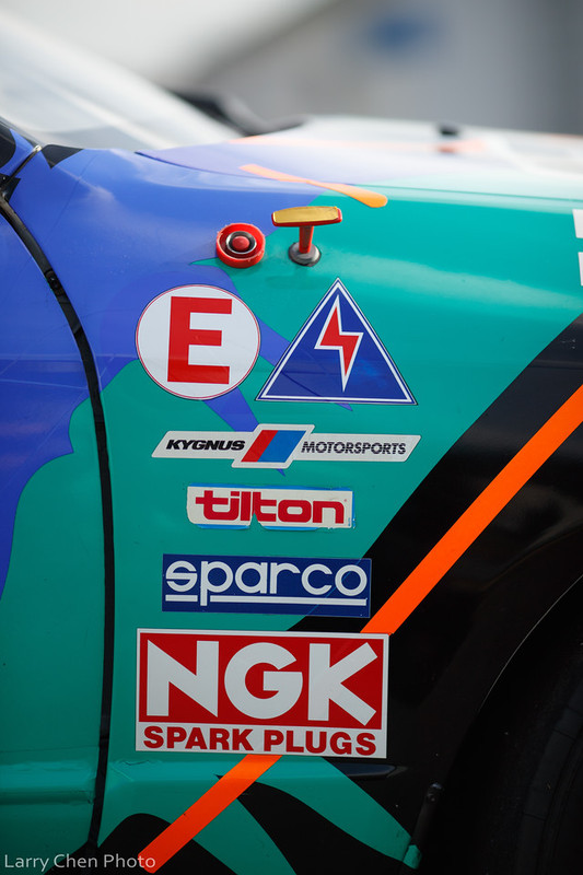

Some of the excellent reference photo's by Larry Chen that came in handy when drawing the parts.

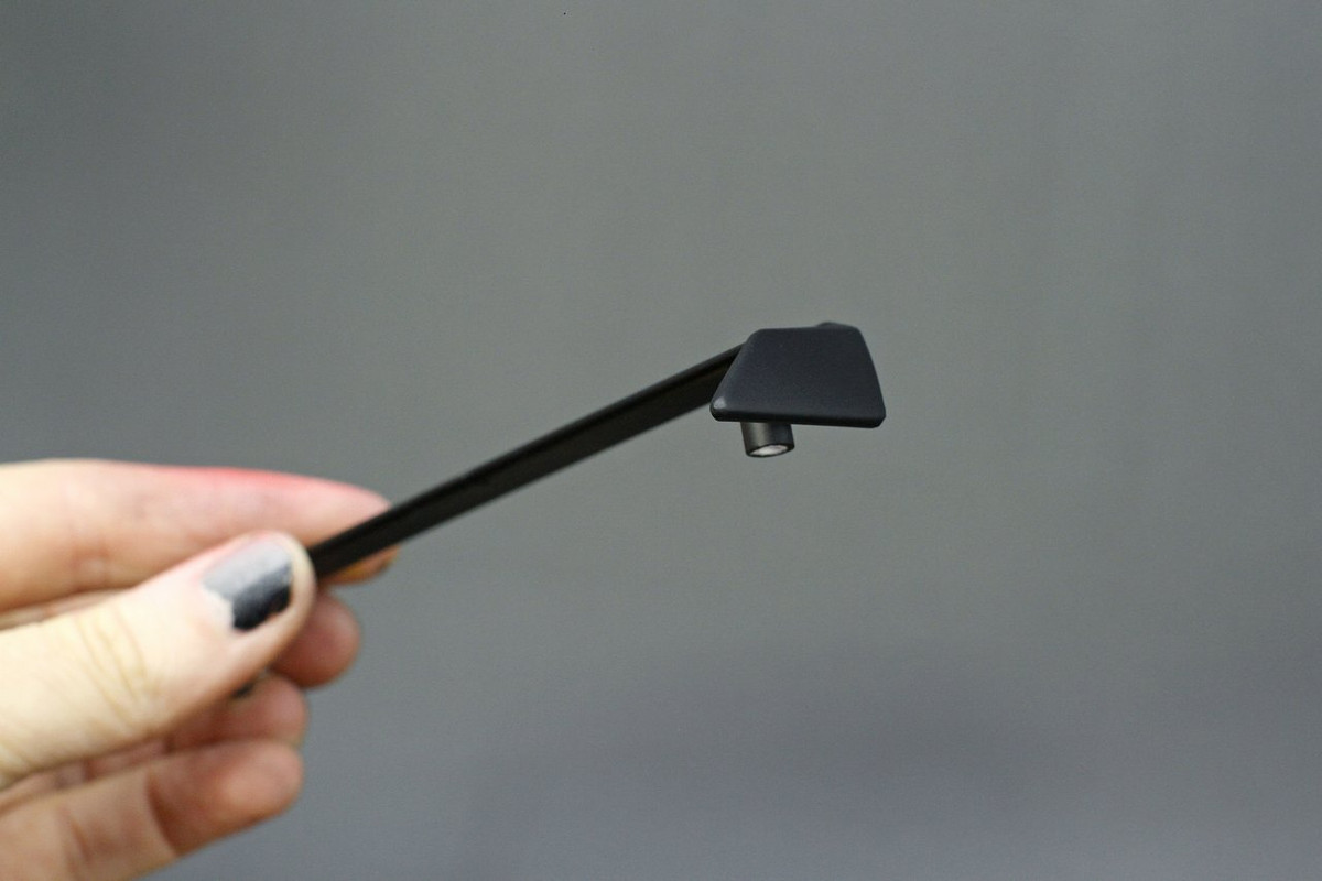

The side mirrors included in all of the R32 Group A kits that Tamiya released are from the street version originally on the TA01. Unfortunately they are incorrect for all the Group A cars, as they used a smaller and more aerodynamic (Ganador style) mirror. I opted for a set of Blade Racing mirrors I often use on my drift builds.
The real car also has a slightly more rounded shape on the bottom of the sides of the spoiler. I rounded the edges of the Tamiya spoiler with some sandpaper and will add a thin spacer underneath to get the same look.

Since the HKS TT01 kit doesn't come with lightbuckets, like the street version does, I ordered some separately. They were out of stock almost everywhere but luckilly RCMart still had some.

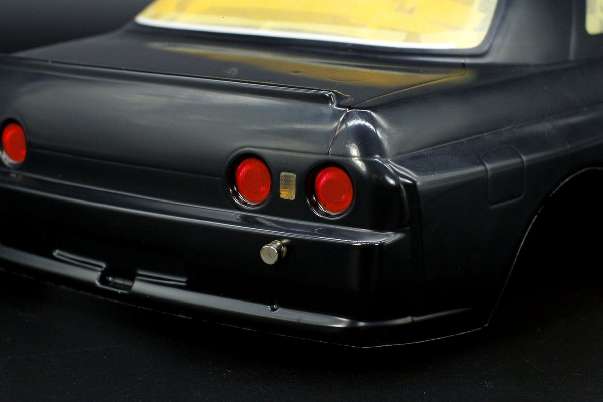

The rear lights I did by masking off the centre section of the lights and painting those with translucent red, chrome and then black. This will make sure there's no light coming through here and adds some detail.
Next I removed the masking and painted the outer section translucent red as well and added a lens decal. The turn signal in the middle I left unpainted as the real car also has a clear lens here with an orange bulb behind it. To mimic that look I've used another lens decal and painted the lightbucket with translucent orange. Came out pretty good if I can say so myself :)

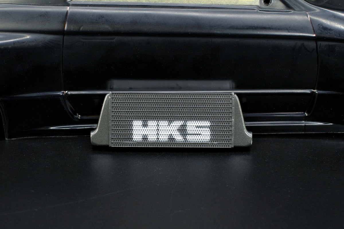

Last I worked on painting an intercooler for it. The Tamiya kit comes with a decal for this, but the logo on it is wrong (it says HKS Racing, while it should only just say HKS). I used an old Yokomo intercooler that I painted metallic black and added the logo by cutting a stencil on my plotter. Still needs to be glued into place but I like the result!

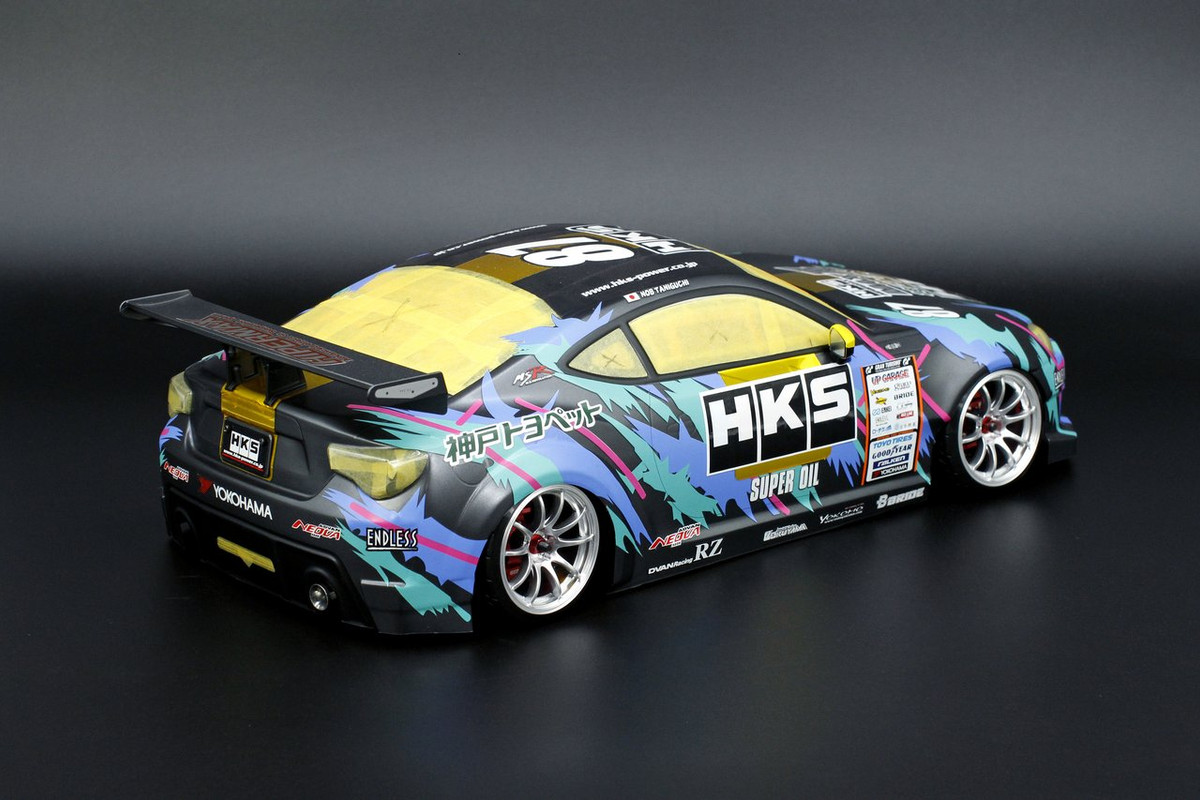

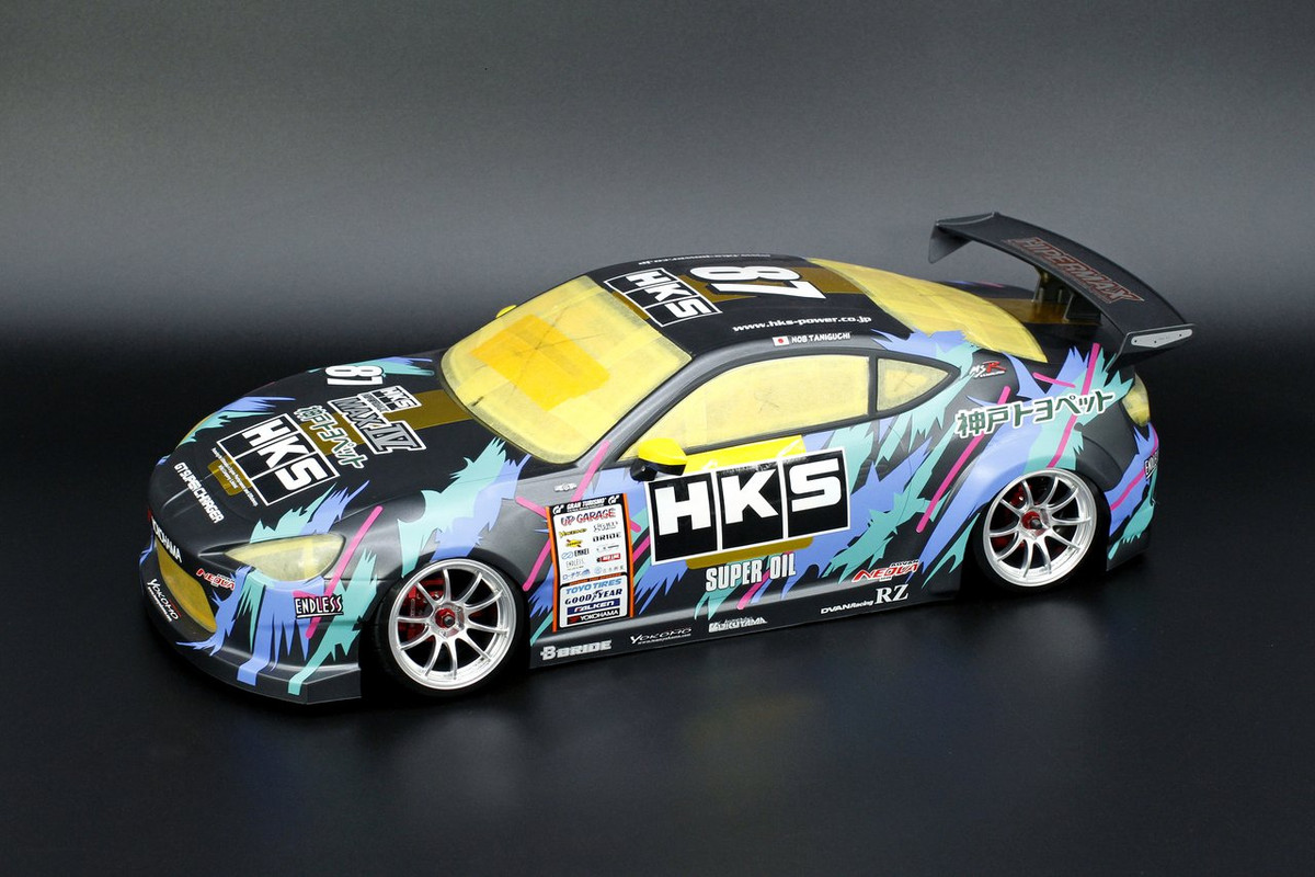

The long discontinued Yokomo HKS GT86 Racing Performer. Hard to find body now! Was lucky to find the complete kit + a lightbucket set for it. Painted it in a metallic black colour to mimic the dry carbon look the real car has without having to mess around trying to get a weave pattern in it. Yokomo themselves suggest to just paint it black but I think this suits it better. I've used a darker black for the rear diffuser. The wing is painted in the body colour and all of it (including all the decals except for the chrome gold striping) has been covered with a matte clear. Windowtrims are painted a mix of matte and gloss black to mimic the rubber trims and glued edges of the glass. The included side mirrors and exhaust have also been painted instead of using decals. I've found the matching Yokomo Advan wheels and wrapped them in Advan tire thread T-Drift tires. Still left to do is add a few 3D printed details such as the aerocatches and boot latches and paint the lightbuckets to match the real car better.
This was supposed to be a quick job inbetween building the rest but it's also taking longer than expected. I do hope to have it finished before the end of the year. It's so close!
