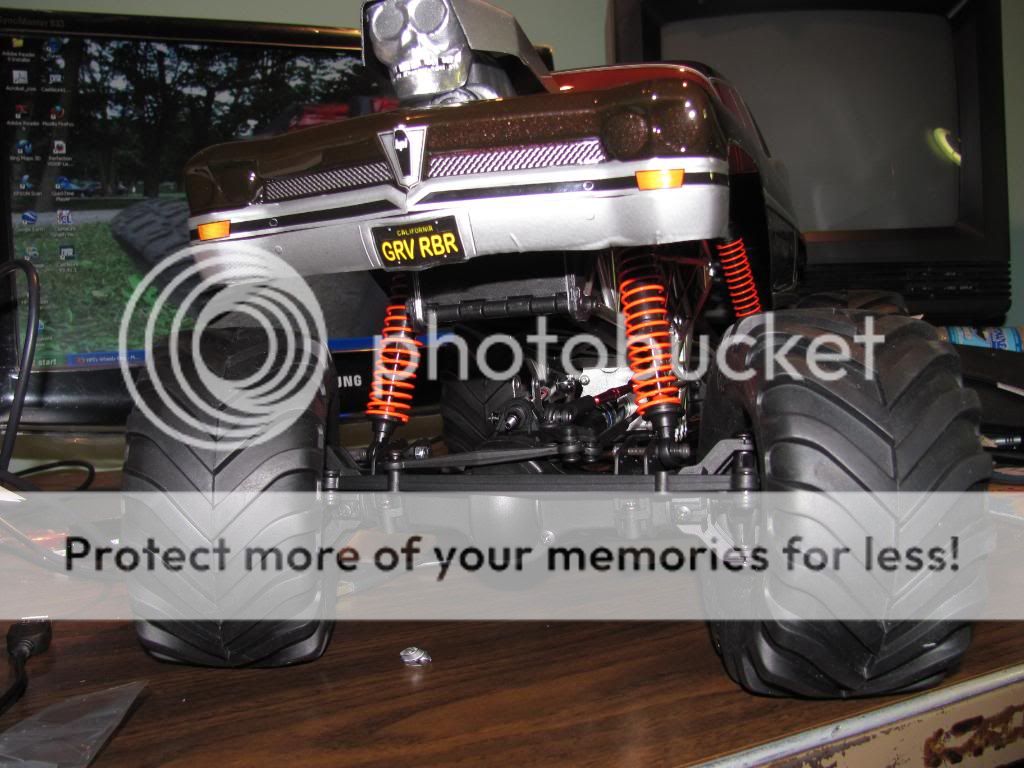

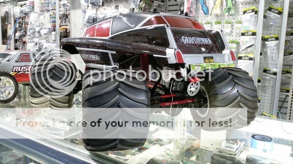

I did that with my Grave Robber bodied Wheely King, it’s at least half made up of spare parts of other trucks and the kit was bought to try and build a Super out of, but with a sudden lack of interest, that failed. I then added 4WS and the Proline Clod rolling stock as well as going from a XL5/Titan 12t to the VXL system that is back in it now.

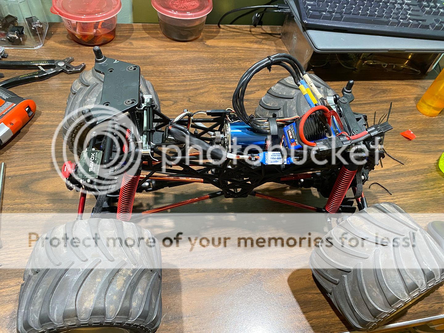

I then added 4WS
Ooh that sounds like an interesting thing to learn how to do. Did yo have to take the normal front steering fro another car and then adapt it to run in reverse?
It was pretty easy, the front and rear axles are identical with the only real difference being the steering lockouts. When I converted the Grave Robber to 4WS, I bought a second Servo mount for the axle, along with a second servo, second Servo saber, matching parts for the tie rod and drag link, and since it was rear battery at the time, a Servo lead extension to get to the Rx.  If you’ve converted a Clod to Servo on Axle and 4WS, it shouldn’t be much different.
Here’s the stock steering and rear lockout.
then what it has on it now.
