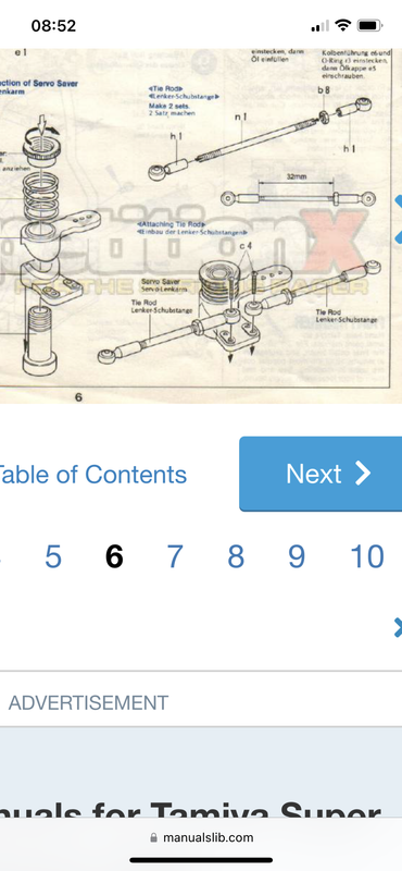

And what are your thoughts on putting a SC servo saver and steering rods etc on my SS?

Yes re the Tamiya SC servo saver - but be ready for breakages sir
Its a high maintenance upgrade - as we’re pretty much all of the SC changes
To be honest, the CRP early plastic front end upgrades are pretty much a pre-requisite unless you want to be off the road waiting for spares all the time ?
Ditto their rear arms and suspension brace 👍
