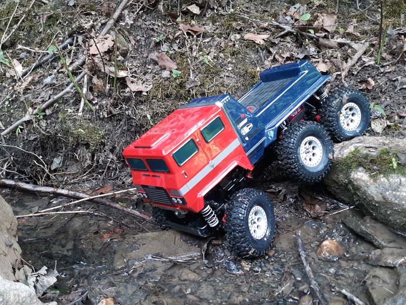

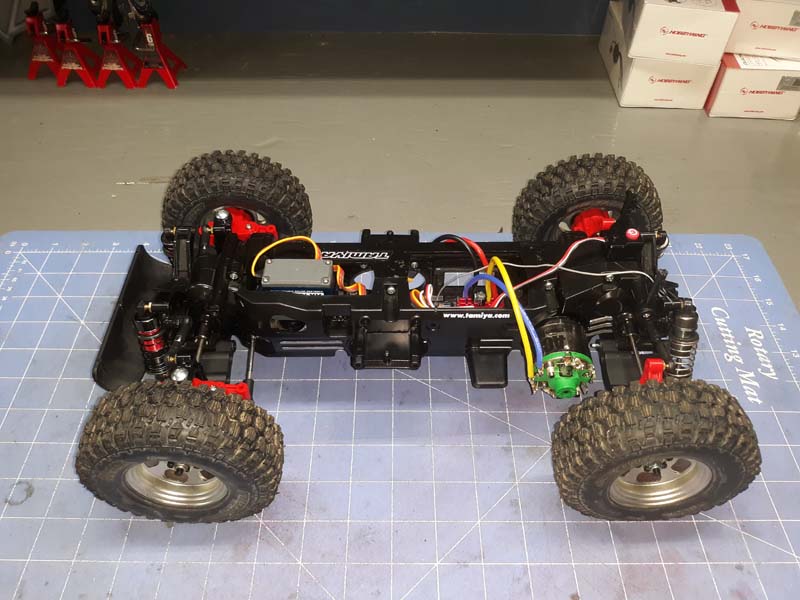

I took my Dynahead "Prime" out to a G6 2 years ago, and was blown away at how well it did. 6 tires worth of traction really counts for a lot. I'm running a Holmes 5 pole 540 mated to a 3:1 reduction and a 20t pinion, and all three diffs are locked solid with 3 extra diff gears crammed in each. Combined with the portals, this combo is absolutely perfect gearing for the trail. I have weights in the front wheels, and about 1/2 as much in the rear wheels to get a 55/45 weight balance, and 4.19 Proline Hyrax on it. That's pretty much it - the 4WS makes it prety agile, and if it can get a wheel on a rock, I can usually get up and over it. Plus, it sidehills like a champ - it just sticks on the side of the rock. I think the tallish body throws mw off, it looks top heavy, but it's not bad at all. Very pleased with the truck and LOVE the body, I have no intention of changing a thing.

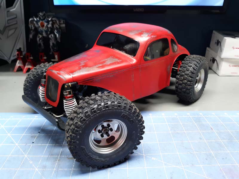

How about a TL01? Not your usual crawler, that's for sure. I've been messing around with this one for a while, and it was a TL01B with 1.9's on it for a while. I've since gone back to a more standard touring setup and settled on the hot rod body. I used Comical series arms front and rear for a bit more width, and put a set of Tamiya Portals on for more ground clearance. An Xacto mini motor works with a 3:1 reduction and it's a perfect combo for low speed resolution and tops out just above walking speed. Both diffs are locked for now, though that may change. The front wheels are weighted to balance out the rear motor.
These are some older pics, it's changed a bit since... I think I have a thread here with it, I'll update it when I get some new pics. I have yet to run this out on the trail, but I think it'll do well.

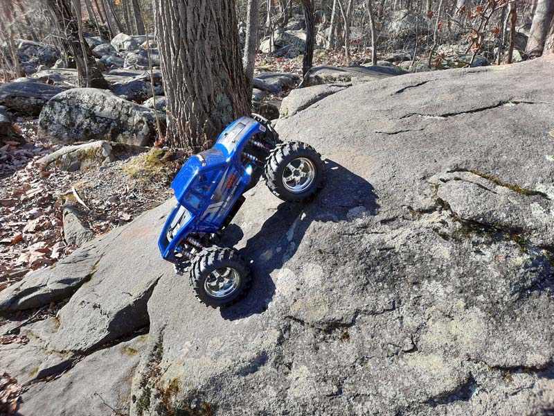

I've also converted a few Traxxas as well. Can you crawl with a 4x4 Stampede? Turn out you can if you really try! :)
I've actually got two of these...one started as a well worn Telluride, and the other was a beat up 'pede 4x4 roller. Both were cheap Ebay finds since if the concept didn't work out, I wouldn't be out too much. I built one to play with, then picked up the second later on build up to compare different setups and they've evolved quite a bit from the initial build as I've tested and learned a few things.
I still consider this the "Telly" since it evolved from the Telluride. Long story short, it has been converted to use Bandit rear arms front and rear for a narrower track. I managed to get some grippy 1.9's over those huge front hubs just barely, so it has a similar footprint as a TRX4 Sport.  90mm shocks gave me all the travel I needed, and looked way better than the huge stock ones. Some lead weights tucked in here and there, and a smaller battery shoved as far as possible to the front gives a surprising 60/40 weight balance - fantastic for a chassis where the motor is out back. A Danchee Ridgrock body tucks right over the top and I love the look. I did mod the steering a bit and I'm just shy of 45 degrees which is as good as it's going to get. Another Tamiya Xacto motor/3:1 reduction and a large spur put the gearing right in crawler territory.
Surprisingly, after a lot of testing and tuning I found a front locked diff and a rear diff that slips a little to be the best performance setup. I filled the rear diff with silicone earplugs, so it turns, but just. Acts all but locked going down the trail, but on steep climbs when the weight shifts to the back, it allows the rear to slip a slightly which lets the front tires pull it up and over. It added a ton of stability to climbs (it tended to pull off to one side or another) - way more than with both diffs locked. Who knew? This is by far my best performing conversion, this truck will absolutely go anywhere my real crawlers do.

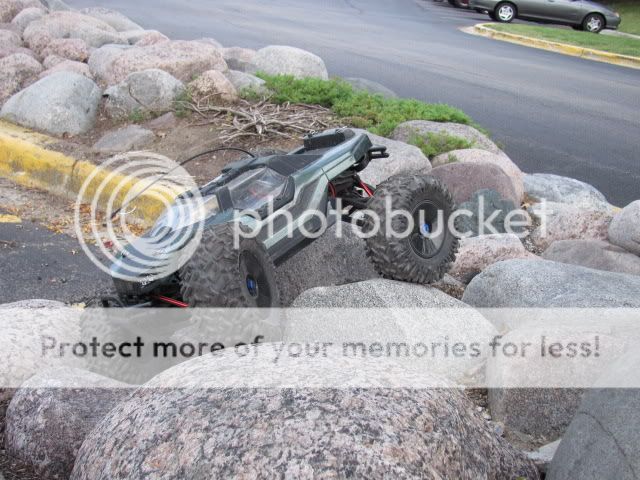

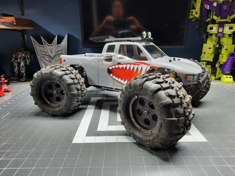

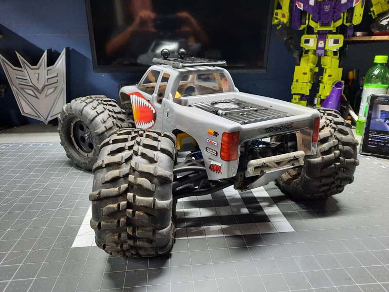

This one evolved somewhat backwards. I won a set of 8" (!!) tall tires in a giveaway years ago and had no idea what to do with them. It took 2 years just to find the wheels since they're somewhat rare, but once I had them I finally decided to build something around it.
The only thing I had that was wide enough to support them with a wide enough stance was a latest generation E-maxx I hadn't run in years. So I took off the suspension assemblies and cut a new chassis for them. It's huge, almost 1/5 scale. I added the diff lockers front and rear, set up 4 wheel steering using a pair of 1/5 steering servos, and used a 2 speed trans, reduced again with an Axial transmission. The motor is an odd sized 570, it's huge. On 3S, it has more than enough power for trail running and I think any more would break some driveline parts with those huge tires. It zips in high gear too.
With my 1/18 axial, which I could mount inside the chassis under the body and no one would notice. :) An interesting idea.
I've got a Redcat 1/5 body on it for now, it needs a bit of trimming to drop it down a bit. Not sure what I want to do here yet.
The entire truck is very much a work in progress, it's not quite ready for a trail run yet.

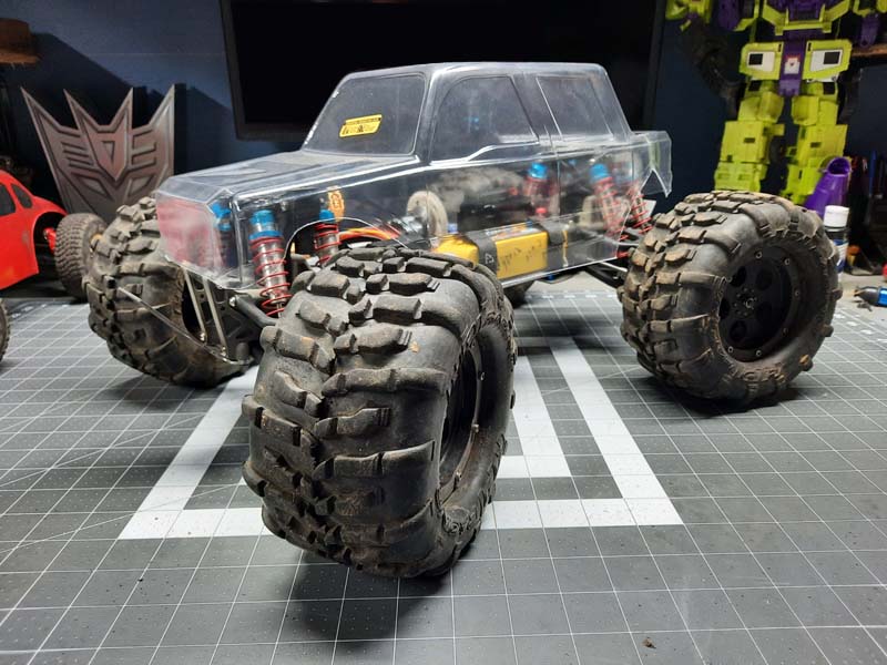

However, as always once I get an idea, I tend to run with it. Realizing that Maxx's are cheap, plentiful, and have a ton of aftermarket options, I ended up picking up a cheap used T-Maxx 1.5 truck and set about to making a crawler out of it.

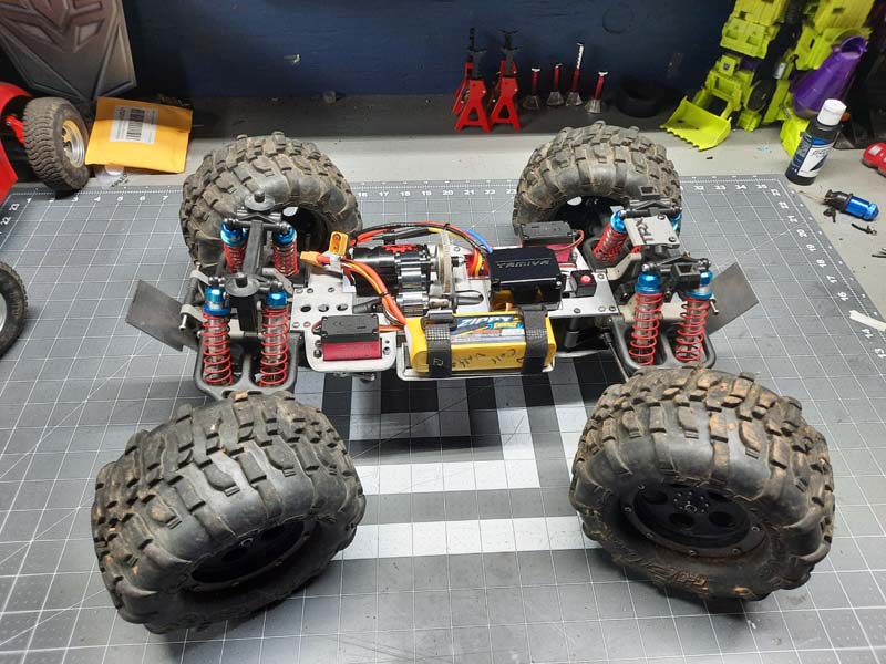

Added the lockers F/R, and made a new crawler oriented chassis for it. Same wheelbase as stock, but now with an Axial 3 gear transmission and a Holmes 550. A single battery was tucked in up front. The lower plate is steel for a lower COG, but otherwise I added no other weight.
I kept the 3.2 tires since they gripped well, and it's kind of a signature for the Maxx platform. Same with the dual shocks.. I love the look.   This thing is a blast in the woods. A single Holmes 5 pole motor on 3S moves the truck pretty well and with crawler gearing, it's a totally different platform. Has gobs of grip and suspension and it just floats up and over everything. It's a different drive than a solid axle truck, for sure. It crawled good for what it was, but I thought it could do better.

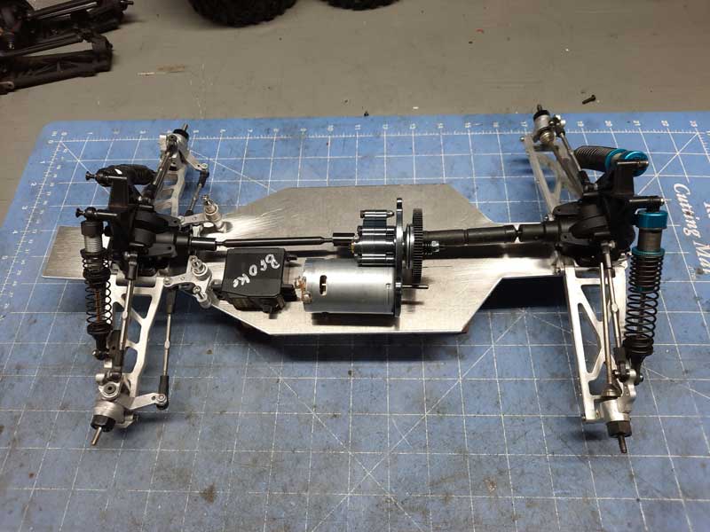

So I just cut chassis v2. Added 4WS (since steering was terrible with 2WD), moved the motor as far forward as possible and put the battery down on the lower chassis. Also added some 3.2 beadlocks and more agressive HPI tires... this should be a beast out on the trail now. Body is awaiting paint and then it's round 2 test time.

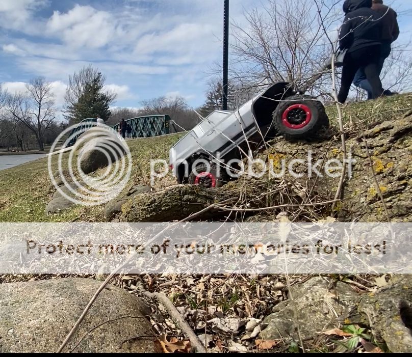

Love this thread. Mine is more a "rough trail" truck than a true crawler due to 2WD and semi-open diff, but I drive my vintage Sledgehammer all over the place, and I've been really surprised at just how capable it is. It'll still do ~18mph at full speed, but it'll putter along all day at walking pace too. Lots of little mods and tweaks everywhere, and it's still wearing what's left of its original body.

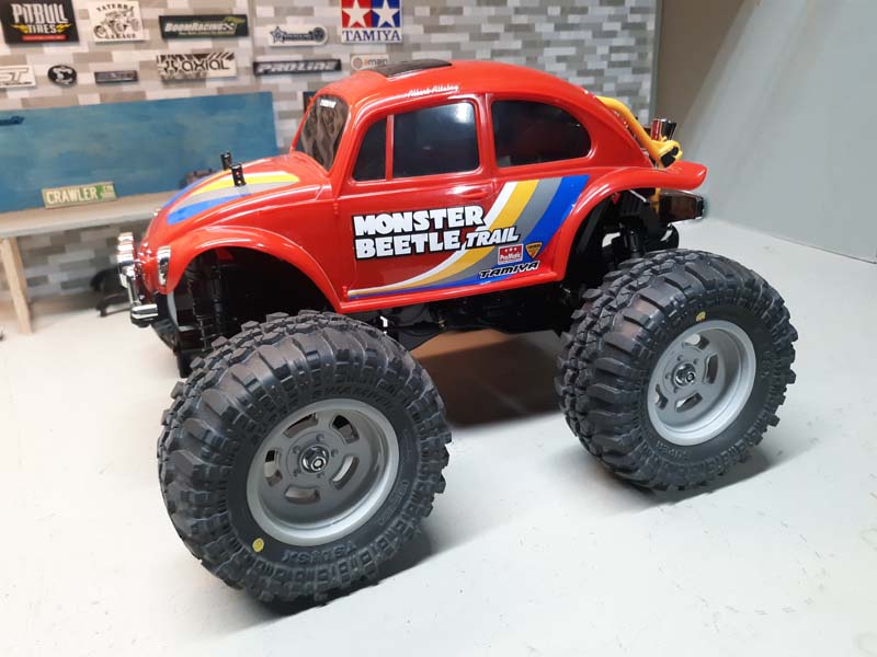

Thanks, that MF-01x us a great little rig with the portals on it, it was worth every penny to get the Mobster Beetle TR kit to get the portals for it!
Nit only did I have the monster truck Helios body on this, but I had the smaller ones on my AX10 before turning it into a SCX10 and on my now retired Losi Crawlers.

@BJoe76 Did you ever build anything out of the leftover Monster Beetle TR?  I went ahead and finished it up, sans portals. Turns out it's quite a fun little truck
I turned that into a Wild Willy 4x4!

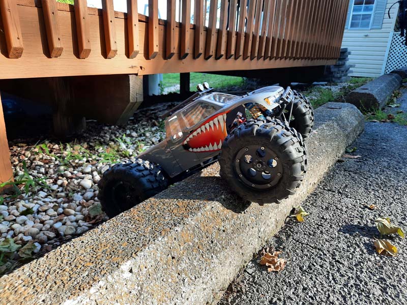

Crawler Maxx version 2.0 is finally done. Took the easy way out and just fudged on some Tamiya body mounts and dropped on an old T-Maxx body I've had for at least 18 years. I don't even know what it is....Proline Tundra I think. I found the window masks, but couldn't find the decals so I fudged some up. I went with the OG T-Maxx decal set for the throwback look. I freaking love it.
4WS in full effect. It never turned well, but this should make a ton of difference.
I know flex shots are passe, but I had to take one anyway. This truck has a ton of suspension.
It's geared a bit tall still for crawling duty, but it made for some fun bombing around. Amazed at how well a simple $20 Crawlmaster on 3S throws this chassis around. Definitely has plenty of power! I'll drop on a 14t pinion before heading out on a run.
Don't have much to crawl on in the backyard, but what I had it makes short work of.
Did some fine tuning on the steering and ride height and it's ready to go. I've done a lot of custom builds, but this one is in the top 5 for sure. Can't wait to get this back out in the woods.
