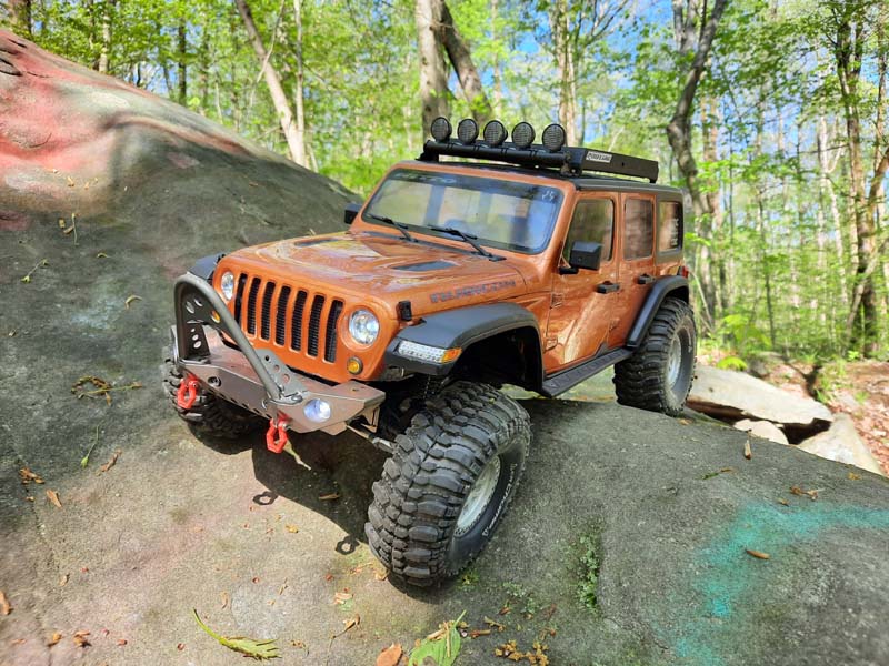

The SCX10 III comes with either portal axles or AR45 solid axles depending on which one you get. Gotta say I'm very less than impressed with my III, my II will crawl circles around it. It seems like Axial tried to make a TRX4 - they should have stuck with simple and performance oriented imo - that's kind of their wheelhouse. The builders kit version might be better than my JLU kit as it has a simpler transmission.
Looks nice though:

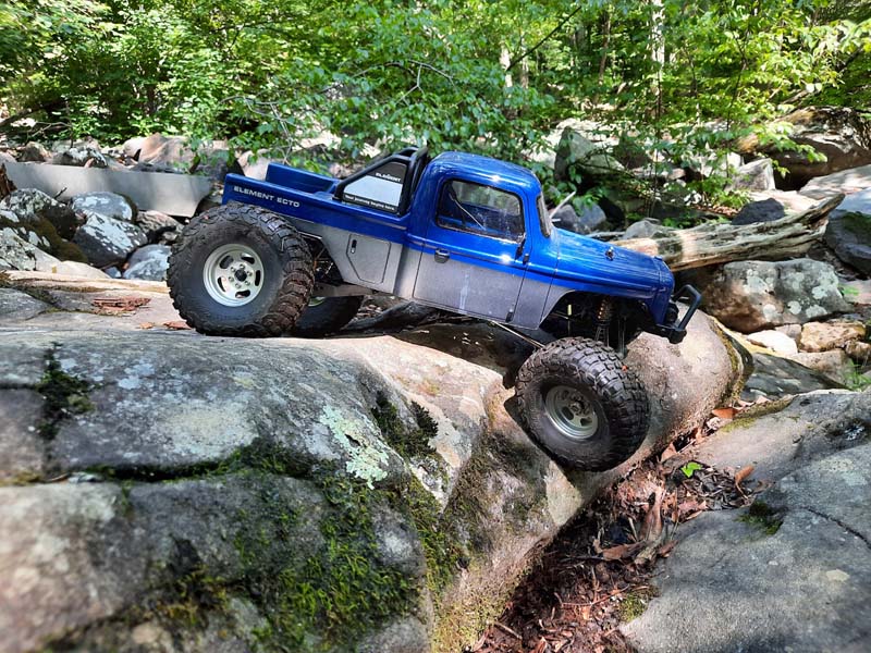

I highly recommend an Enduro - builders kits are excellent, and the RTR's are pretty decent if you want to go that route. Simple, reasonably priced, and they work well.  Body and wheel selections are endless, and lots of suspension options to play with as well - IFS, rear trailing arms, etc.
