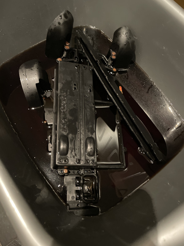

I’m going to try a bath of full fat coke-@-cola for the chassis next, as it doesn’t fit in my sonic cleaner.
Although I suspect I’ll hit a point soon when the drill will have to come out - but this will be my last resort.

The chassis will get a coke bath tomorrow and once I’ve taken out as many screws as I can I’ll have to get the drill out.

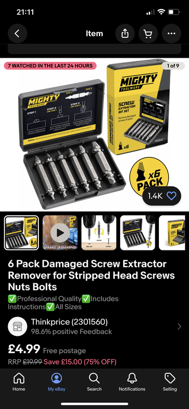

I’ll need to buy some new drill bits and more latex gloves though.

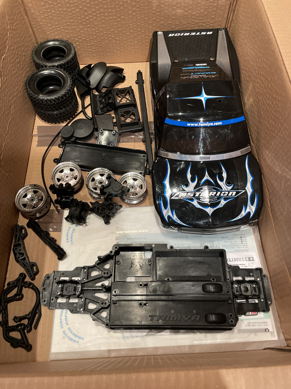

I wanted a change from disassembly this evening, so I made a start on cleaning up the plastics and inspecting them for damage.
Tested the electrics and the ESC and radio gear all worked.
