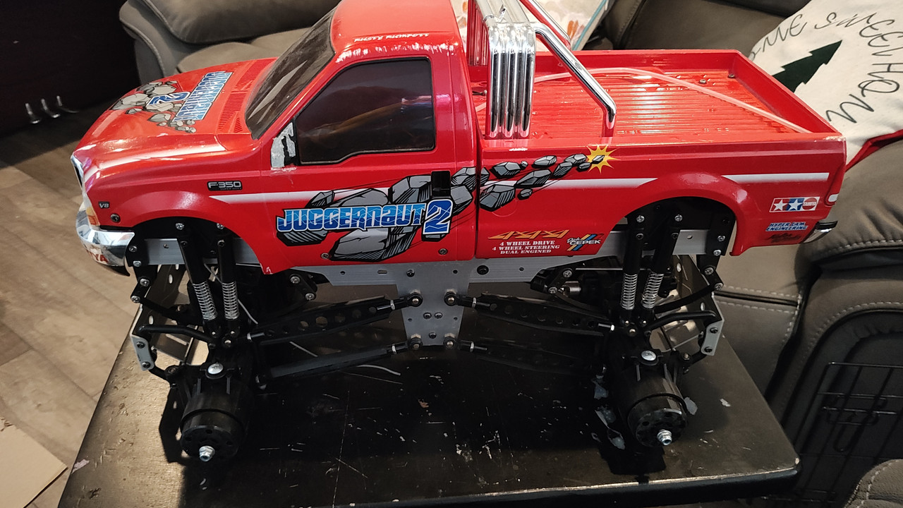

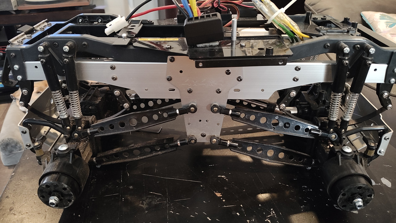

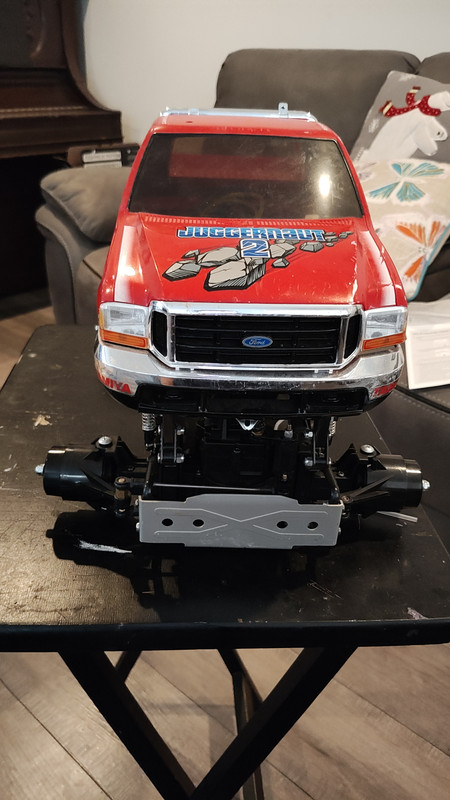

Lets goooooooooooooooooo, Body removed, this is the last we will see it with 8 pogo sticks! Im not going to tear it down to every bolt., it was built very well.  Axles, shocks, trans, etc.  The truck looks to be assembled well, loctite on all the metal to metal, and the screws arent boogered up, no need for a 100% tare down.  Im going to start with the rear axles. Inspect and if good save the new axle housings as spares and install ball bearing and RC4wd oil shocks.

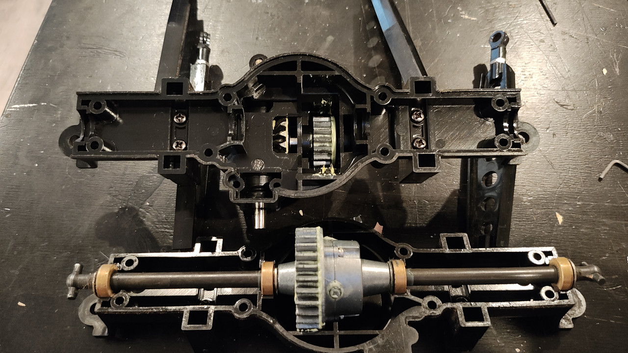

Rear end split apart, axle housings look great. No cracks, blemishes, etc. I'll be keeping these.  New ones will stay in the package

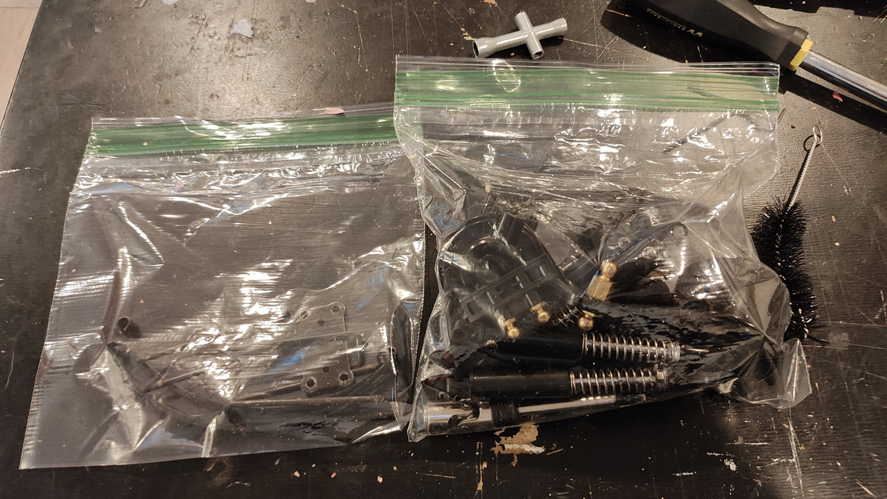

And all the parts left over....yikes.

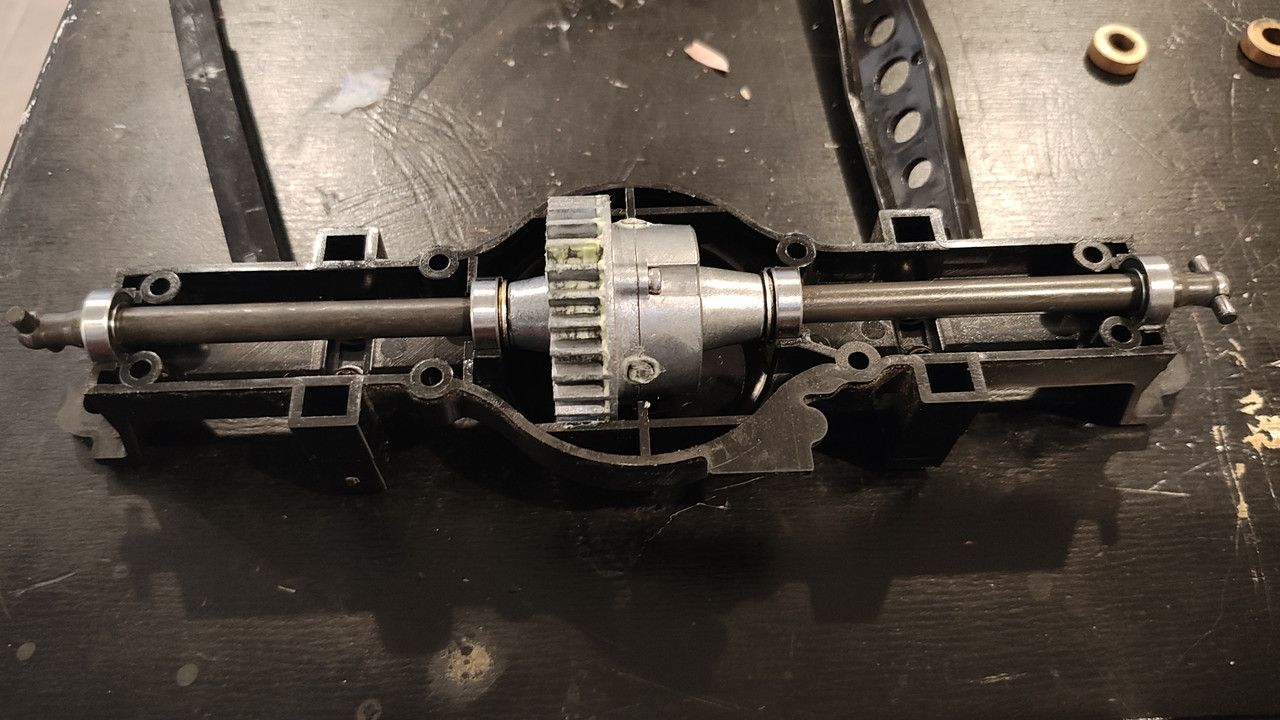

Bearings installed:
I did not know these beasts had gear reduction type axles, pretty stinking awesome!!!
....and bearings in, they look so pretty!

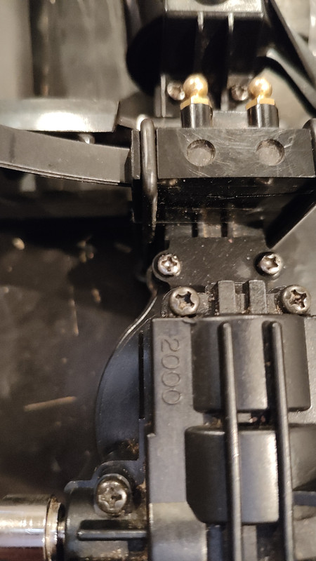

and ready to go back into the truck! 2000, thats what you want to see on your molds of your Jugg1 /  Jugg2 if you want it to run it. If you are trying to score an all original Jugg, and plan on not running it than you want the molds that dont have the 2000 on it.  Whats great is that Tamiya used these through the TXT2 so spares are kind of easy to get. Not Clod easy but, easy enough.

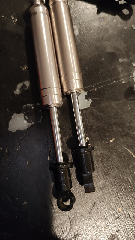

RC4WD shocks, I used the factory Tamiya rod ends for the shocks as it alows for using the Tamiya Hardware thats on the truck. These feel fantastic.
 These look amazing on the truck and provides actual damping, I used Tamiya hard shock oil in them.

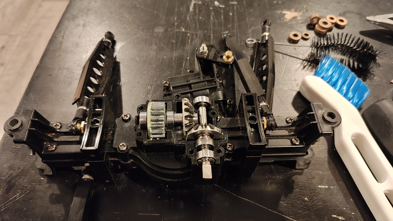

Next up the transmision.
Alright, alright, alright! Monday is update day!!!!

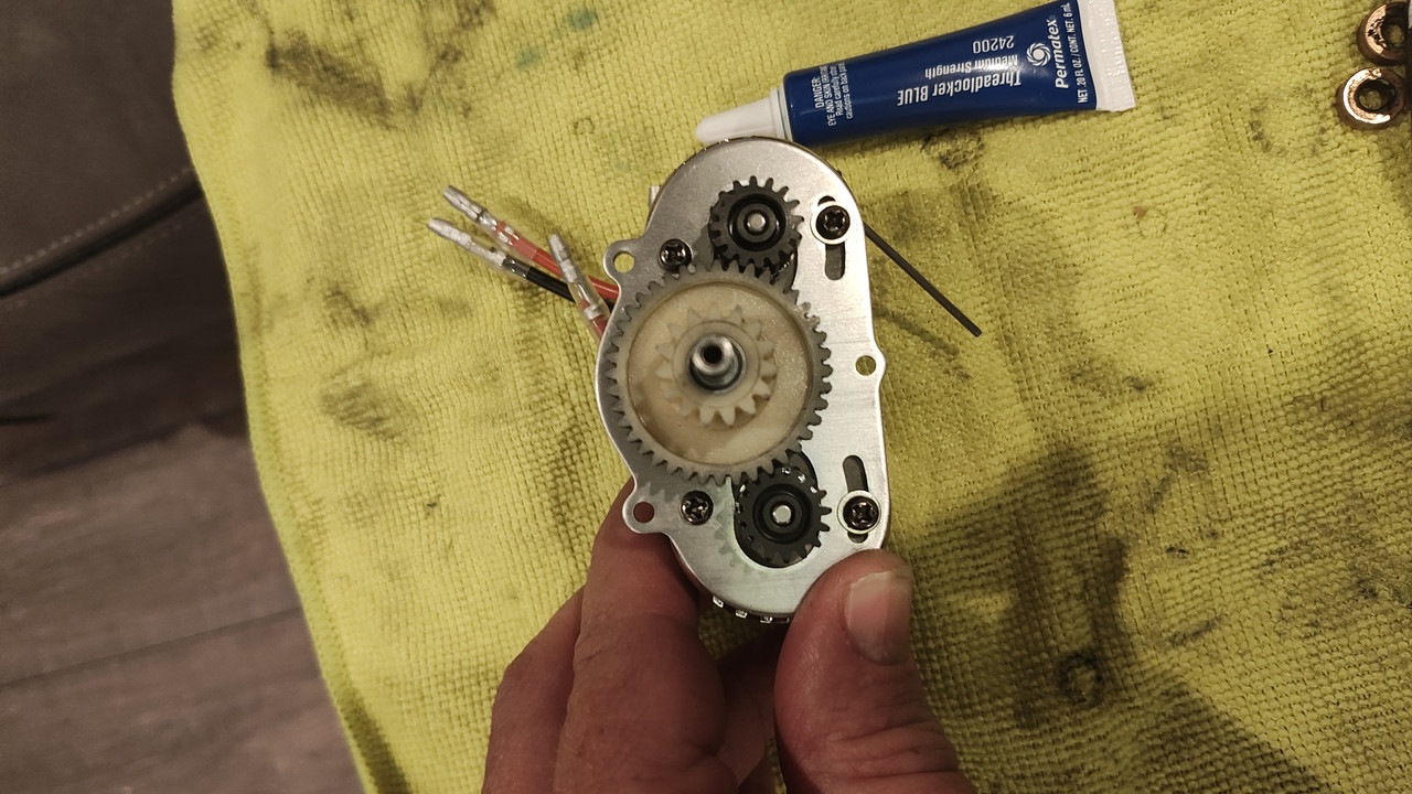

Time to upgrade the trans!
Extra HP is always welcomed!
Big tires, lots of metal, hard body, these silver cans gotz to go

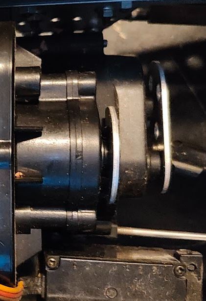

Tamiya did a fantastic job engineering the beast, these are additional heat sinks to help cool the motors, pretty cool

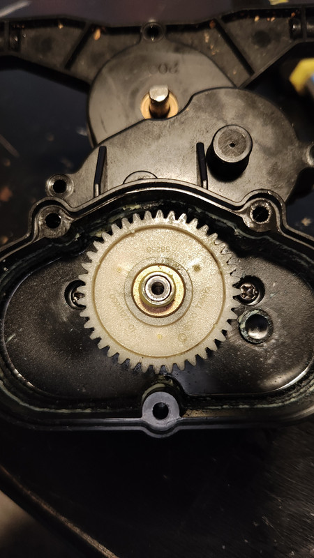

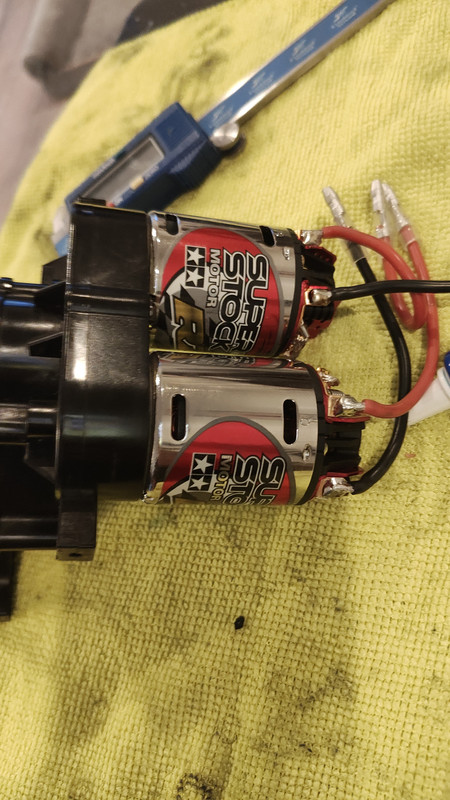

Spur gear looks fantastic (I was worried as the Jugg was using the standard Tamiya dissolving pinions) , other than that bronze bushing....thatll change

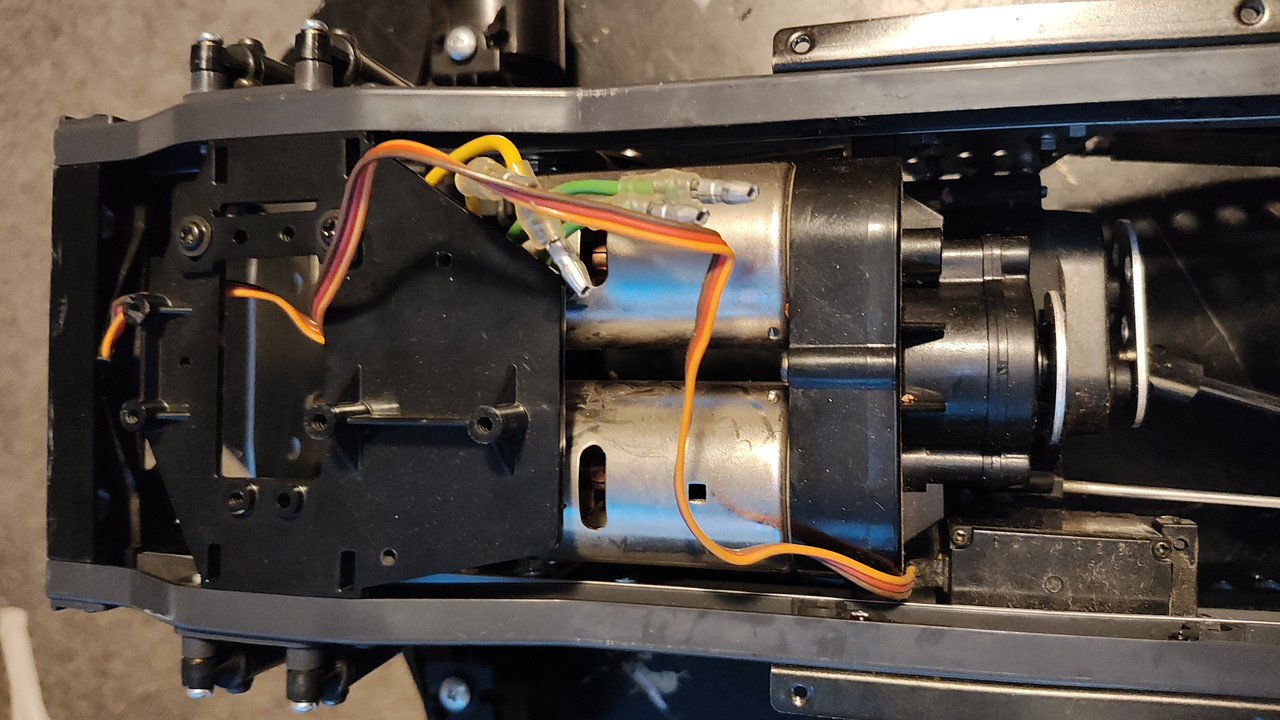

RZs in
Nice hardened Pinions

Sorry forgto to take pictures of the bearing inside the trans....
Wow... This Jugg shall be fast :ph34r:
Do you plan to add a cooling fan on the ESC? I would recommend it, as with simple silver cans, a classic ESC (mine is a Teu 106-BK) can already overheat... :)
I hope so!!! I love the RZ!!! In my opinion they are the Technigold/Dynatech of today. I don't have one as of yet. I've got a back up twin motor Hobbywing in the wings in case I let the smoke out.
Never tested the RZ, good to have your opinion :)
By the way on my Jugg the TEU-106 didn't deadly overheat, I meant the "thermal protection" was activated quite often without the cooling fan ;)
