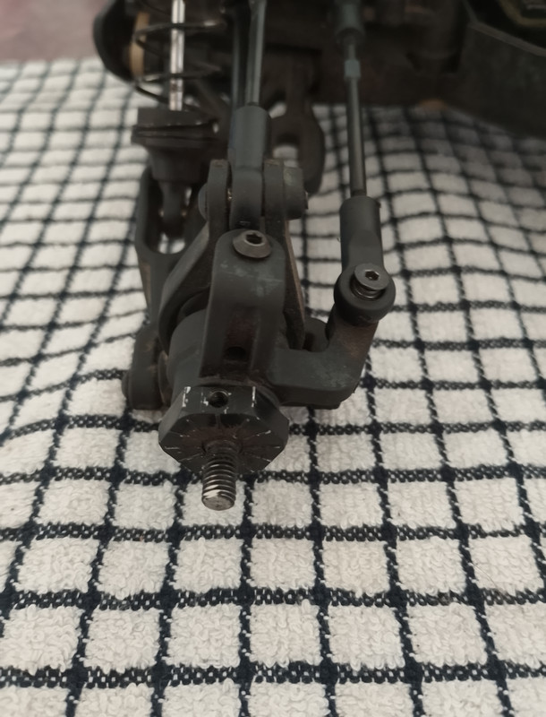

That just leaves the other rounded front wheel nut to release but had enough now. The picture below shows the front axle after the nut and flange were finally removed and wheel removed.
I have a theory of why the DW wheel nuts can be a problem.  One is that the contact area to do them up or unscrew them is very shallow, making a spanner easily slip, gradually rounding them off.
Also I think the wide flange/disc area really grips the plastic and there are indented markings on the inner side that press into the plastic.  This could make them harder to unscrew.  When I removed the wheel there were indents in the plastic too, either there by design or created by the flange disc pressing into the plastic.  That said, I don't think I'll ever lose a wheel nut because of this design, although have just ordered another spare set, just in case and because I've used my spare set now.
Yeah, those things really do grip the wheel quite tightly. Definitely can make it hard to unscrew, even when the nut's HAVEN'T been rounded off. And they definitely shouldn't come off during use. As long as you screw them on night and tight... *cough*cough*
I'm quite surprised that the pliers couldn't get enough of a grip. And the cutting discs kept breaking and then the tool itself decided it was done with being alive? Some morning.
At least you finally got the thing off, with minimal to no damage to the wheel. That would have been disastrous for sure. And no damage to the original wheel hexes either, those are also impossible to find.
And with new wheel nuts on, you can finally remove the wheels if you ever need to do some maintenance and repairs, or replace the wheels with some that are less rare.

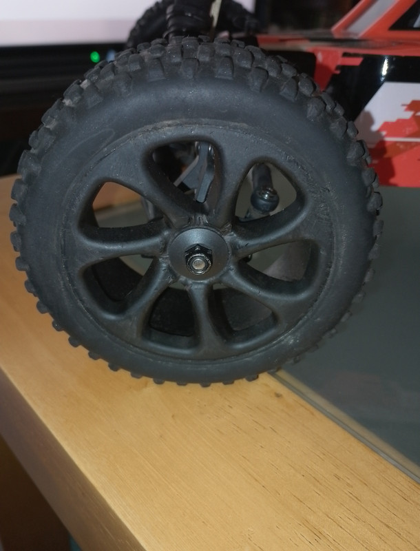

The condition of the wheel after all the violence, not too bad.
I think they are different somehow... it's the reason I wasn't able to tighten the wheel nuts without the hex getting crushed against the bearing in the wheel hub.
I bought some HPI alloy wheels hexes thinking they'd be pretty much a like-for-like replacement, but they weren't.
What I think is different is the original hexes have a shallower fit on the hex pins than the HPI ones I bought. If that makes sense? In other words, the HPI ones I bought have a deeper recess for the hex pin, so it sits closer to the hub than the original hexes...
Not sure if any of that made actual sense, lol.
