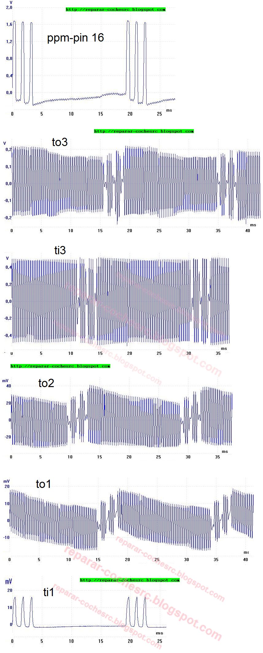

The electronic board has the OKI L9367 integrated circuit; pin 16 is the input signal coming
from the receiver and on this pin you can see the amplified PPM signal. This one is the diagram:
The 27Mhz receiver, demodulator and intermediate frequency filters is very similar to
the diagram shown in the OKI L9362 datasheets:
And the signals are these:

* On pins 8 and 11 of the L9367 circuit there should be about 6V (circuit supply voltage). On the electronic board there is a voltage reducer (circuit with Zener diode) for this.
*  On pins 9 - forward (or 10 backward) of the L9367 circuit there should be about 4V at full throttle. It is a pulsed PWM signal visible with an oscilloscope. This signal activates and biases the H-bridge transistors. The signal information is in the duty cycle, not in the voltage. I recorded this video in a Nikko proportional control car: https://www.youtube.com/watch?v=muKW6eYPamE
I believe that the 1st gen transmitter pulses are shorter or longer than the 2nd gen transmitter. Then, the buggy waits to receive the original pulses. Try turning the throttle neutral trimmer on the buggy board in case it corrects it.
