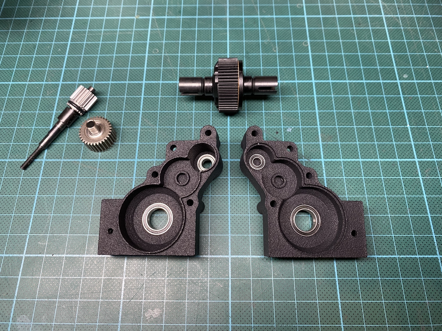

Hello,
as I did before for the transmission conversion for my King Cab/Hilux Monster Racer, I also want to separate build thread and transmission conversion of my Dyna Blaster.
So the transmission section will not be mixed anymore with the restoration section.
In this thread I can also offer a better and clear support for interested customers and can answer questions regarding the gearbox, parts list, manual or assembly.
For pictures from the installed gearbox in a Dyna Blaster / Dyna Strom, please visit my build log/thread:
Sgt.Speirs' Dyna Blaster
Parts list for this modification:
Please note:
Due to the insolvency of Shapeways, is their printing and shipping service unfortunately no longer available. If you still interested in the 3D printed gearbox parts, please contact me via PM or via Instagram
 (https://www.instagram.com/sgt.speirs).
1x 3D printed gearbox parts
1x 54471         TA06 Steel Gear Diff. Unit Rear
1x 22031         TD4/TD2 Slipper Clutch Set
1x 53587         Shim 5x0.2mm (1 needed)
1x 13454709  Idler Shaft  (alternatively: 54344)
1x 72001*       Idler Gear 31T (48DP) - Team Associated DR10M Metal Idler Gear, 31T
1x 19805957  Screw 3x10mm   (or standard M3 countersunk screw)
1x 19805763  Screw 3x10mm   (or standard M3 panhead screw)
1x 9805989    Screw 3x15mm   (or standard M3 panhead screw)
1x 53577         Urethane bushing (red)
1x 53588         Ø10 mm Shim Set (optional parts for shimmimg the gear diff)
1x 42115         Ball bearings 1510  (2 needed)
2x 42113         Ball bearings 1050  (3 needed)
1x 42113         Ball bearings 840    (1 needed)
*) Team Associated Spare Parts Number. The plastic idler gear of gear set 91466 is also compatible.
Optional parts:
1x 51314         Tamiya 48DP 91T Spur Gear    (optional part for gear ration settings)
1x 51714         Tamiya 48DP 86T Spur Gear    (optional part for gear ration settings)
Manual for the assembly:
Gearbox Assembly - Dyna201 Manual_v1.0.pdf
External link for non-members:
Dyna201 Gearbox Assembly - Manual v1.0  on GoogleDrive

@GToddI don't know why the links to the Shapeways parts in my first post didn't work, but I updated these to the latest version?
Please let me know if you have any further questions about the gearbox or need support/advice on sourcing the parts.
