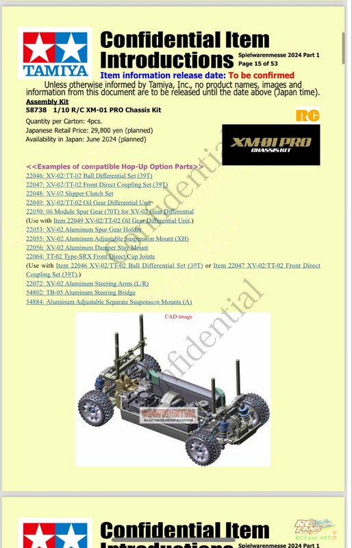

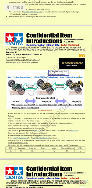

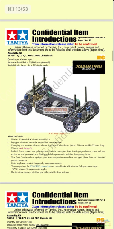

9 hours ago, Tamiyastef said:
I'm intrigued but won't ask how you got hold of these
They'd been posted on another forum in Asia.

14 hours ago, Alex97 said:
That battery tray is very tight.
The whole package is quite tight, especially in S-wheelbase.
I wonder, why they didn't go in "improved MB-01" layout - transverse battery, but under the driveshaft to lower the CG. If they kept the reversible chassis concept, it could make a rear weight-biased TC version, too.
Regarding the center diff, I have built a XV-02Pro and a XV-02RS Pro both with center diff and the cars are fantastic both on and off road. Not sure if I'll get an XM-01 but if I do, I think there is a low-cost alternative to buying an oil diff for the center: instead buy the TT-02 diffs (51004 + diff cups 54477) for the rear and use the kit's rear for the center (you still need to buy the spur 22050 for the center diff). This should give sufficient performance given the rear diffs are usually run looser.  I am assuming 51004 would fit the XV-02 given the TT-02 and XV-02 diffs are cross-compatible (maybe someone can verify this).

Although the battery is upright I don't think it will be too much of a problem as everything else is pretty low down. Hopefully a standard stick pack will fit with zero issues.

Although I don'tlike the upright battery, it's not that big of an issue for CG, with narrow lipo square packs available.
It's more about packing efficiency, with battery like that, it requires quite large bathtub, which barely clears the M-chassis wheels, with lot of empty space unused. Because of that, it seems that larger wheels won't fit, which is unfortunate, because it could be an interesting alternative to MF-01X in off-road variant as well. Transverse battery layout would provide a bit more space.

You'll always struggle to fit a 140mm battery into a 210mm wheelbase and unless you go for a TL01 + MF01X layout which is a bit out dated now you have to go with this layout. The Durango Dex410 is a great example of keeping everything low.
Larger wheels should fit onto the 225mm+ options or use wider hexs.

5 hours ago, delta.triangle said:
I'm interested to know why the Japanese release is set so far out in June 2024,
while Europe will get the end of March release. This is not usually the case or?
The Japanese date is more accurate. Nuremberg releases hit market in May.
March date is not reliable
