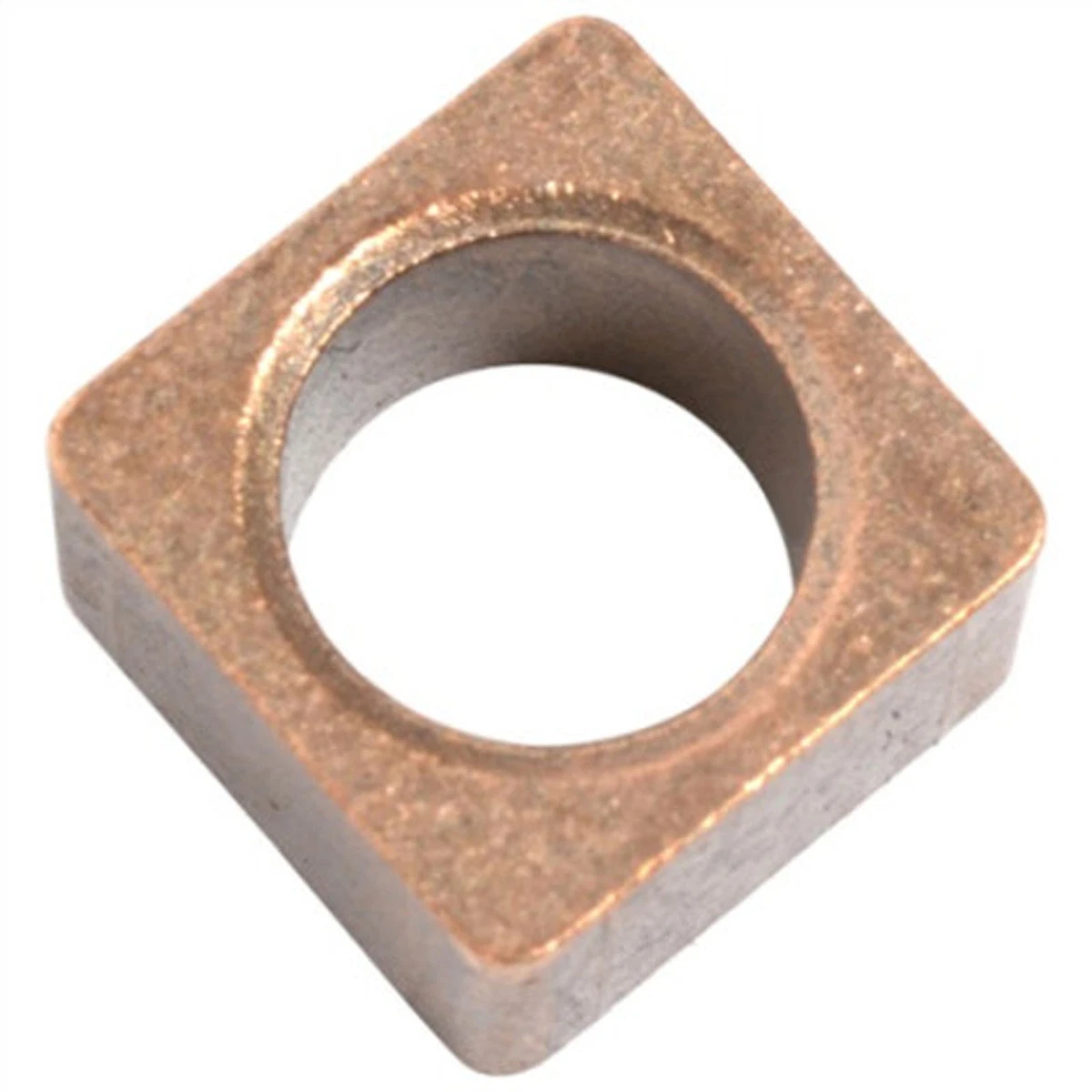

20 hours ago, markbt73 said:
I've heard of worn-out industrial motors being "fixed" for a while by pounding out the bushings and re-installing them 180 degrees off, giving the motor shaft a "new" bushing surface to ride on. It's enough to get the motor going until you can replace or rebuild it.
Did the same thing on an old tumble dryer once!
Creda Genuine Tumble Dryer Drum Shift Spindle Rear Bearing 372 373  C00113862 | eBay
I noticed most of them are asymmetrically shaped these days, wonder if it's to impede this "life hack"?
Tumble Dryer Rear Drum Bearing | eSpares
