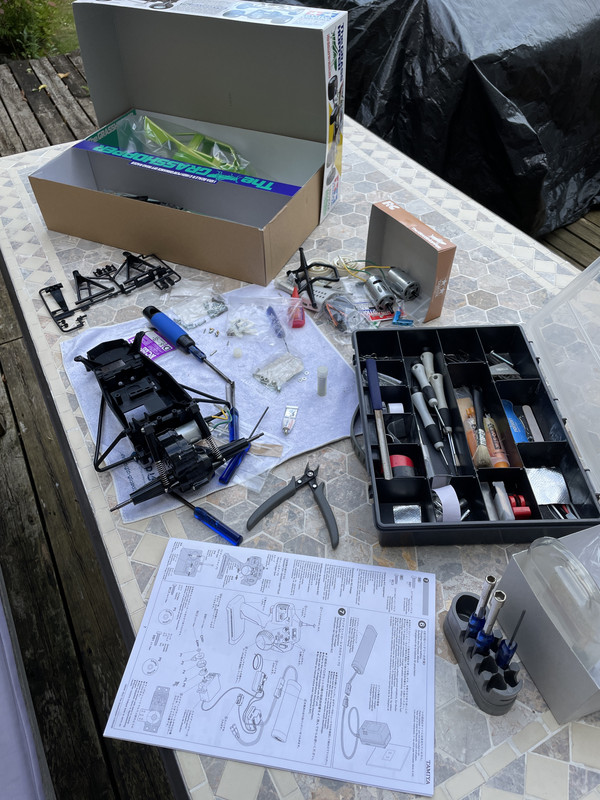

Enjoying this build - front shocks next, paint the wheels, then put the electrics in before trying my hand at the soap and water method for the decals 👍

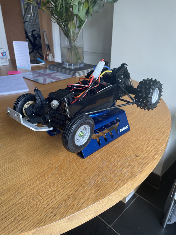

It’s been awhile 🤦‍♂️
Anyway, up and running with the 380 motor and NiMH.
Paid £80 for this including delivery and an ESC, sold the wheels and tyres for £35.
Spent £5 on a pinion, so looking like £50 all in.
The wheels, tyres, Servo, Alu bumper, wheel nuts, r/x, F103 carbon uprights, and paints have all come out of my spares, super happy with the overall cost and use of kit I already have in stock.

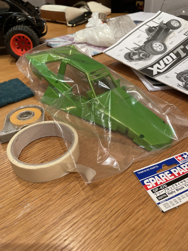

Onto the body next -
