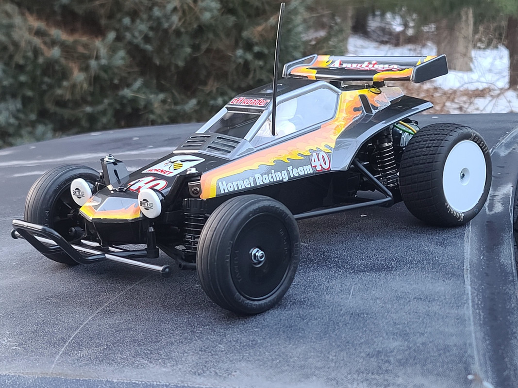

For those curious about a full DT-02 rear end swap: Yes, it looks much better.
(And yes, I know the rear camber is a little off. I need to see if I have some shorter links somewhere.)

Quick slap-dash paint job, good enough, because I'm not crazy about the Hornet body style anyway, and I plan to run the snot out of this thing. I'll do a different body later. Back to stock rear suspension for now, because I want to try it stock first.

First drive report: it's sooo good.
I was only out for a few minutes, because it's 26F outside here (that's -3C) and my fingers were getting stiff. But I'm really impressed! It understeers a lot, but I imagine that's mostly the tires. It's very composed over bumps, and tracks nice and straight, and jumps nicely. Drives a lot like an early RC10, if I'm honest. I think we as a community are going to have a lot of fun with this one for a long time to come. Thank you, Tamiya!
