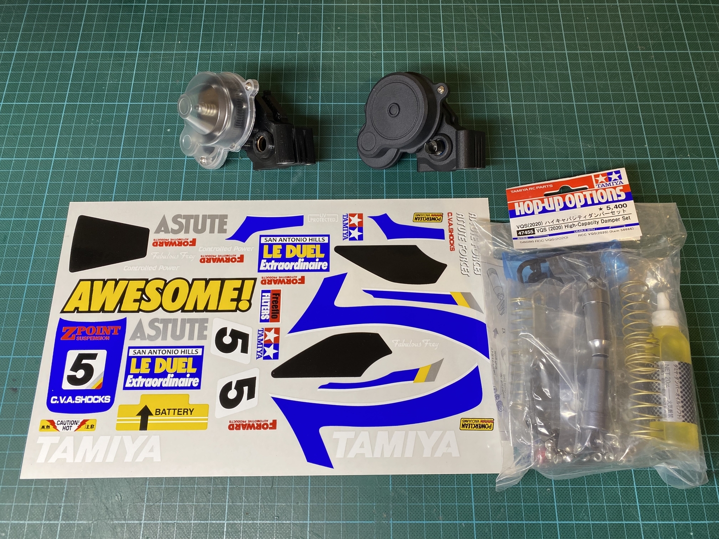

The postman delivered in time…
…and I’m planning to use the original Astute color scheme with HiCap dampers.
I'm just not sure yet whether I should install my custom gearbox (with oil-filled gear diff) for the TRF201 slipper...
…or the one with BBX slipper.

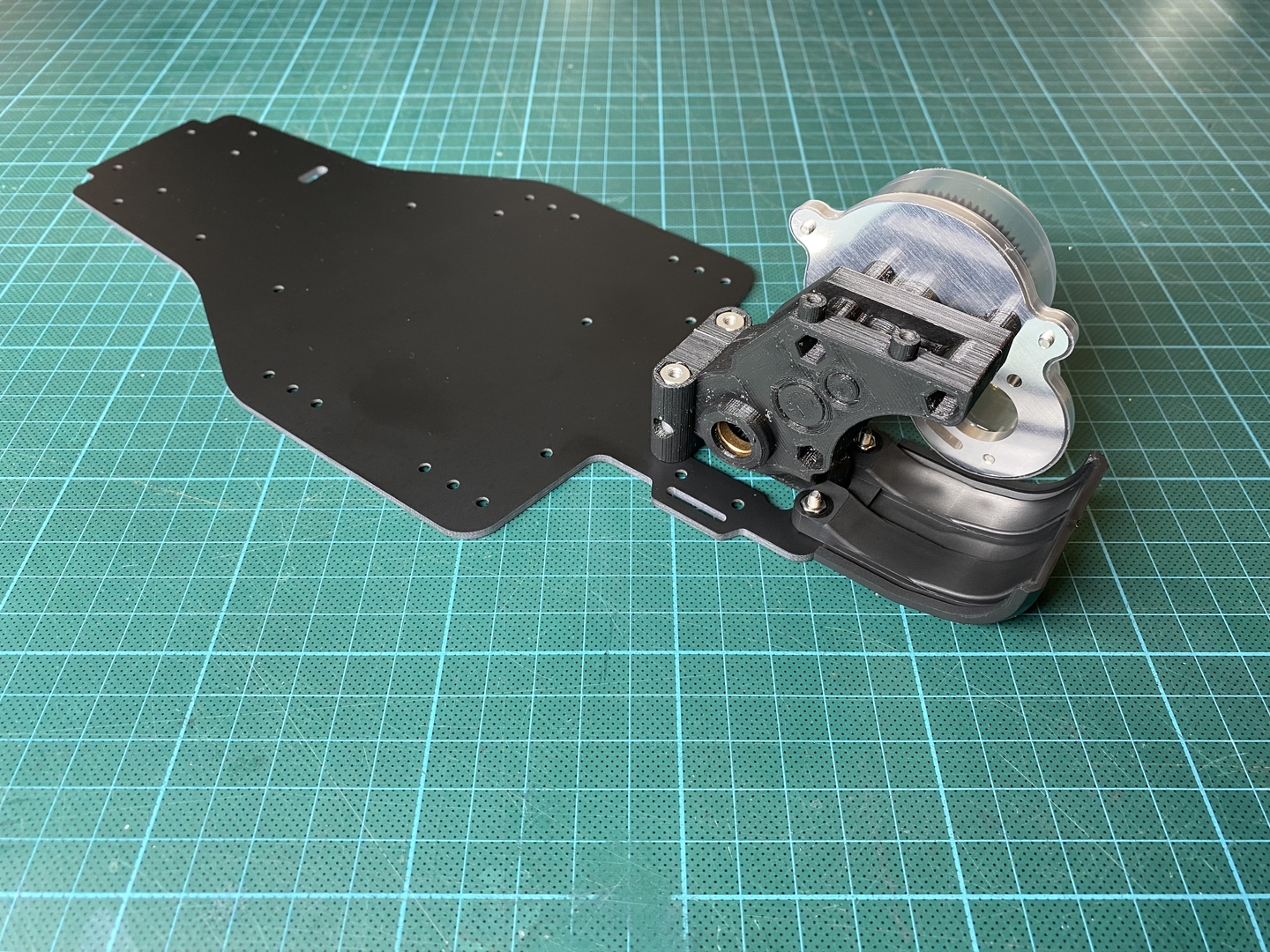

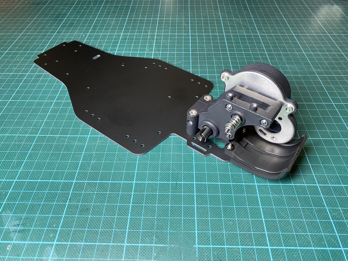

On 1/10/2025 at 4:50 AM, Sgt.Speirs said:
@MortisAngelus19: The gearbox based on my original "TRF201 transmission conversion" for the Nissan King Cab and used the Super Astute motorplate. Details of the new gearbox(es), I shard in my build thread >> Sgt.Speirs‘ Nissan King Cab - TRF201 Transmission Conversion & Restoration <<
Parts list for the original one you can find in my corresponding "TC design" thread >> HERE << .
