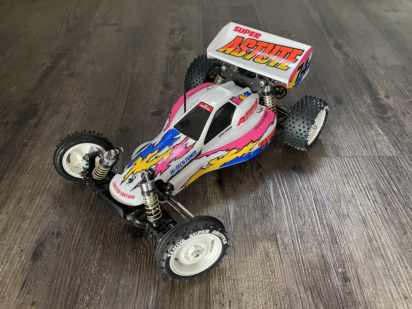

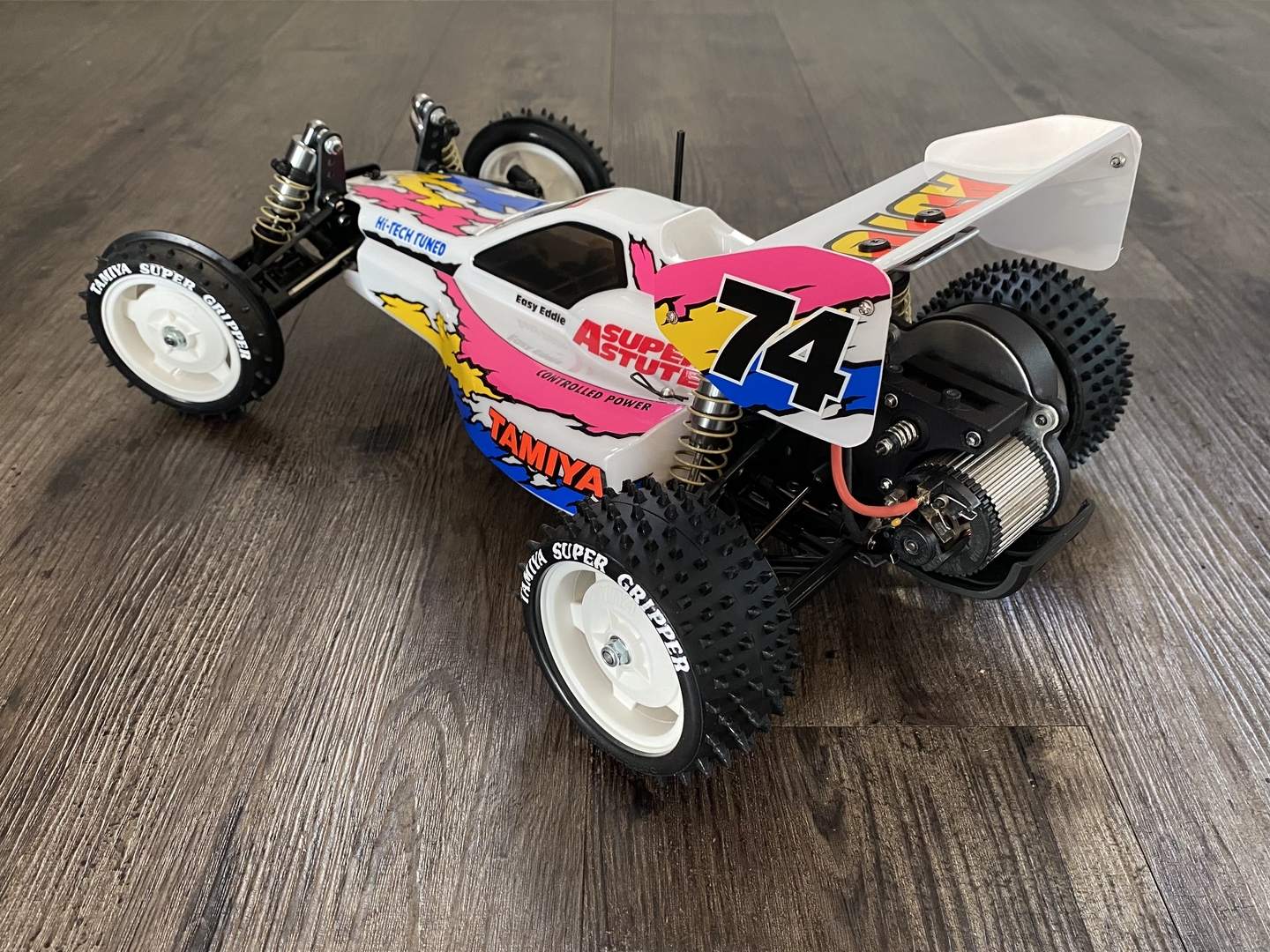

I finished my build today... finished for now, at least until the outdoor season starts.
  • Like 10
Gorgeous mate! Just look at that blingy, vintage motor in the back too!
