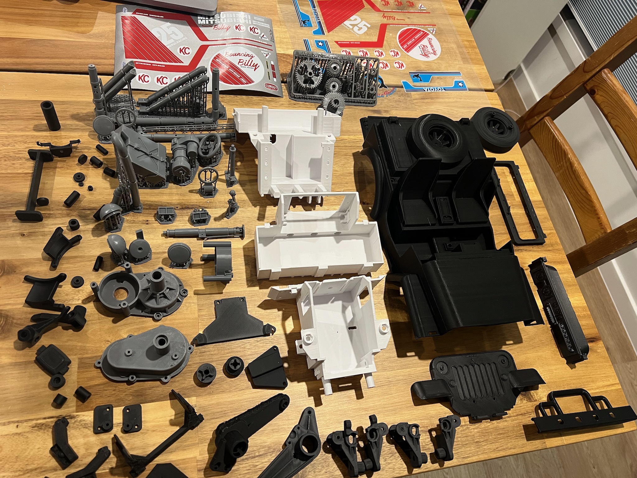

well, there is one other option, but its certainly not for everyone, in that you scratch build it. With today's availability of 3D software and printers, while it's a challenge it's certainly very do-able for you to make every part. This is what I am doing with the Marui Mitsubishi Jeep. It was in their catalogue , but never released, so no chance of getting one, but with the help of @silvertriple (he 3D modelled the parts) I am building this to be a kit. I will make every part, and intend on machining the gears (I've never done that before either, so that will be a positive learning experience!) as well as all the packaging, a manual etc so it would be as you would have bought it back in the day and then make one that drives. I have a first version of most of the parts, plus I've made up artwork and printed a test box.
Granted this is a pretty big project, but in saying that, if you get part of kit, there is a the possibility of finishing it off with 3D printed parts at least.

Wow! Impressive
yeah, currently doing a project like that. though, it's not a Tamiya kit but the idea is the same. i have a handful of spares left over, so im buying up the rest i need.
