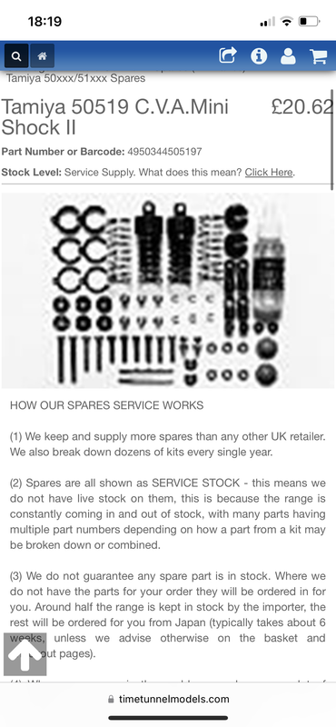

The XV-01 T the shocks need rebuilding and new piston rods - looks like they kit comes with Mini Shocks II - 50519.
I know I can buy the rods and bladders as spare parts 👍
0-A06-F438-E26-A-44-EF-8-D03-0-E79-C57-E
Can anyone confirm if I’ve got this right or wrong and whilst I’m happy with CVA’s I’m more than happy to consider alternatives 👍

Looking at the Tamiya website it quotes shock 50519 for both models for a longer stroke - in conjunction with the carbon long dampers stays - 54581 & 54582.
Probably a good route to go for me, I can buy new piston rods and bladders and upgrade the damper stays with Yeah Racing products as I go along.
It keeps the cost down, uses more of what I have and it looks like the parts are interchangeable between both chassis’s.
