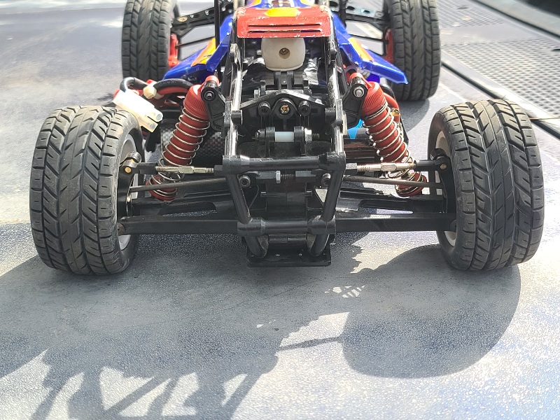

Now here in 2024, I feel like making the old Hotshot 2 a runner again. So while taking care of a few things on it, I was reminded of how questionable of how some of the "features" were designed. Although some of these designs were carried over from the original Hotshot, it was clear that these were some of the things that needed drastic improvement. Maybe Tamiya had some new engineers and rather than using the crayons to draw new much better disigns, they were eating them instead. Anyway, while I was installing some new electronics, I was reminded of how bad the design of the radio tray/box is. It's cramped and I'm sure with an ESC it gets hot due to the lack of air flow. Yes, I know, the temps may have been fine when it had an MSC, but it's still cramped and very annoying to deal with. There is the little hatch, ok, that's cool, but could something be done about shielding the drive shaft? I've been doing this hobby and other real life mechanical repairs long enough to know that the wires I tied in there may not stay put all the time. A simple shield around the driveshaft would have been a major improvement, but you know it's the zip ties and tape those engineers have faith in. 20240930_223953.jpg.66d1617062e70f3fd6d295840cc4c3f0.jpg
Since I'm running new modern electronics and I don't want my receiver in the same hot room as the new Hobbywing 1060 ESC(I fried my Tazer ESC) I've relocated the receiver to small space under the molded driver in the chassis.
I'm sure it would have been fine in the same compartment, but this just seemed to work and with some creativity the plastic packaging from the Hobbywing esc becomes a pretty neat self for the receiver and stays there pretty good with servo tape.20241001_015704.jpg.f2ed896f913165fb6deb1d0a13d32596.jpg
I rambled long enough about one flaw, time for the next one, and it's a big one. The front bumper on this RC buggy somehow looks goofy and like it belongs there at the same time. I kind of dig it's big goofy appearance, but I have one major issue with it. IT'S MADE OF HARD PLASTIC! Not too hard, but hard enough. Both the front bumper and lower bracket should have been redesigned or improved to withstand any higher speed impacts. Tamiya could have used the same plastic blend that is used in the more flexible bumpers used on many of their other models, like the Blackfoot or the Frog. So now I have to glue the bumper bracket back together with some styrene for now until I get new parts. Ok, fine, l can still enjoy running the Hotshot 2. No big deal right now. 20241001_180754.jpg.b08905a75f5da383e9591fc7e2c53b50.jpg
If you have seen the photos, you will find that I'm running the 17 turn Method SV2 brushed motor from Team Orion. It's a bit slower than the Reedy Radon I had in it (it's not, it's faster), but I don't like how hot the Radon gets, which is why a cut a hole in the can. Slowing things down should mean reduced chances of breaking stuff (But I really made it faster.) and since I already have a couple of these Method motors in my motor pile, I don't have buy a new motor and still be faster than stock. 20241001_234517.thumb.jpg.356040a568b4a4a6b39a5c232fde15b9.jpg
Test drive time! It was now night, so I went to the lit parking lot at the local grocery store. I plugged in my old Venom 4000Mah 20C oval lipo pack and did some zooming passes. It was still pretty fast and the old motor was still pretty responsive. The Hotshot 2 would crisply accelerate with no violence. With the Duratrx Bandito tires transferring the power into forward movement it was quick, almost brushless power quick. Things were going great, despite the buggy's flawed sloppy front suspension when drooped, it was running as straight as an arrow. I decided to do some curb hopping, nothing hard or big, infact the suspension never bottomed out. Unfortunately after just running for a very short time my run came to an end when the right rear dog bone shaft came out. Upon inspection I noticed that three of the rear control arms had broke. I really did not run it hard and the plastic at the hinge pins just gave up. One of the biggest flaws with the Hotshot 2 and other models using similar parts is the brittle plastic suspension arms. They could have been made a bit more beefy in certain areas or used a different type of plastic. Maybe they just got weaker over time, but they were just fine 6 years ago, it's a bummer. Well... now I wait for the new parts to come, thinking maybe I should find some replacement parts that are a bit more heavy duty and a bit more flexible.20241001_180704.jpg.7c050162de3fbad3c117d81582fb7e2d.jpg
I'll update when I fix it.

Ok, lol, I'll tell ya'll. I took a pair of Traxxas Bandit rear control arms and modified them to fit on the Hotshot II. If all this works, I will follow up with a guide, this should be sorta easy to replicate if you have the right tools.

I ran the car during lunch with the Bandit arms to see how things go. Since the biggest thing I can jump off of is a 5-6 inch curb I had to change my driving style to see if I can run into trouble with the new control arms. So... on dusty asphalt I drove the poor Hotshot II like a mad man. I would get up to speed, slam on the brakes and fling the car into an 180 and punch it. I was trying to see what those control arms could hold up to, whipping the car back and forth and getting into little drifts. There was not much deflection in those Traxxas control arms, they seemed to be doing well, even after a violent rollover, they held up. I was impressed. So maybe for another test in the future, maybe I can get this thing on a track and see how the Traxxas parts hold up after jumping off the bigger ramps. So stay tuned!20241003_130152.jpg.bab8ba7dc4bbeaf0d047743b59770d0d.jpgIn the picture above there seems to be enough room between the shock and the motor. I made sure that the angle was not too much for the operation of the shocks and that the ride hight and travel was still good with the new mounting position.20241003-130212.jpg
If you look close in the images below, you can see that I used different rear knuckles/uprights, they are the stock uprights for my TL01 that I had in my parts bin.20241003_130241.jpg.578d79bde1a2cb6b2e8da9633f862083.jpg

Ok, next up to fix is the front bumper, because it's awful and does not really absorb impacts that well in the front. So I went and picked up a sheet 3mm expanded PVC and 3mm ABS. I know it seems like a lot of material in the pic below, but the price was right and I can make many more things with what I have left.20241004_161658.jpg.d108a0c3cbfb21592aac02b79b914bd4.jpg
The explanded PVC is very flexible, but I will need to bend and shape it to keep it from staying deformed, and the ABS will work great if I cut the right shape out of it.
Stay tuned!
When you can't find what you're looking for, make it.
Ok, I have some progress for the front bumper. The first thing I addressed was the broken skid plate/mount. The styrene repair did not hold so I made a new more flexible and durable front skid plate out of 3mm ABS. It was a lot of cutting and grinding, but it came out good in the end and fits well using some bushings and other junk as spacers. Then I moved on to making the new bumper. When I was working with the expanded PVC, I realized it was too soft. So help the new bumper made from this softer material I also fabbed an inner ABS bumper just to stiffen things up, but yet still have flexibility. Next time I'll just fabricate the bumper out of ABS, which should be better depending on how I design it. Anyway, I'm gonna go easier on the car now on, I was only driving it hard to test out my modifications. I did not test the car tonight, but I kept punching the front for a bit to see how it hold up to that.20241004_203448.jpg.ef2fc5e85dfe99b45514e8d9a5d112ef.jpg20241004_235702.jpg.aa21c5facd6f43f52990de9b44ff83ea.jpg20241004_235738.jpg.70105c17a4a58bbe1340ca9894dfd63d.jpg
The new bumper is more narrow than the factory piece, which I think makes the Hotshot 2 look a bit less goofy than before.20241004_235952.jpg.2f4605f2a51eee96fc20fde3bbbbcf4c.jpg20241004_235846.jpg.9397250ff8a6fbae8b2ffc7edcd9331d.jpg

Despite the design issues of the Hotshot 2, I've been able to fix some of them for cheap. It's all stuff that can be done by many hobbyists, which is great. Also, I've been thinking about using the Super Hotshot suspension components, but I don't feel like spending that much money on the avaliable parts, but it would be cool.
Just did a little repair last night. The front gearbox case had a broken one of the ears and had another crack elsewhere. I figured I'd build a complete upgraded front gearbox but I was missing a few parts, so I had to use the some of the old parts. 20241011_210800.thumb.jpg.634332553f9e7d0b69fc8443b12a48a7.jpg
The old gears looked fine so they went into the spare parts bucket. While installing the new gears in the new case, I replaced all the plastic and brass bushings with ball bearings and used a light amount of silicone grease on the thrust bearing and gears. This gearbox turns sooo smooth now, it's a good thing I bought a bunch of the most common bearings in bulk.
One really annoying thing is the wire C clip that goes on the inboard drive cup. I think the new re-re Hotshots use an E clip instead, so that definitely dates mine as vintage if anyone questions it.(Also the wire drive shaft is original.)20241011_203448.jpg.f65d00f838729a1c79e0522d27d8feb2.jpg
The buggy is all back together waiting for it's next fun run session, but I do think I should order some extra transmission parts and get some E clips so I can have another spare gearbox just to be prepared, but that will be when I find a deal on parts.
