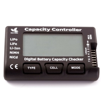

You absolutely need to invest a few quid in one of these cell testers -
They're so cheap, and so much safer to use than a multimeter. They'll also tell you the individual cell voltage and % level, down to 3 decimal points (which is overkill, but nice!)
Many of my LiPo's have been stored at 3.4v per cell (because I always used to think this was correct) but Google reckons 3.8 or 3.85v. Now that I have a fancy charger with 'storage' mode, I will address all my LiPo's before retiring them to the ammunition case I store them in!

5 hours ago, Wooders28 said:
Didn't even know those existed!!
This is what I use.Ā
Not only it shows cell voltage, it also acts as a discharge (slow), USB charger (discharge the lipo faster), servo tester and PWM tester.Ā
