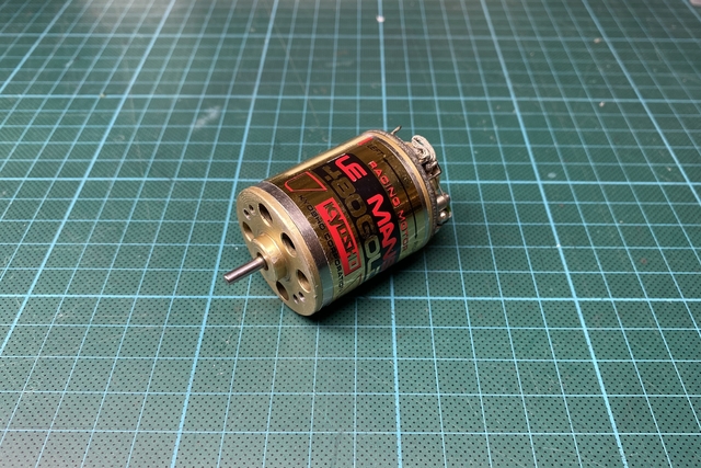

Yeah agreed buddy, who wants to mash up the underside of a nice carbon chassis or worse the lovely gold of the Turbo Optima!🤷
And that motor looks gorgeous mate, stunning!! Surely with that gold, it's got to go into a Turbo Optima!?😎
