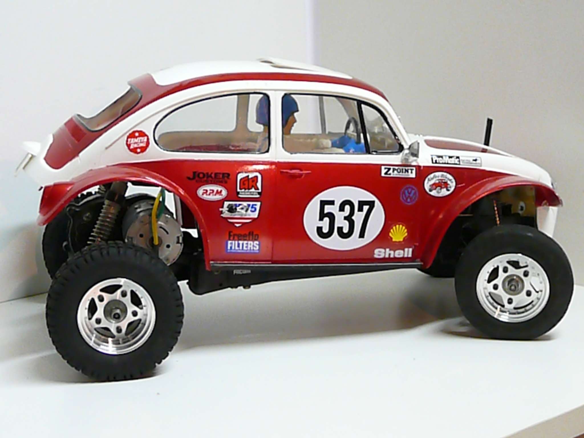

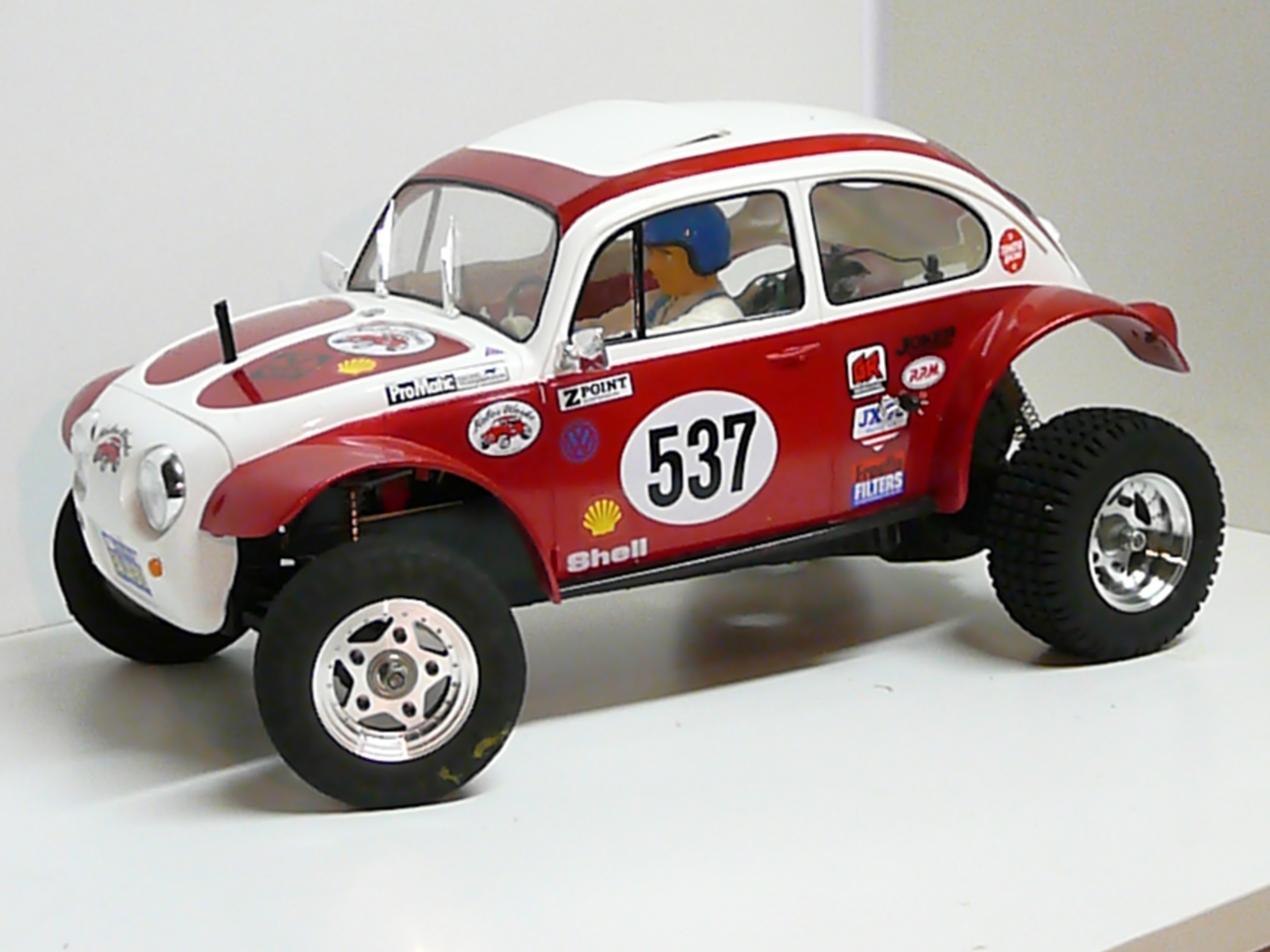

wheelbase doesn't look to far off from the original hornet, so a Sand Scorcher body will fit, but will sits a little high without some modifications to the front of the chassis. Hmm, I sense a potential future project for me!
with a little bit of cutting

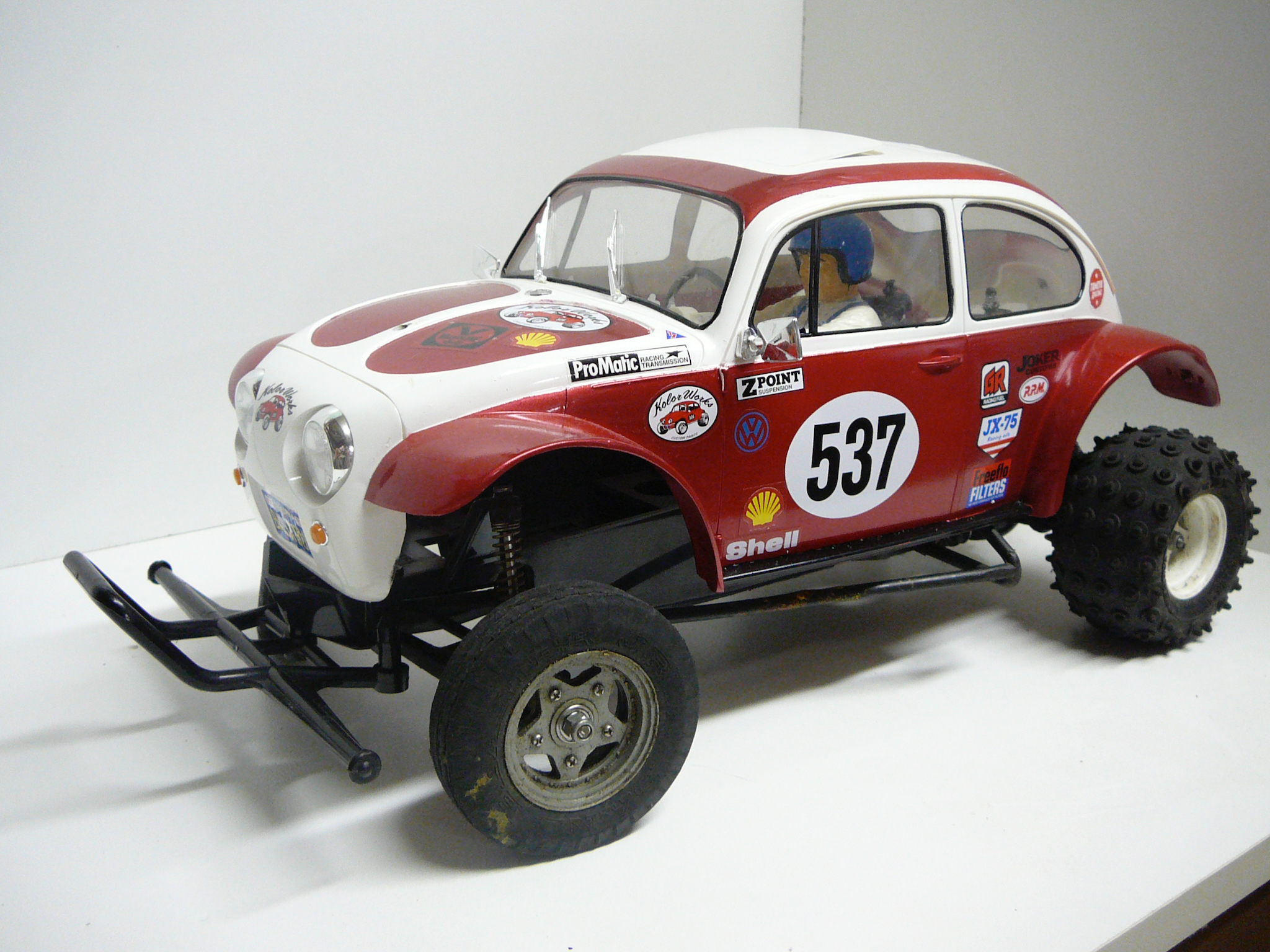

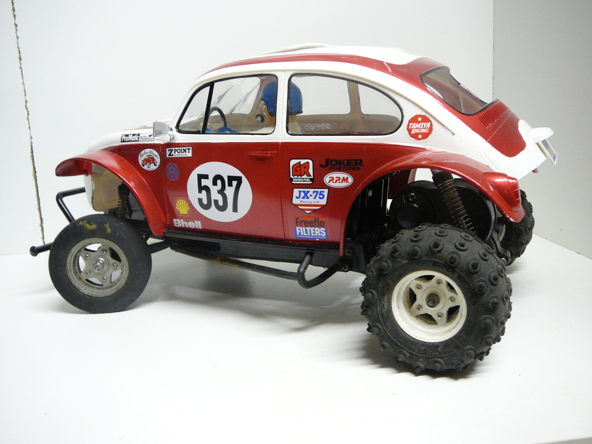

Whatever you can make fit with creativity that has a similar wheelbase. On one of my Grasshoppers I have a Parma beetle body on it and on one of my Hornets I have a Sand Scorcher body mounted to it. 20240917_161044.thumb.jpg.d87d1ebbc26cc0b59d60f7e4f86344c5.jpg20240917_160643.thumb.jpg.7d08b82c63e81aa174034e8b567b7b4e.jpg20240917_160829.thumb.jpg.a155af620a558807610111202c443605.jpg20240922_160336.thumb.jpg.86583212d019b4db25578c9f6381081a.jpg20240926_125111.thumb.jpg.2eedf2150de0345fe45d503145c16d9b.jpg

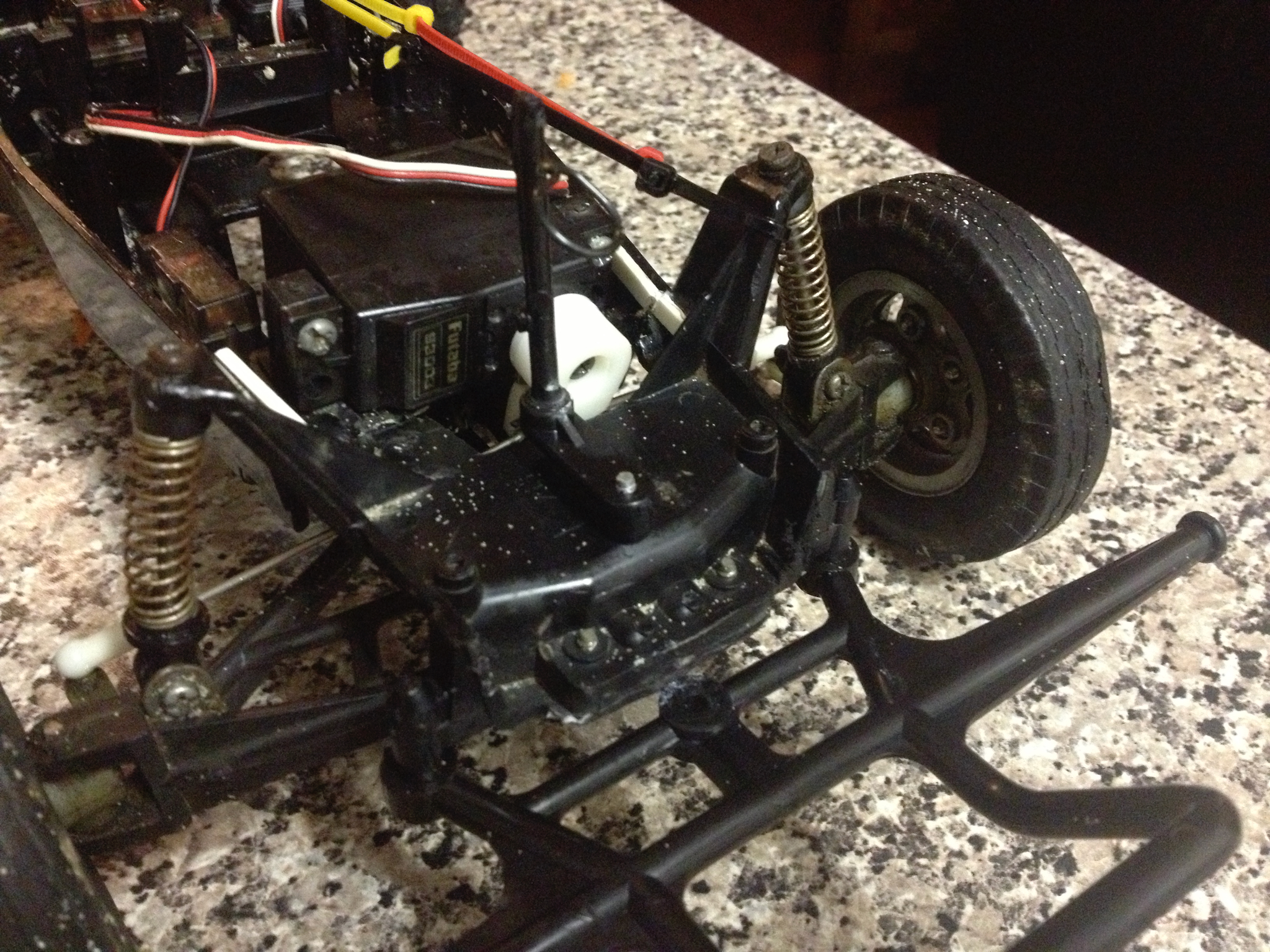

fitting the hard Sand Scorcher body may require cutting the front of the chassis for clearance, like @yogi-bear and I did.
