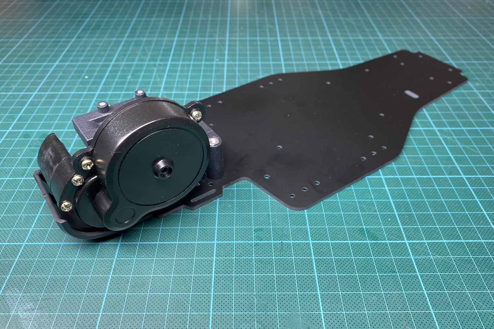

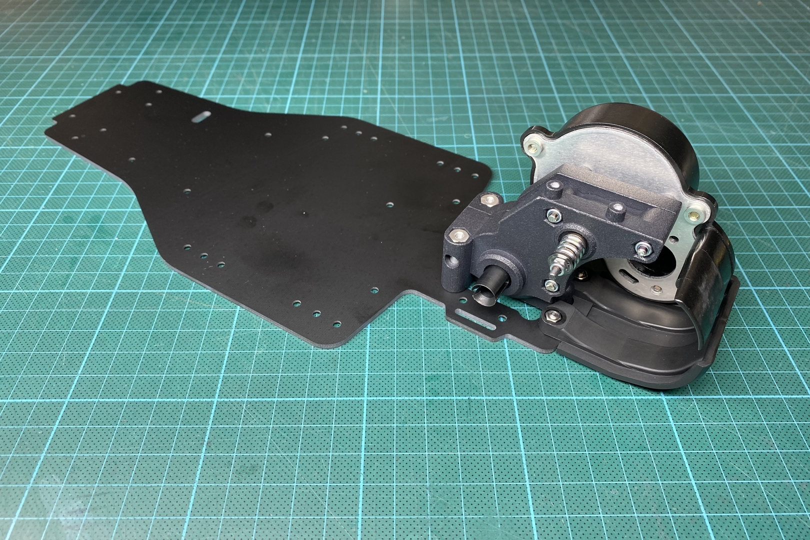

Applause for going with NOS diff housings. I wanted to do the same with my Monster Racer or Madcap to see what al the fuss was about. But ultimately I yielded and  I went with @Sgt.Speirs TRF201 Transmission Conversion in the Monster Racer and @Muso31 planetary diff in the Madcap...
@Muso31 parts can still be found on Ebay (gear diff and alloy diff housings).
Yes, Muso's parts are wonderful. We spoke at great length during the development process of those parts and he offered to send me some parts to try out but shipping across the pond was prohibitive as always.
