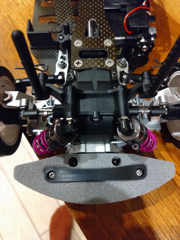

Almost finished the chassis for the Ford GT.   The blue bits on this one are all after market and I have to say, I got lucky with all of them.    I disassemble the shocks and reassembled them with green slime and the proper amount of shock oil.   Seem very smooth and the rear ones were on there for several days and no leaking.   The center shaft and cups all fit well and run smooth.   The steering linkage is the one that surprised me the most.  A few reviews said they had as much slop as the stock set but the set got seem as tight as the Tamiya brand ones in on of my other TT02s.  Only thing I need to do it get the balls to move a little smoother on the outboard links.  I have a trick that we used to do with ball links on the RC planes that will smooth them right up.
Snapped these photos for this upload but cannot seem to capture the green.  The brightness drops out when uploaded...

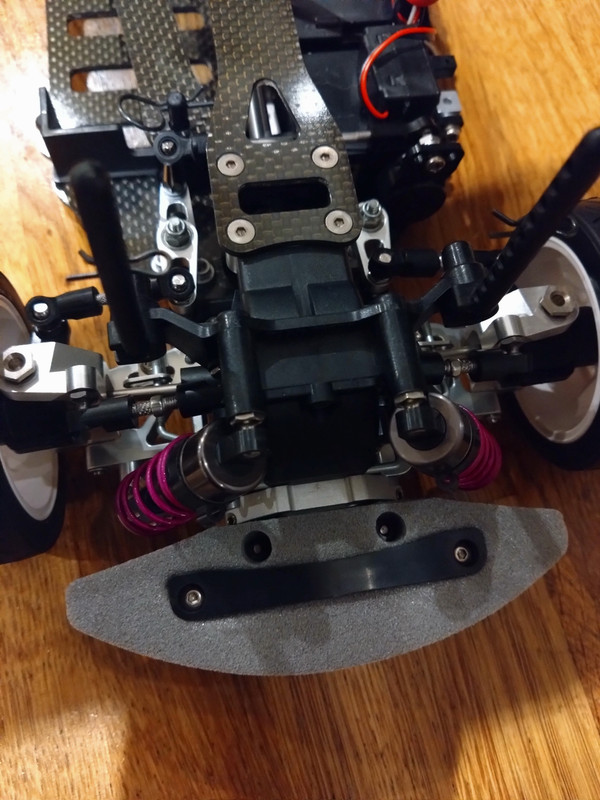

I made a bumper for the QD LB.
Found a piece of plastic at work, happened to be the exact grey to match the front bumper.
Cut to size and drilled with a recess cut out for the wheelie bar wheel.
Front.
Rear.
Looks cool with the all black grill and dark grey bumpers.
Torn between adding some livery and keeping plain.

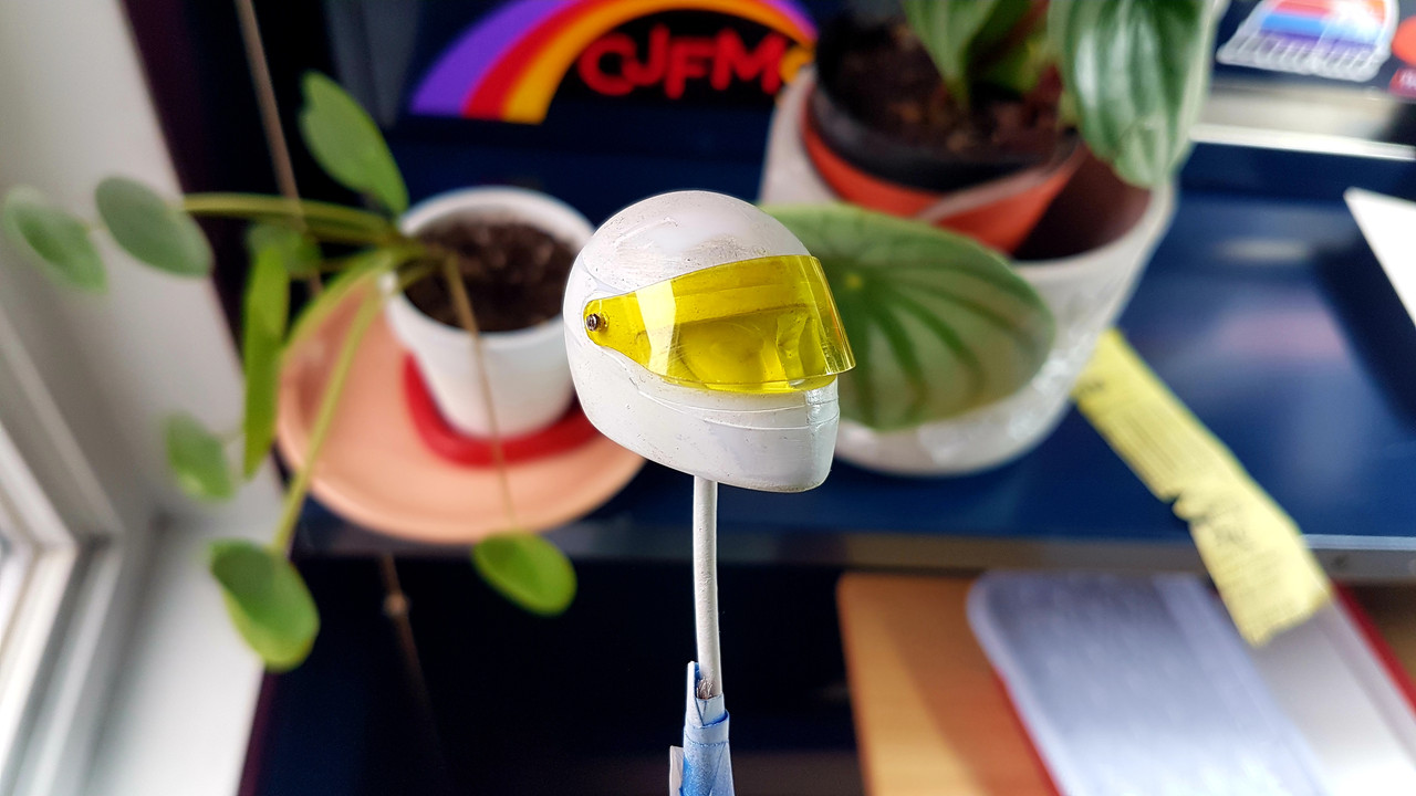

I got a head start -pun intended, again- on the helmet for the TO driver. I love driver figures, love working on them and seeing them come to life. Nothing compares to the ever-vintage feeling of the Tamiya ones IMHO, but I'll try to give this Kyosho guy some character and soften his aggressive looking face a little. I assembled, filed and primed the head. First coat and wet sanded it. Also, I thought I'd make a visor this time.
Despite it being my first try, I found it easy enough. I used and old decal sheet as a stencil to draw the shape on a water bottle, then cut and filed it.
Drilled some tiny holes on the side, just big enough for glasses screws and... voila!
Pretty stoked with the result, I think I'm gonna have to do this on all of my drivers at some point. Bonus feature, the visor is not fixed, it can move up and down like the real thing!
I took everything off for the painting, but I can't wait to see it done now that I got a glimpse of it.
Still figuring out the colors for both suit/gloves and helmet. I'm probably going to stick to the black and gold scheme, but will likely add some odd colors accents, as I don't want it to look too cookie cutter once on the buggy.

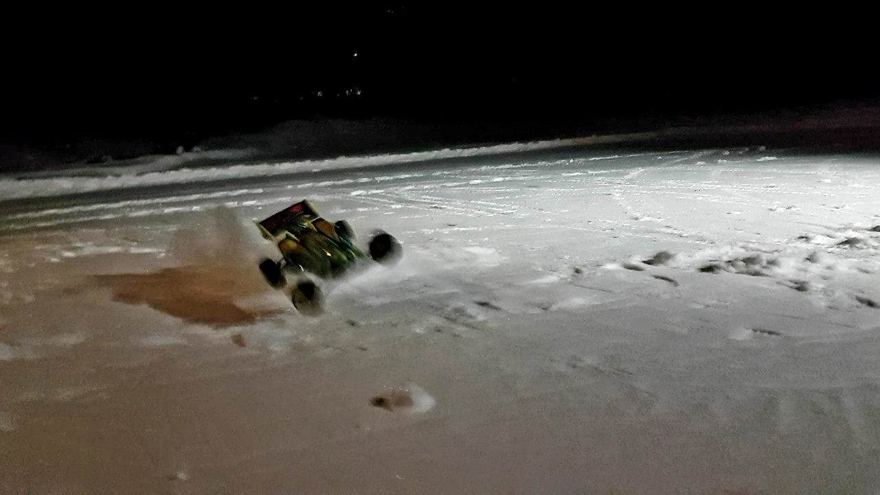

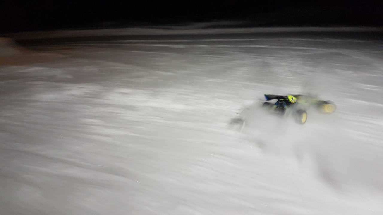

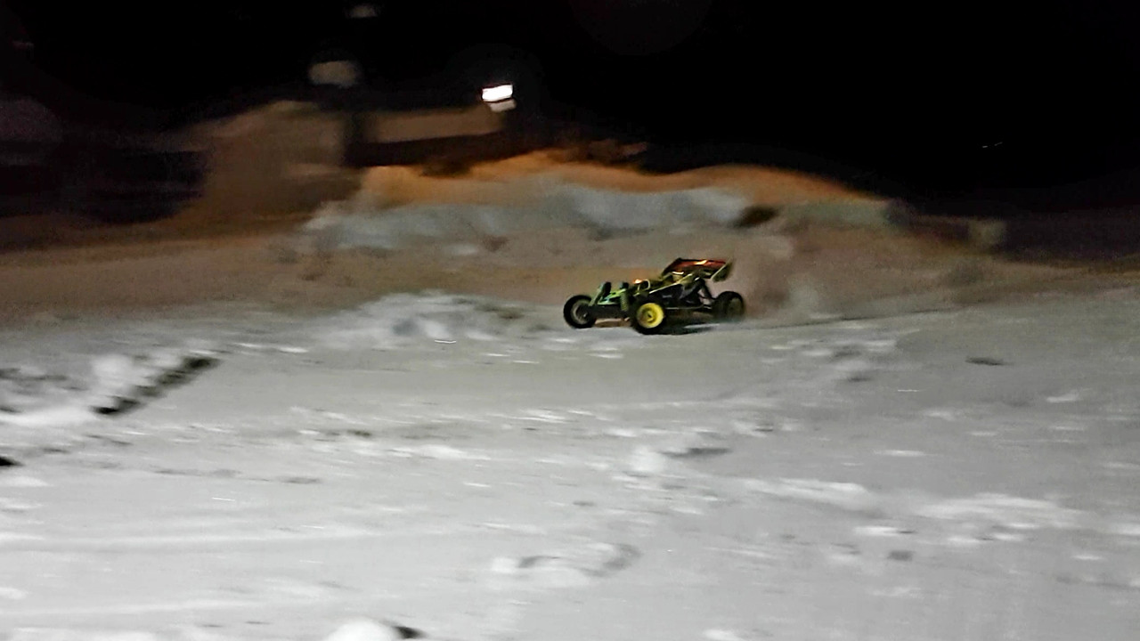

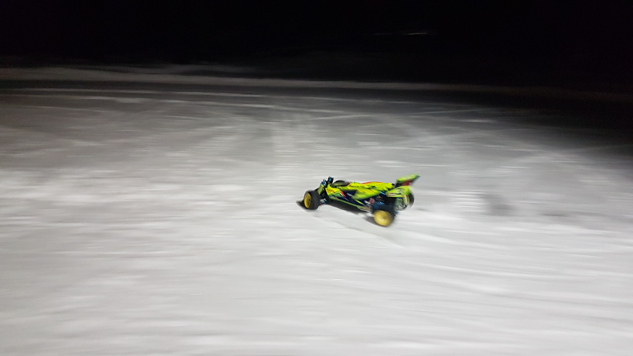

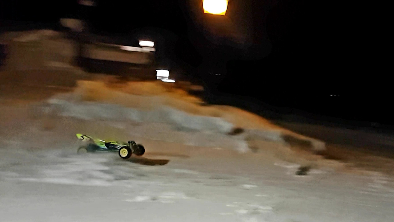

On another note, we left the city this afternoon for the first time since early December. By the time we reached the destination it was pitch black, but I remember installing some decent outdoors lights last fall, and in fact I was still able to run a car for a little bit (too cold to stay outside for more than one battery pack).
I chose the Manta Ray, as I wanted a test drive after carrying out some massive work on it, following the tumbling accident of last month. It drives and jumps very well, the handling feels good and I'm overall happy with it. Only thing, it sounds like there's a bunch of angry witches screeching inside the gearbox when hitting full throttle from a standstill. That 13.5 used-to-be-sensored bluebottle does take a toll on the DF-01 gearbox... and I guess those gears are quite worn out. I think I can live with that for the time being though, as it does run great nonetheless.

Wow — I really like the visor, so cool!
