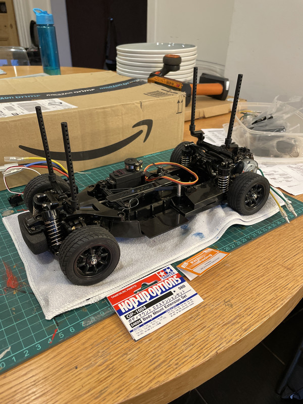

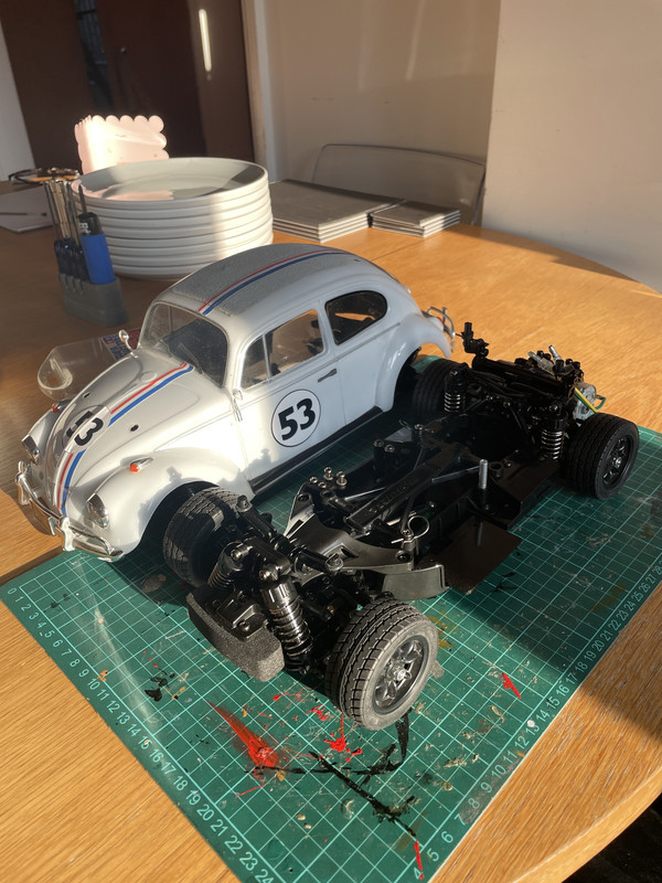

Small amount of progress this morning, battery stops, and tyres now correctly fitted , rear body posts flipped round.
Herbie body shell delivered by @Busdriveryesterday - traded for a couple of pints of Guinness 😂
Electrics next and I’ll order some body posts.

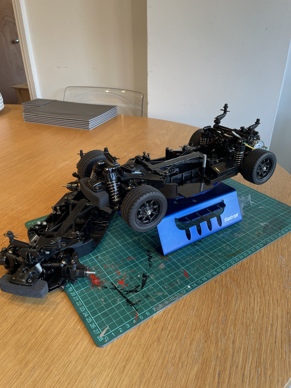

I’ve picked this back up and expect to finish before starting anything else 😉
RW steel pinion, servo, servo saver and ESC out my spares, body mount extensions new from (TTP).
