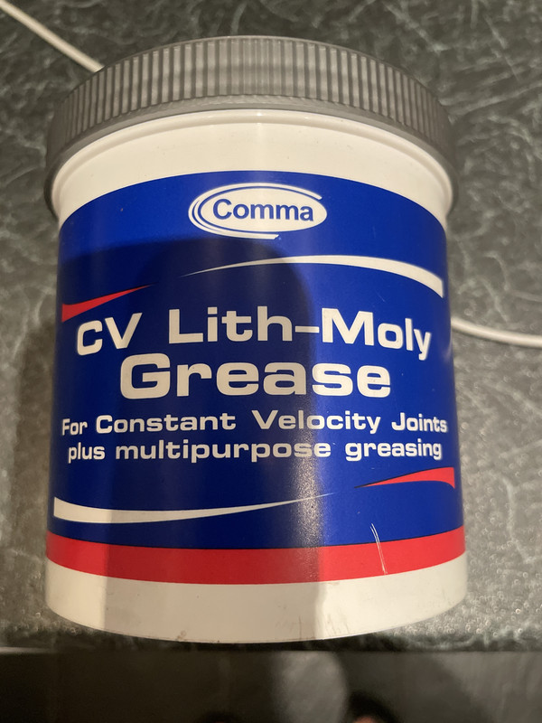

On 4/12/2025 at 3:13 PM, alvinlwh said:
£5 or so. Last forever.
This is good stuff. I ordered some on Saturday after seeing this, good call sir.
