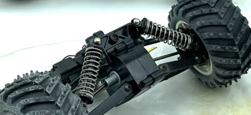

In this weeks works on the Dictator, I measure almost the entirety of the Dictator chassis tub.
The Dictator platform consists of four main elements; the body, the chassis and two gearboxes. Each gearbox fits its suspension independently, then the gearbox is mounted to its respective end of the chassis. The body is then mounted to bosses on the upper cover on the chassis and a boss on the front gearbox.
As covered by the previous posts, the entirety of the molded front suspension is complete in CAD, and all but one part of the rear suspension is complete. My next focus is the chassis, which contains the following fixtures:

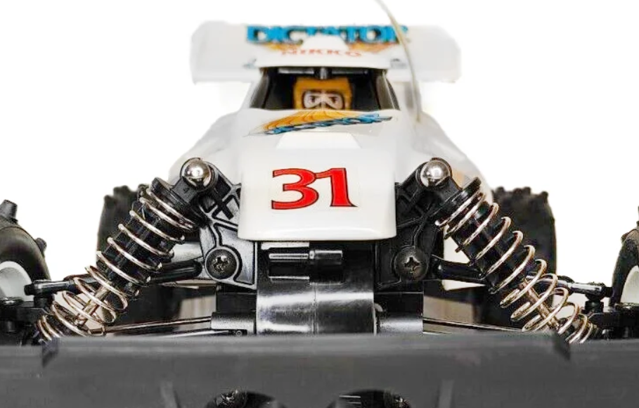

I would definitely be interested in some shock towers and suspension arms as I have a plethora of Dictator family vehicles.
There are subtle changes between different "generations" of dictator, and the design was subtly evolved with some changes for the better but others resulting in a "dumbed down" and simplified  car with some cost cutting measures, but they all have a lot of potential.
The mk1/mk2 style inc  is the best in terms of quality and had better quality metal cups and dog bones etc, metal ball joints on the upper links and so on.
Later models had larger wheels, bumpers and bodies and altered gearboxes with chunkier gears and 390 motors but lost the hardened drive cups etc and no more ball joints. Some plastics were more flexible and seemed to have stood up better vs mk1 and mk2 style which are prone to cracking like old tamiya stuff (Super dictator and similar)
The most recent variant had bigger wheels again and once more, altered gearboxes with a shock absorbing mechanism built into the spur gear (years before MST and Traxxas etc) but still 390 motors (unlike the Hawg/Thor truck family which saw a jump to 540 size)
I'm currently working on a Bobcat 99 which is one of the later versions and had 390 motors instead of 380 but I have swapped these for 540s. It required some alternations to the stock gearbox cases but not as much as would be required on the 380 motor models where the motor is recessed into the gearbox.

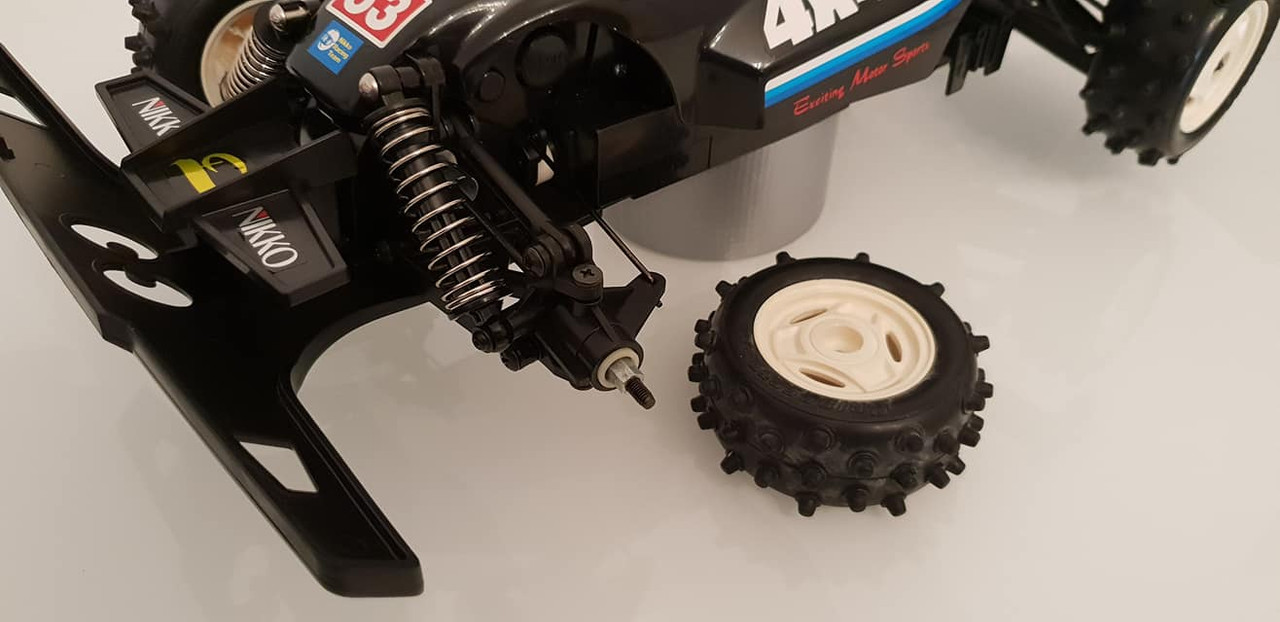

On 5/14/2025 at 4:49 AM, Freizeitprojekte said:
As far as I'm aware, the wheels are unique to the Phantom though.
Some later models of the Mk2 Dictator had the same wheels and hexes (even though the packaging showed the regular Dictator wheels). I believe they were mostly found in Europe. I think this is the only exception, though.

Something I noticed is that some of the mk1 and mk2 have a slightly higher and wider front shock tower whereas later models have a lower and more narrow one, and the shocks are more "laid down"
