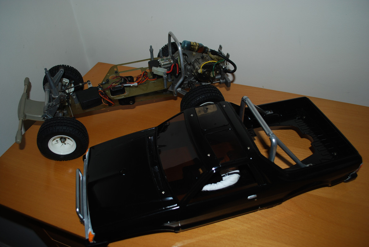

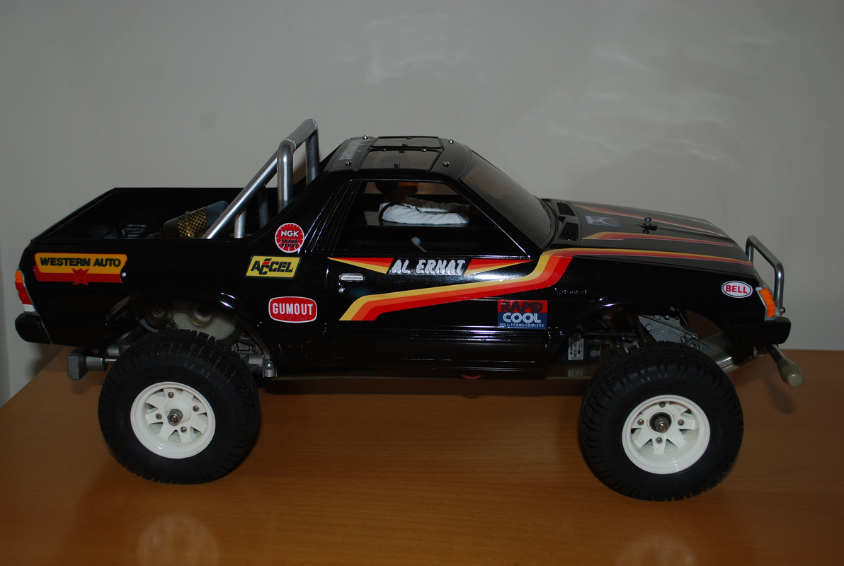

I didn't use a rear cage or the stock reservoir/damper set-up but I didn't need to trim the body.
I’ve admired this many times @Saito2, in my mind it combines the best combination of 2 models.

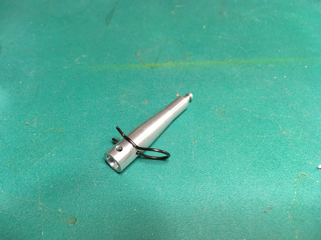

A while ago I made a hybrid that could take either a Super Champ or Scorcher body. It had a Scorcher gearbox and roll bar but a Fighting buggy chassis and front end. I had an aluminium post cut that sat over the shorter FB one and clipped on with a body clip.

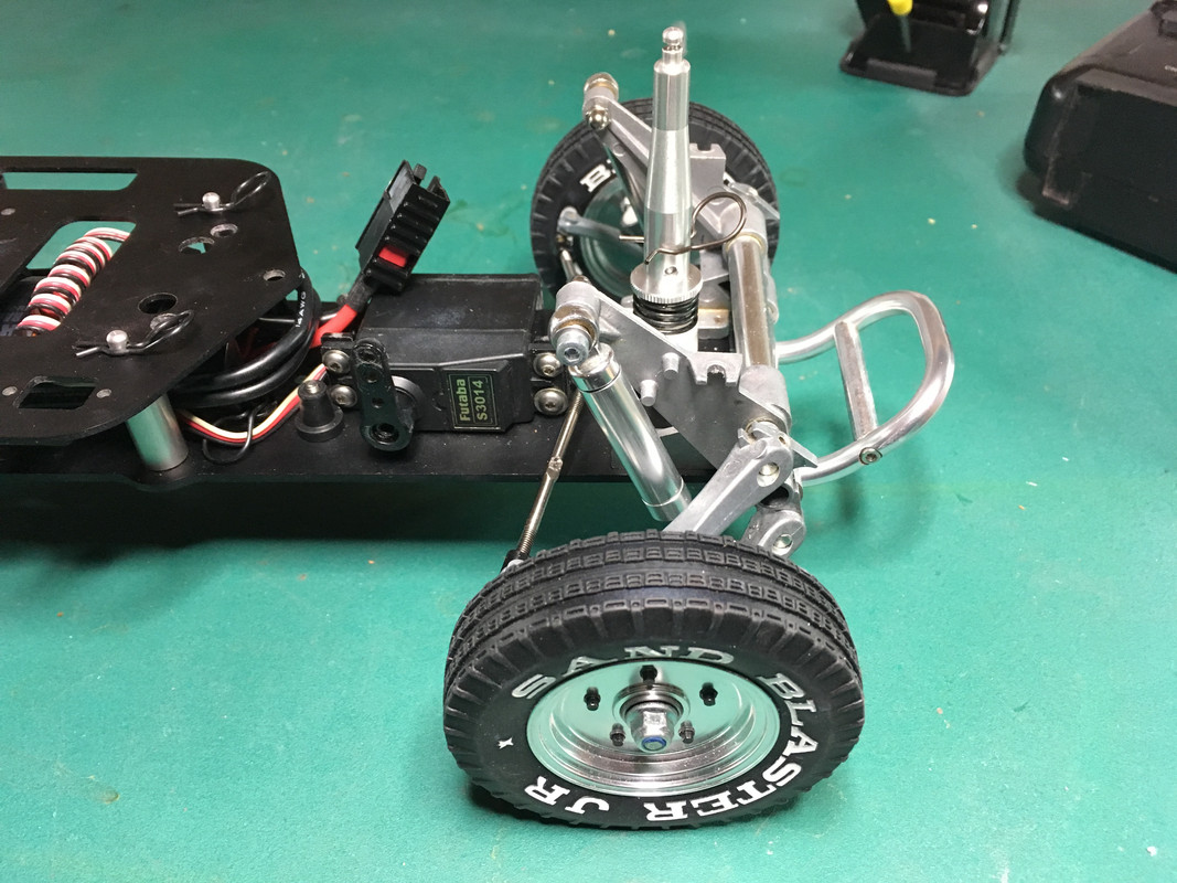

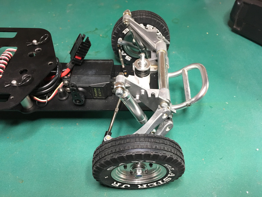

I wondered if the Vintage SS front body post would fit on a Fighting Buggy post like it did on the OJ Buggy Champ to take a SS body, so I tried it on mine, yes it sort of fitted but the SS body sat higher up by about 10-12mm
So I’m wondering if it’s easier to fit a SC rear end onto a SS chassis, like the one @toyolien linked to as it has the SS servo saver and body post on the front end and also the right size rear mount roll bar?
I don’t know what front body post @Saito2 has on his?

Ive not done it with a Sand Scorcher, but i did the Subaru Brat conversion. I found that the original Sand scorcher body pin, was a tight interference fit on top of the Super Champ mount, so i pressed it on. I didnt need to fix it in any other way.
