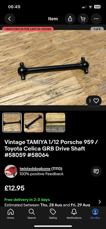

Driveshafts have arrived!!
20250826_105849
Just a new steel pinion to arrive (and a single 620 bearing, think I've lost one somewhere...🤦‍♂️), and that 'should' be everything to get running....🤞
