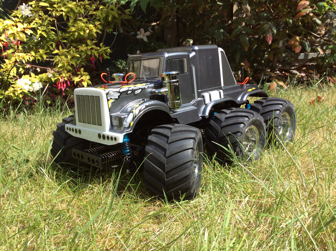

I've recently acquired a Konghead. It's running a 10.5 turn brushless motor and I'm really quite impressed by it. The car/truck also has the alloy servo brace fitted with an uprated Sepktrum servo. I have noticed that at times the seering doesn't self centre. A wiggle of the steering wheel soon sorts that issue out. Has anyone noticed this on their Konghead?
I'd like to alter the boxart to a Bigfoot livery. It'll definitely need a flag.

Might be worth checking for grit on the ball joints of the steering mechanism. There is a naturally a little play in the steering and my Konghead and GF01 dump truck have both had a bit of grit in one of the steering ball joints and it causes the steering to settle slightly one side or the other within that zone of play rather than inherently tracking straight.
I've had similar in other vehicles too, such as my Thunder Dragon, different mechanism but same cause (sand or grit getting in the wrong place)
