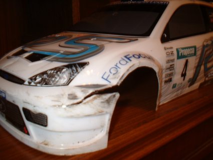

what i also learnt today was not to drive straight into concrete walls, cause it kinda breaks your bodyshell... [8)][xx(]
lol nevermind, spose it looks more like a rally car now [:D]

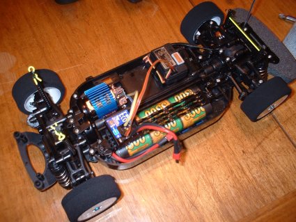

Here's a pic of my tl-01 and there you can see the motor that came with it and there is one soldered between the poles:
That might be your problem.
Read your ESC's manual... as a minimum, they recommend 3 caps.
Get 100uF poly ones and solder them
1) between +ve and the can
2) between -ve and the can
3) between +ve and -ve
Also tie down & tidy up your wiring.
Leaving those long loops of motor wire flapping around in the air
is just asking for trouble, as they act as antennas radiating the
high freq switching from your ESC.
No wonder your poor RX has trouble finding your TX's signal
amongst all that stray RF energy it is flooded with.

About the wiring, that's not how it is while i use the car....hehe. My ESC sits on the bottom of the chassis and the wires tugged down and i use rubber bands to keep it in order. It was just like that on the pic because i was moving things around while working on the car. [:I]

Might be an idea:
1) sit the ESC on top of the chassis, give it some cooling air.
2) don't bunch the motor wires together with servo & antenna wires.
