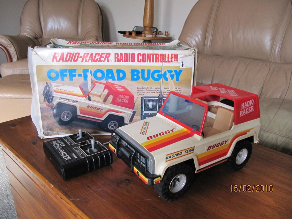

I was at the local markets with my family last week, and I stumbled across this , box is really a mess but I just set it up with new battery's and it was scooting all around the house, all 3 speeds works, steering is good and the
tyres aren't cracked or perished, not bad for a 35 year old.
For those interested I paid $30 aust, or approx. 14 quid

This car of mine was sold new by David Jones for $99.50, it still has the original price sticker , I am guessing around 1980 ?
Interesting - what you have is definitely the original Taiyo Off-Road Buggy (not co-branded with anything else). And I knew David Jones department stores sold R/C cars in the 1980s, as I remember seeing a few there in the mid 80s. But never knew they sold this particular one, as yeah - it would have been in around 1980. It's amazing how much Australian department stores have changed.
Great find. If you have the patience, I'd be getting some PVA glue and gently fixing the box tears, to get the box nice and square. (if it's ok with you, I might even need this photo for my website at some stage, as a sample pic of the original release of this model ^_^).
In the past, I have seen this model sell on eBay for over $200. In mint condition, they are sometimes quite sought after.

I've got exactly the buggy that Snappy1 posted in February (photo above). It's in the same good condition (the box even better:)), but I've got one problem: While forth and back works fine the steering doesn't work at all. I disassembled the steering: In the buggy there's a box with two electric motors and they doesn't move at all when I want to steer (sometimes there's a short reaction of the drive axle instead). There's no obvious error. Does anyone have an idea what to do? Should I change any component on the board? Did I miss anything? I'd be very grateful for any help. Thank you.
