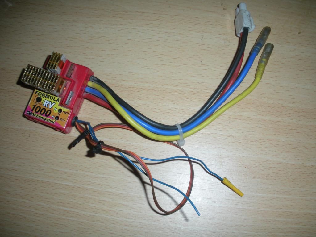

Can you post a photo of the ESC..
I cant help but wonder if they are made by Mtroniks....
here you go:

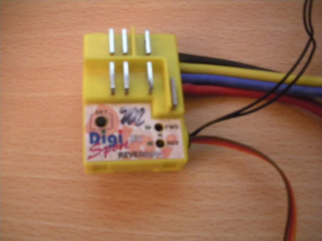

Just remembered I have an old Mtroincs digi Sport RV Reverse, and it does look suspiciously similar!
I have no idea what the turn limit of this bad boy is either, email sent :)
Ah, no wonder the poor thing was struggling with the OP's two 19t motors! When running twin motors in parallel, one needs to have an ESC rated for half the motors' turn count. So he would have had to use a 9t-capable ESC. The RV1000 would have struggled even on 27t silver cans - 30t crawler motors would have suited it better.
